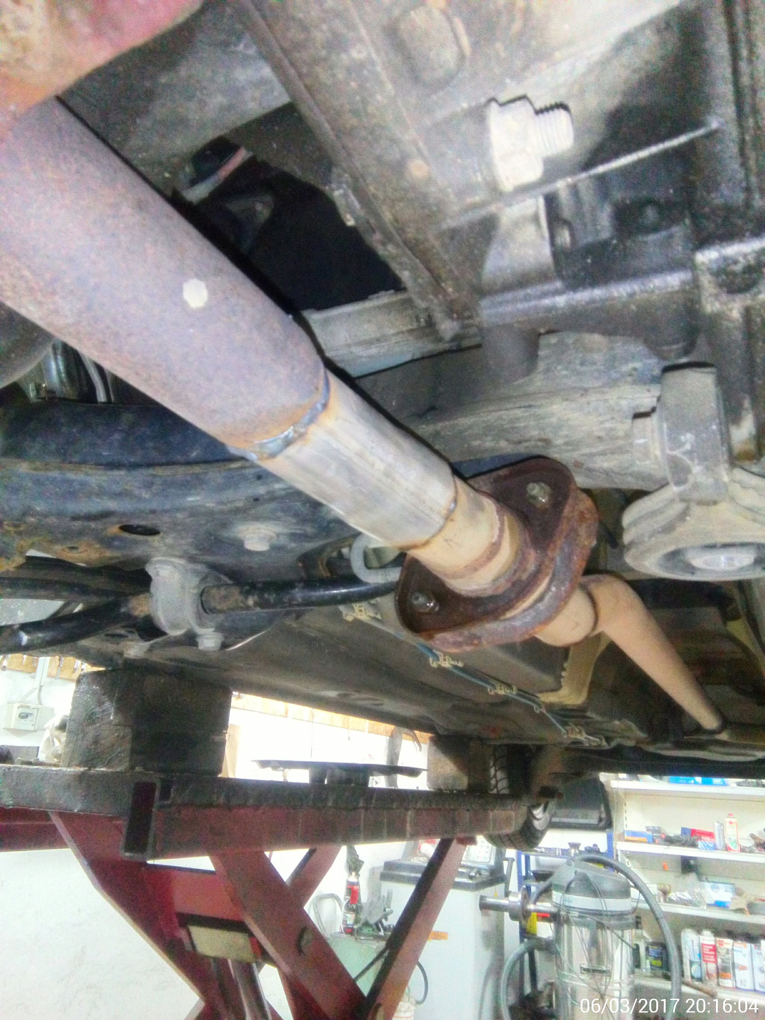

who needs flexi
saw this on a punto 2 weeks ago
attachment.php
attachment.php
