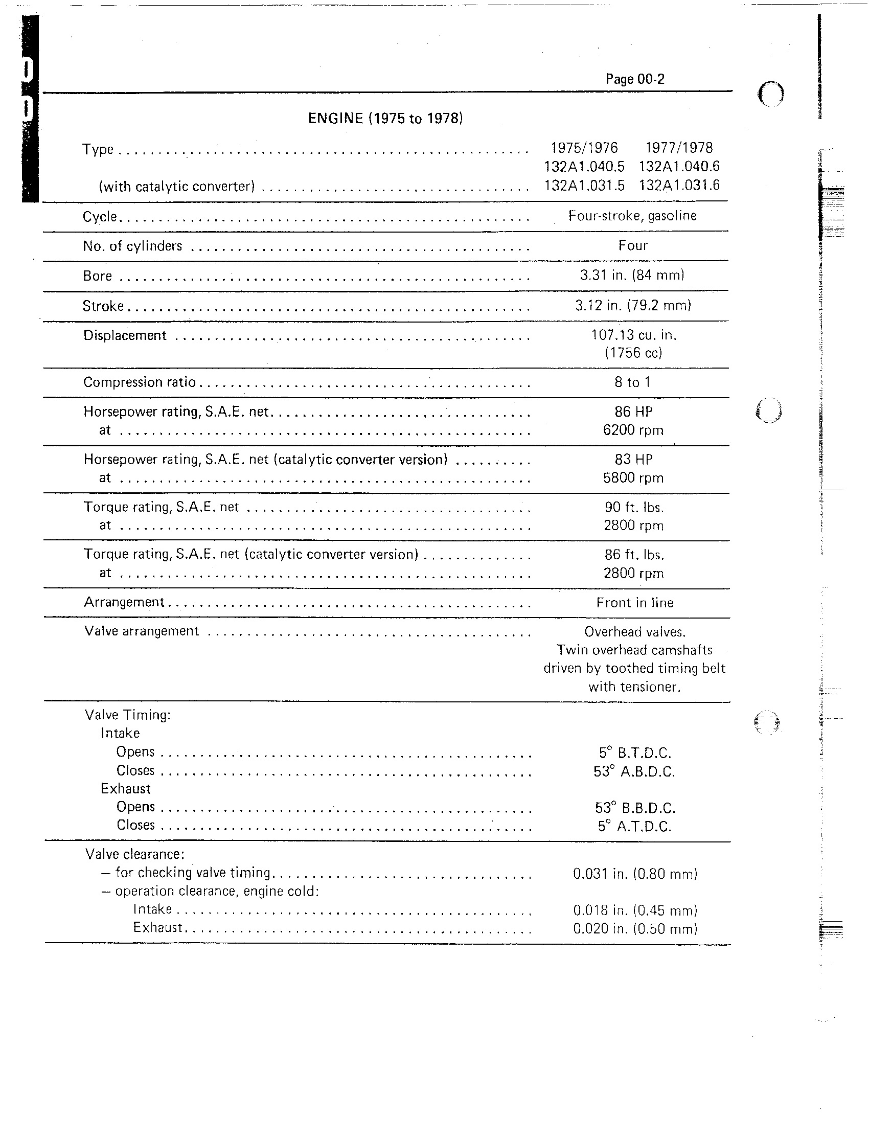

My '76 owner's manual says the compression ratio of my 132 A1 040.6 is 8:1. Wiki says the 132 A1 040 engine has 8.9:1. Do you, or anyone, know where to find factory info on all the engine configurations?

According to the Fiat Spider workshop manual, it's 8:1

European spec 132 series engines (1592 & 1756cc) had a 9.8:1 C.R.
and the valve timing figures were I/O 26*btdc I/C 66*abdc
E/O 66*bbdc E/C 26*atdc
Valve lift was 0.3824 inches (c. 9.7mm)
Valve sizes were Inlet: 1.629 ins (c.41.4mm)
Exhaust: 1.417 ins (c. 36.0mm).
Power outputs were 104 hp for the 1600 and 114 hp for the 1800 engines.
The above details are from the Haynes Owner's Workshop Manual for the Fiat 124 Sport and Spider. I suspect these specs are accurate for the Sport (Coupe) model but might not be for the Spider model sold in Europe. I don't have a Fiat 124 Spider manual so Davren's figures could very well be more trustworthy.
Imho, Wiki is good but not infallible - often one figure/spec will be given for a particular model but there may have been changes during that models lifetime.
Contemporary magazine Road Tests put the figures at 108 bhp for the 1600 engine and 118 bhp for the 1800. I'm never sure who to believe... Even dynamometer tests can throw up different figures depending on variables such as barometric pressure, ambient temperature etc.
