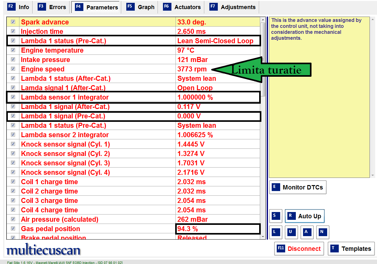

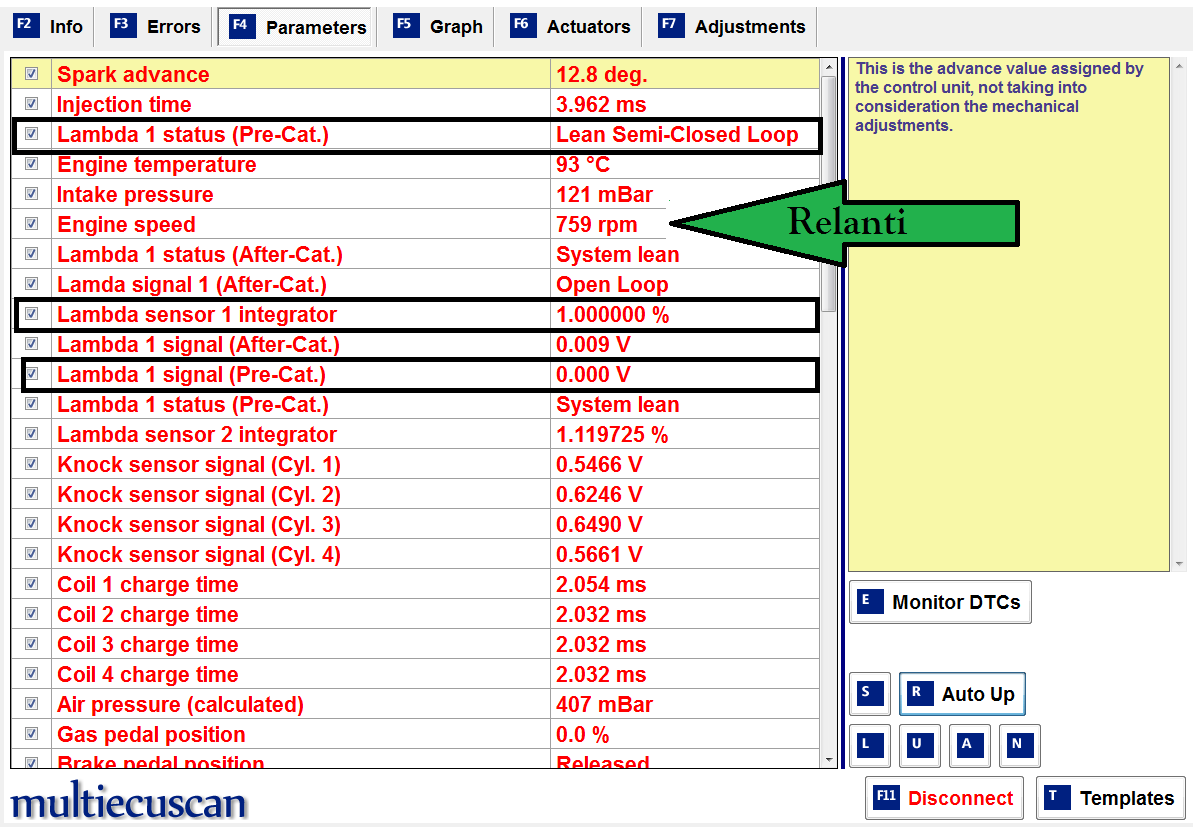

My car is Stilo 1.6 16v 2002 and have some problems.
The engine is not running ok and revs. are limited to 3700 rot/min.
Errors:
P0105 - amospheric pressure sensor
P0340 - camshaft position sensor
P1222 - potentiometer pedal
And today P0135 - lambda pre-cat sensor
Amospheric pressure sensor, camshaft position sensor, potentiometer pedal have been all changed, but no results. Brake switch too.
More than that ECU is new.
Errors are still here.
What can I do more?
