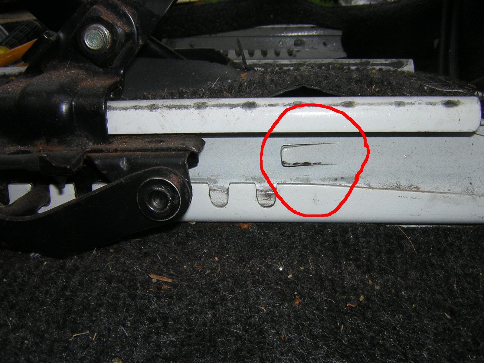

It's come to inspection time (re. welding on the 1000s) - and thinking I might be able to tackle it, started to take the front driver's seat out...
:eek:
I'm sure it's very easy when you know how... I must be missing something.
I can see a lug at the front in the runner on the inner sill but the other inside runner hasn't got one but still comes to a solid stop...
:confused:
May be a blonde moment, but I can't see any other bolts..?
Looked closer at it and the 2 lugs in the runners to the rear need tapping flat. If the seat's been taken out before there's no way to prise them up again by the looks of it. So if your seat comes out without it's probably been out before. The rear centre ash tray needs to come out too, then as you say it slides out backwards.

Cheers Craig,
Just checked other Panda and the lugs are up on that one.
Once the lugs are tapped back it slides out no probs.
Maybe the seat on yours had been out before...
They probably don't need to be bent up again as its more of an adjustment feature to prevent you from pushing the seat back too far (if driver has long legs maybe?)

I suppose if you did want to prevent it from going too far back you could drill a small hole in each lug and screw in a self tapper to help lever 'em back, but it's probably not really necessary. They may have had to fit them to meet regulations?

This be the offending lug that needs punching back to allow the seat to go far enough back for removal:-
Car's gone now - got seats out easily once I'd flattened the lug as illustrated.
With that lug down the seat slides out backwards easily.
If the lugs are still up on yours then there must be another way of doing it.
If lugs are level with rest of runner then your seat has most likely been out before I would think.
On my other Panda - the CLX - the lugs are still up.
