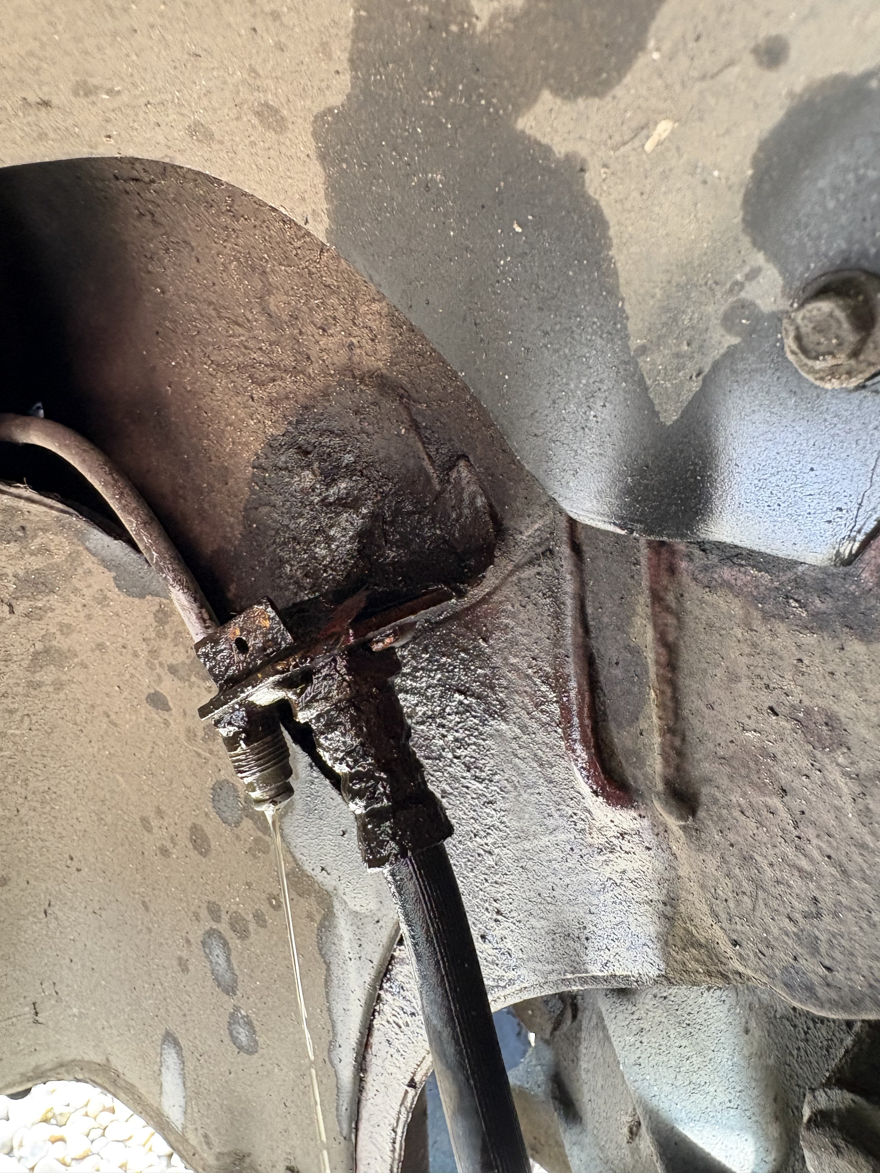

Hi all, I’m replacing my Panda’s front flexi hoses. I’ve separated the union between the flexi and hard line with no issues, which was nice, but now I can’t work out how to remove the clip that holds the flexi in place.
Is there a technique for this?

Grab hold of the part with a little hole in it with pliers and wiggle it out carefully, don't hit your elbow when it comes loose lol

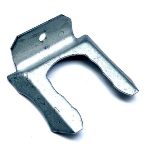

This is how it looks without all the corrosion:
The fiat part number is more than likely 994922
