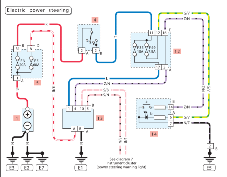

I have not regular question. I've installed steering column from Fiat Punto mk2 on my car (not Fiat) and connected EPS according to the diagram below.
And it doesn't work. I hear relay clicks only.
But I don't use wires from pins 5 and 10. Thit wires have signals ~2.3V and ~2.8V with ignition on and one of two have 12V when ignition off.
Can someone help me solve the problem?:worship:
