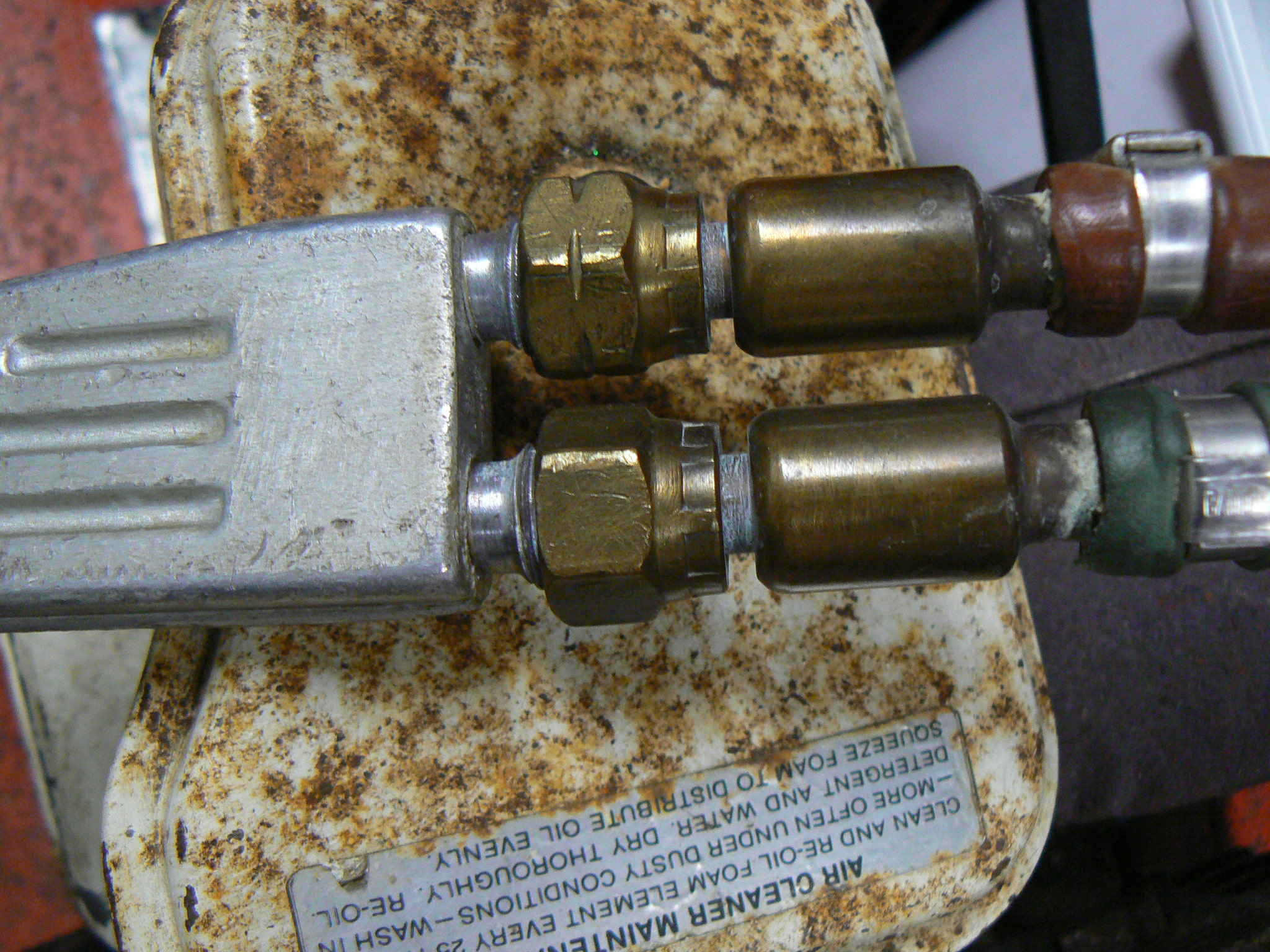

I just remembered what I have that definitely has this - my old oxy-acetylene gear:
The Acetylene (fuel) gas fittings are all left hand threads so you can't cross connect when assembling. They are all marked like this even the big cylinder connecting nuts on the regulators. The Oxygen ones are just plain (and right hand threads). So, I was lying when I said I've never noticed this before! However I wasn't thinking of gas connectors.
I don't keep the cylinders any more, ever since my insurer nearly had a stroke when he found out I had them in my garage! Probably a good thing as, looking at the condition of my hoses, I would probably need to renew them if I were to want to use the gear again.
