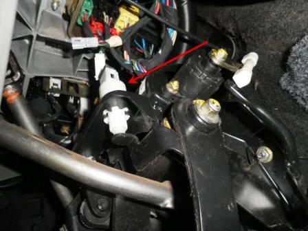

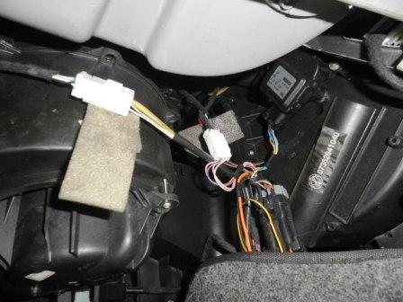

I did the one on the Accelerator pedal AND the one in passenjer footwell (which was just kind of hanging there not fixed to anything)
I pulled them appart, gave 'em a spray with WD, re-conected and took appart a few times (just to be sure) and that did the trick !

Just an addition to my previous post.
There were actually 2 connector blocks in passenger side, so i did both.
see photos:
Passenger side. / Driver side.

- good - glad your TPS send signal problem is sorted.
- sorry about the unrelated indicators - but that's cars for you :D
- thank's for putting the photo's up - everyone keeps asking for a photo !
