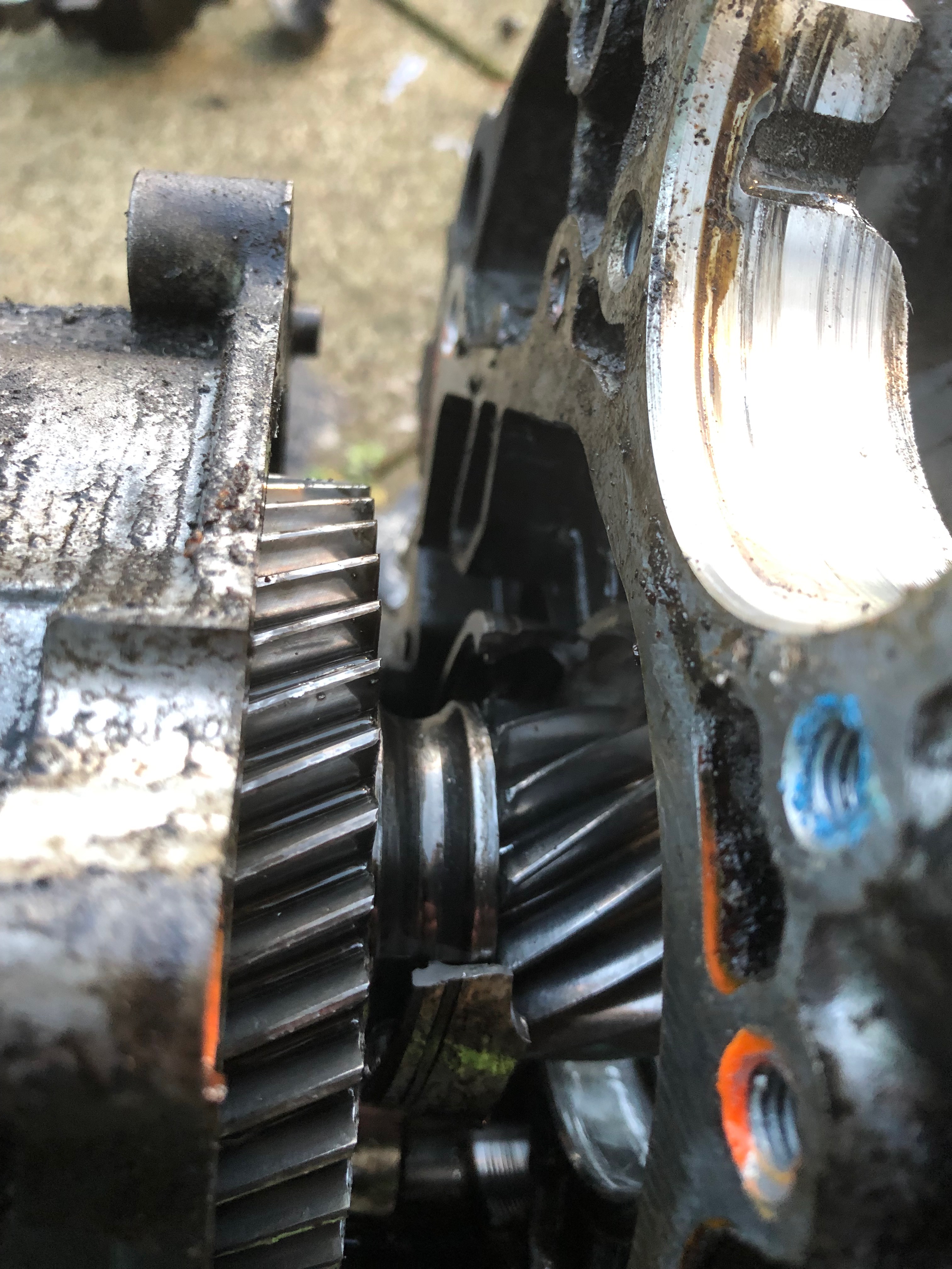

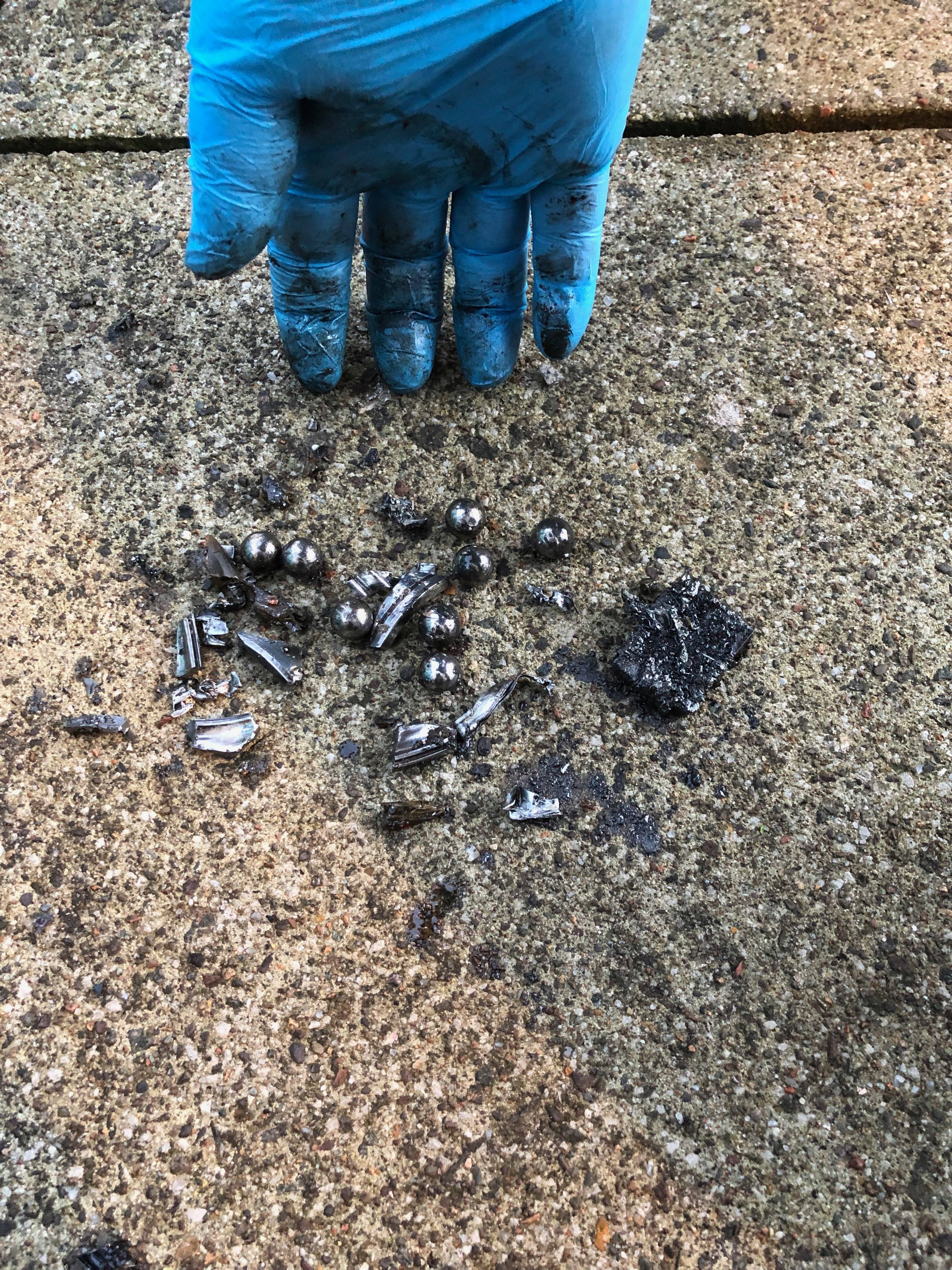

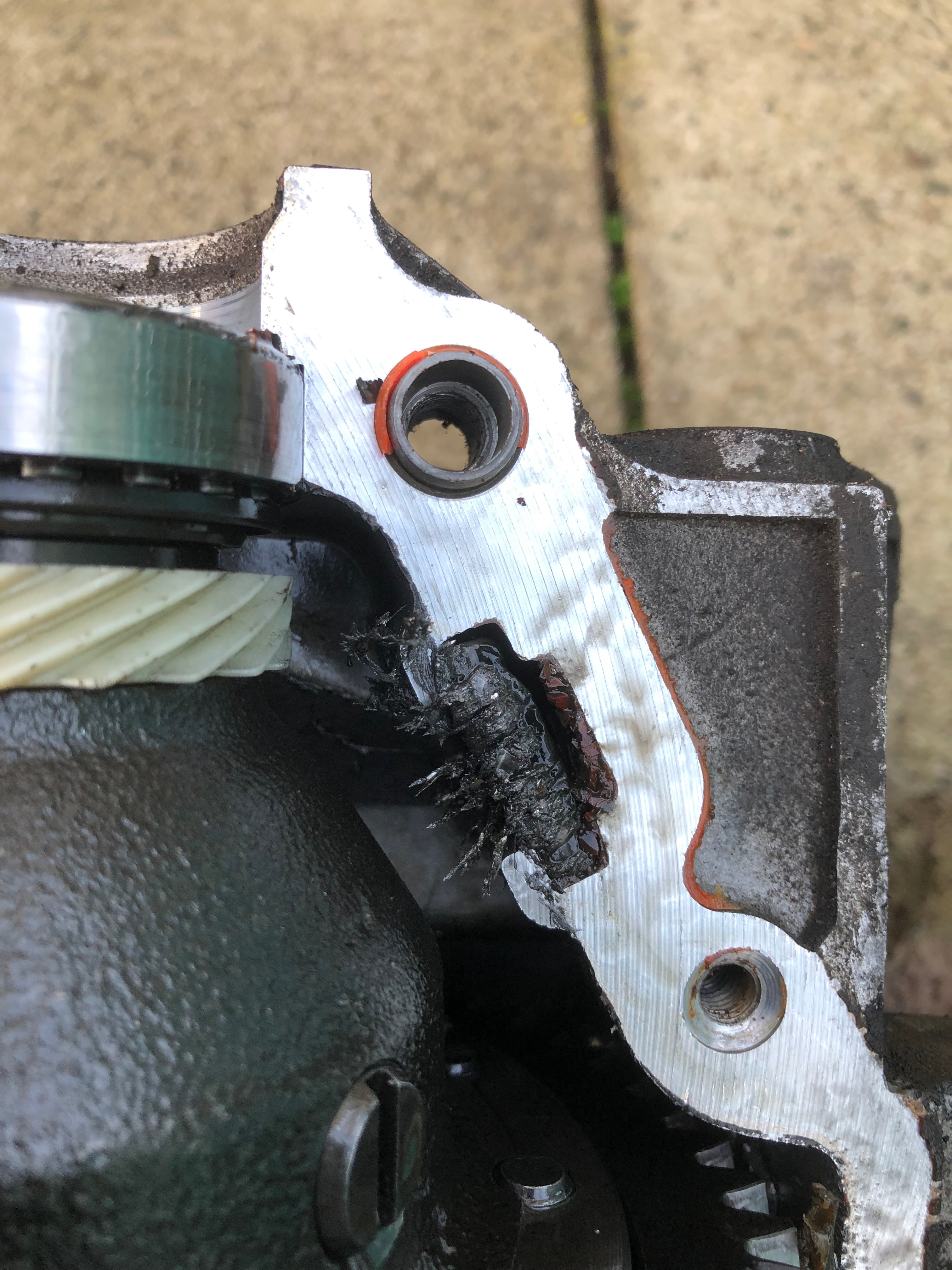

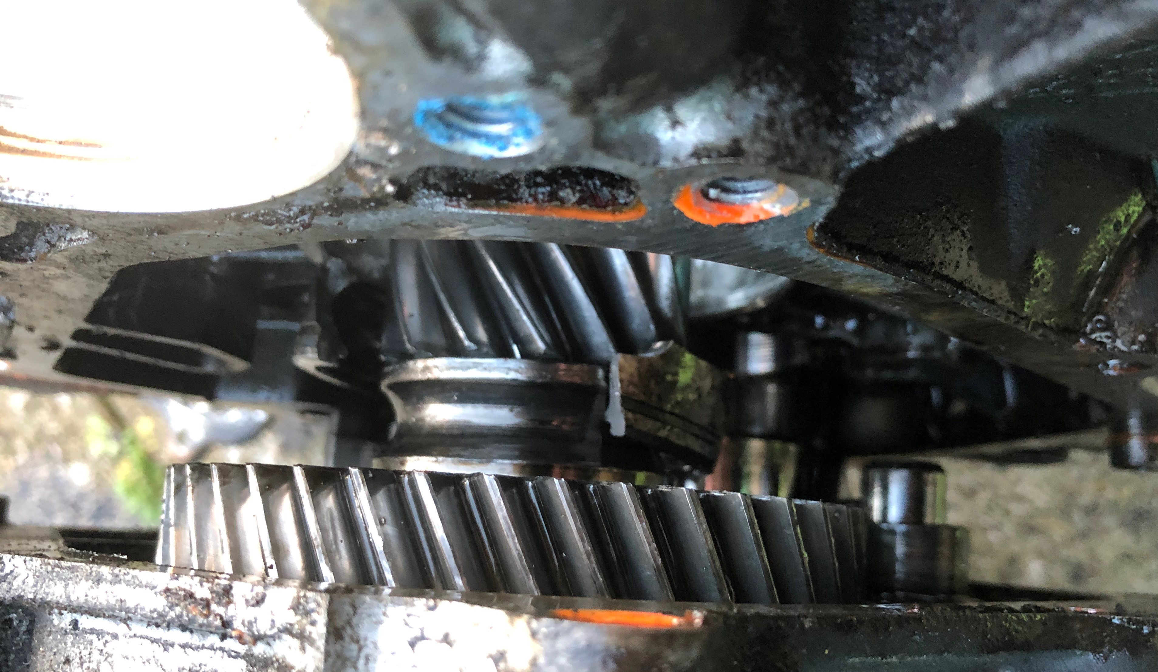

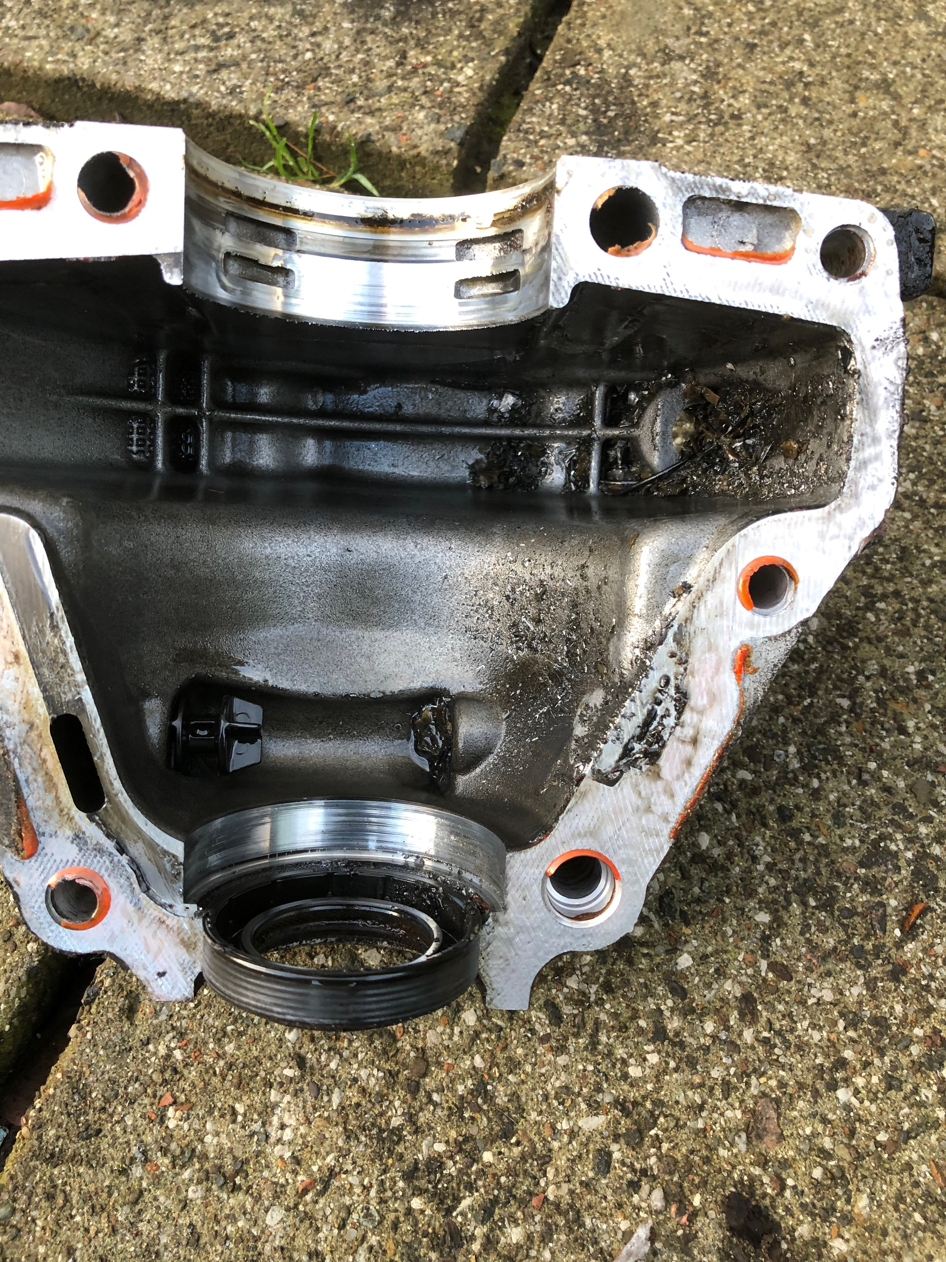

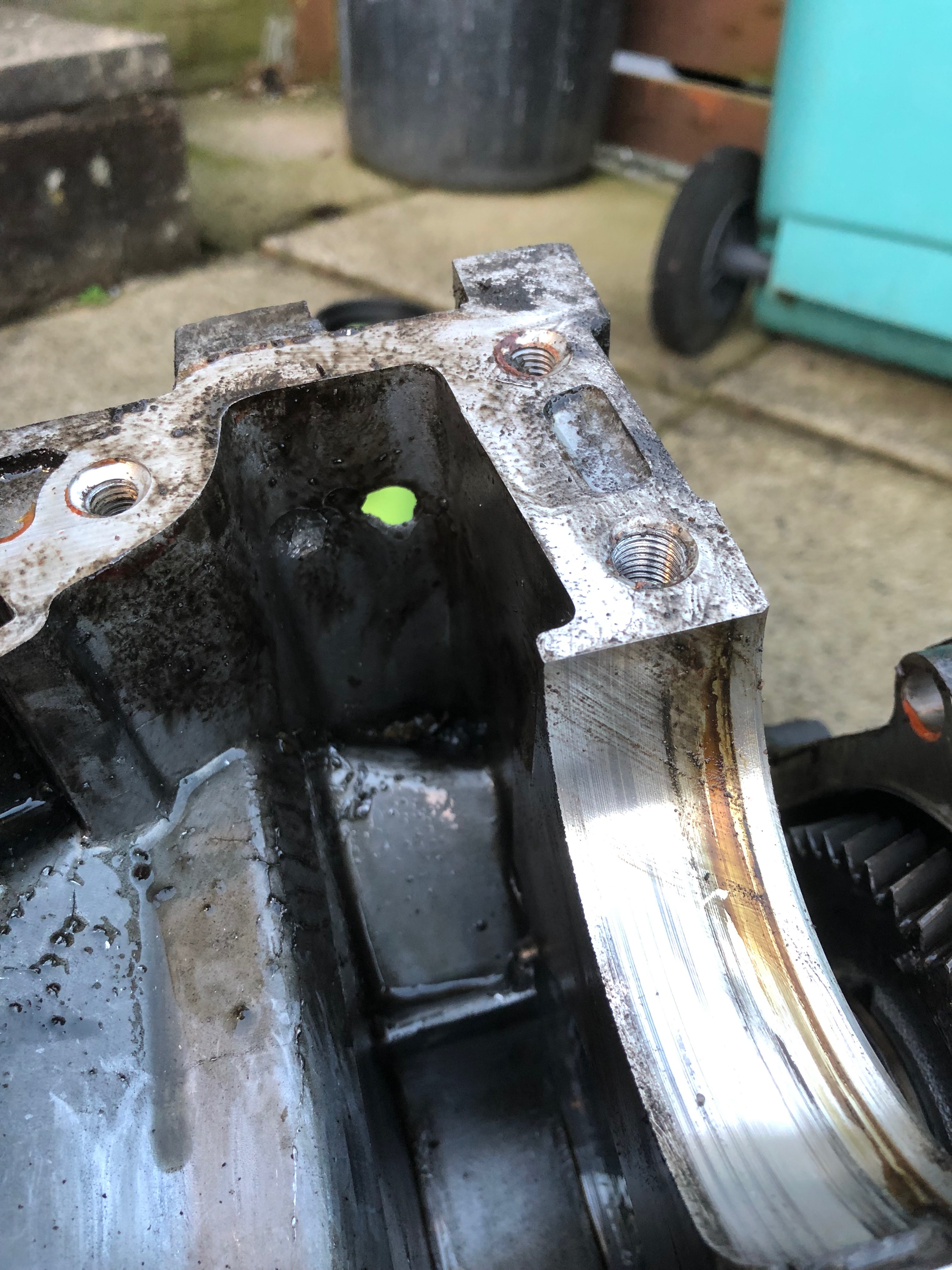

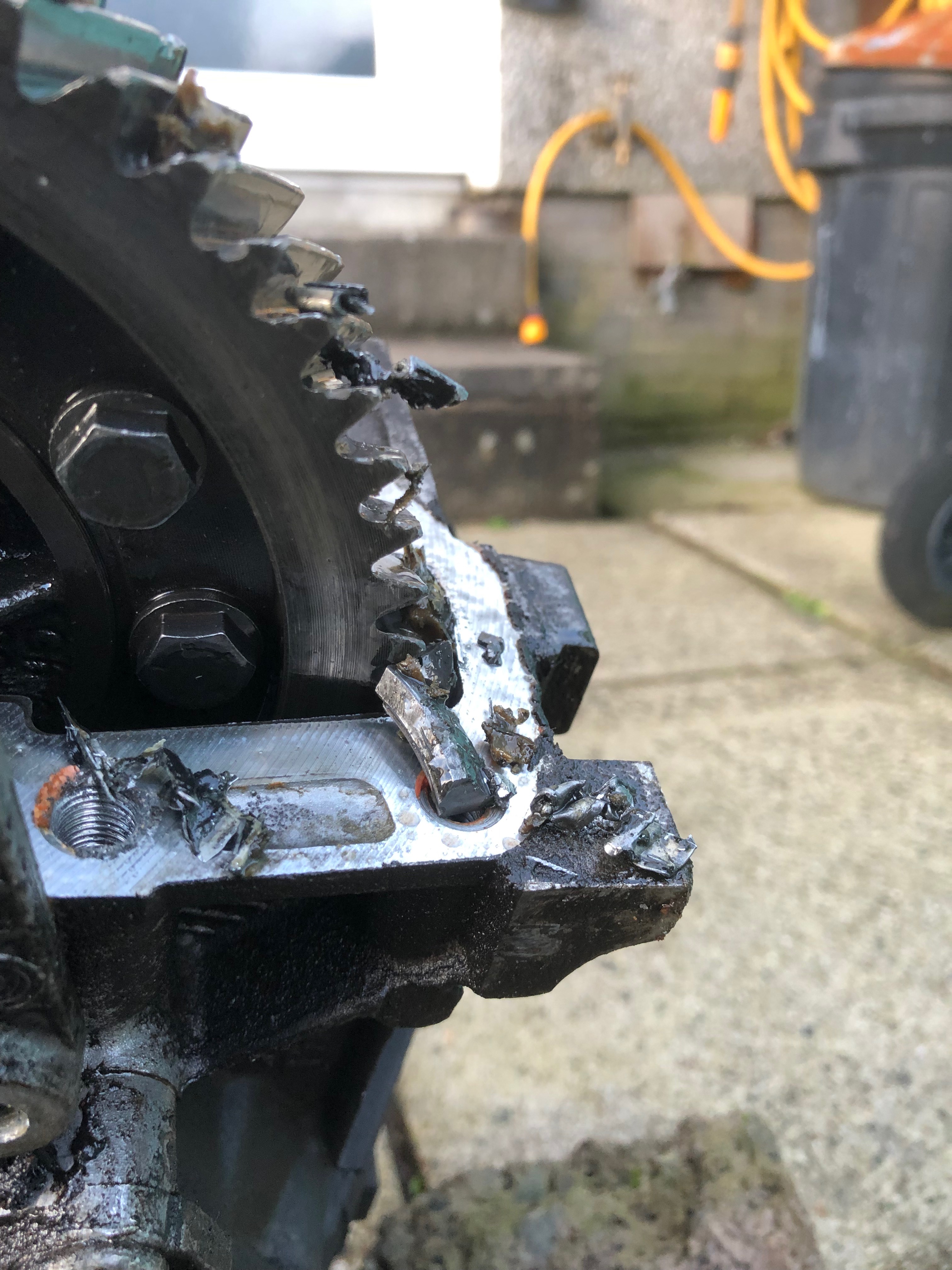

I've taken the damaged gearbox out and, as I said I would earlier, have stripped it down and taken pictures of the damage and the offending part.
Turned out to be the main shaft bearing that failed throwing lots of debris and ball bearings into the diff housing.
As you will see in one of the pictures it was one of these ball bearings that broke through the casing.
I hope this will help someone else diagnose their problems in the future, although I wouldn't wish it on anyone.
I managed to get a recon gearbox with a 1 year warranty from "The Punto Shop" in Oldham. ("oldhamfiatgearboxes" on eBay)
Thanks again for all the help and suggestions.(y)
Knowing my 18yr old son as I do, I'll no doubt be back asking for more advice again soon. :D

Hi guys,
Thanks so very much for posting those images shiny. As we've said earlier in this post, rebuilding a damaged box at home, apart from being a difficult task for the amateur/enthusiast - often needing specialist tools you don't have, is nearly always complicated by the fact that detritus enthusiastically distributes itself around the whole box. So merely replacing a worn bearing or a few other component parts without dismantling and thoroughly cleaning every component part and every wee hidey hole will often mean tears soon after reassembly!
Your box just illustrates this so well!
The bearing failure must have been sudden to be this catastrophic without giving audible warning. Maybe there was a metal fragment from elsewhere swimming around the box until it got into that bearing race and suddenly fractured it? You'll probably never know.
Keeping my fingers crossed for you that the "new" box is a good 'un. and thanks again for posting your results, it's so frustrating and we all learn much less if people don't complete their thread.

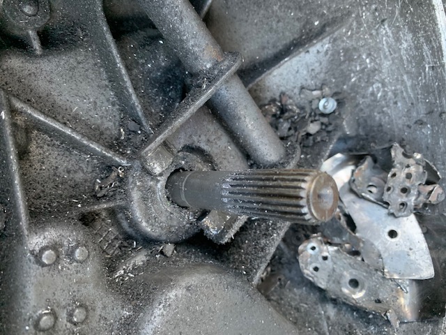

I've just replaced the gearbox in my sons car AGAIN!!!!
This time it was the shaft that the thrust bearing slides on that sheared off, cracked and seized the bearing onto the broken part of the shaft.
My son also thought it would be smart to get a mate to change his clutch when it started making noises even though I told him I'd replaced the clutch the last time. "18 Year olds know better."
Well, this new clutch decided to give up the ghost at the same time as the gearbox went so I don't know if the shaft was the cause of the problem or the clutch just made it worse.
I've just replaced the "old " clutch with the new gearbox and all's well again.
TILL THE NEXT TIME!! :hm:
