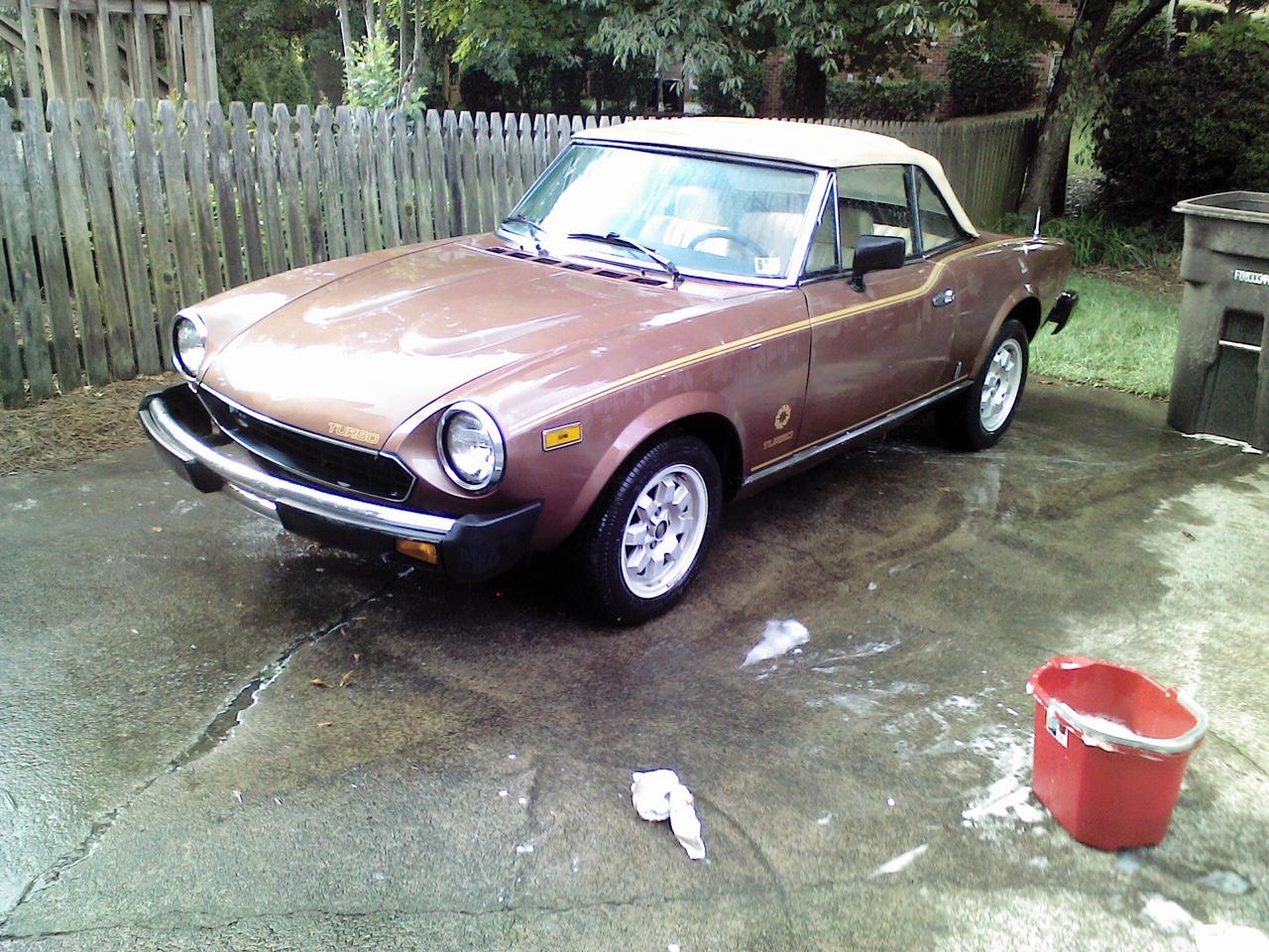

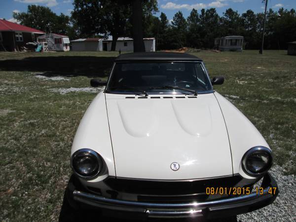

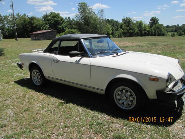

Thanks Guys As always very helpful and I will be following all of the suggestions. Attached a couple of pictures. The white one is my 1983 Pinnafarina. Owned it for seven years. Very original with 44000 miles and in super nice condition (my baby). The brown one is the 81 Turbo (no Turbo installed), I am restoring. Zero rust on both! Thanks again for the help! Oh I'm located in North Carolina so no MOT issues here.
