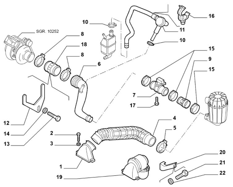

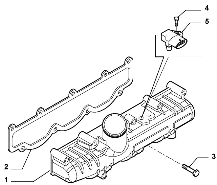

Hi All, Recently bought Ducato 2.3 multijet 2006, engine hunting on light throttle. scanned for codes, p0105 map sensor and p0103 MAF sensor, no lights on the dash, tick over ok smooth, driving light throttle it seems like engine hunting only when driving, Removed an engine tuning device fitted from PO, after this the throttle response much better, but still the same problem, anyone knows where these two sensors are located very much appreciated Thanks:)
Assuming the "up to" 2006 2.3, the following should give you a good idea (there are variations, but the locations are very similar).
MAP is "4" on the inlet manifold, MAF is "7" on the air cleaner ducting.
