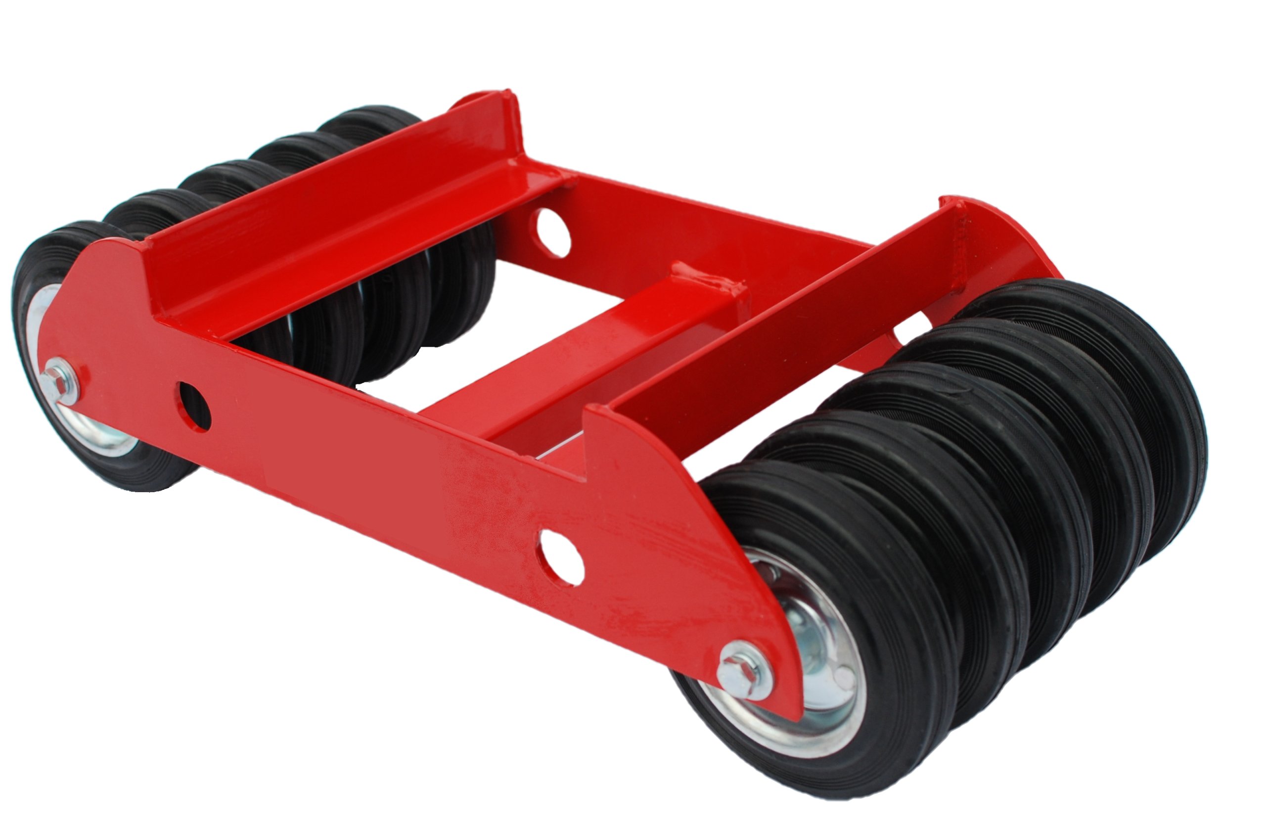

No idea about the UK, but in Poland tow trucks have a special trolley they put under a damaged wheel. It looks more or less like on the attached photo.
But as I understood, for the moment Booshy21 is not thinking about the towing truck, he wants to find a way to unlock the parking brake on his own.
