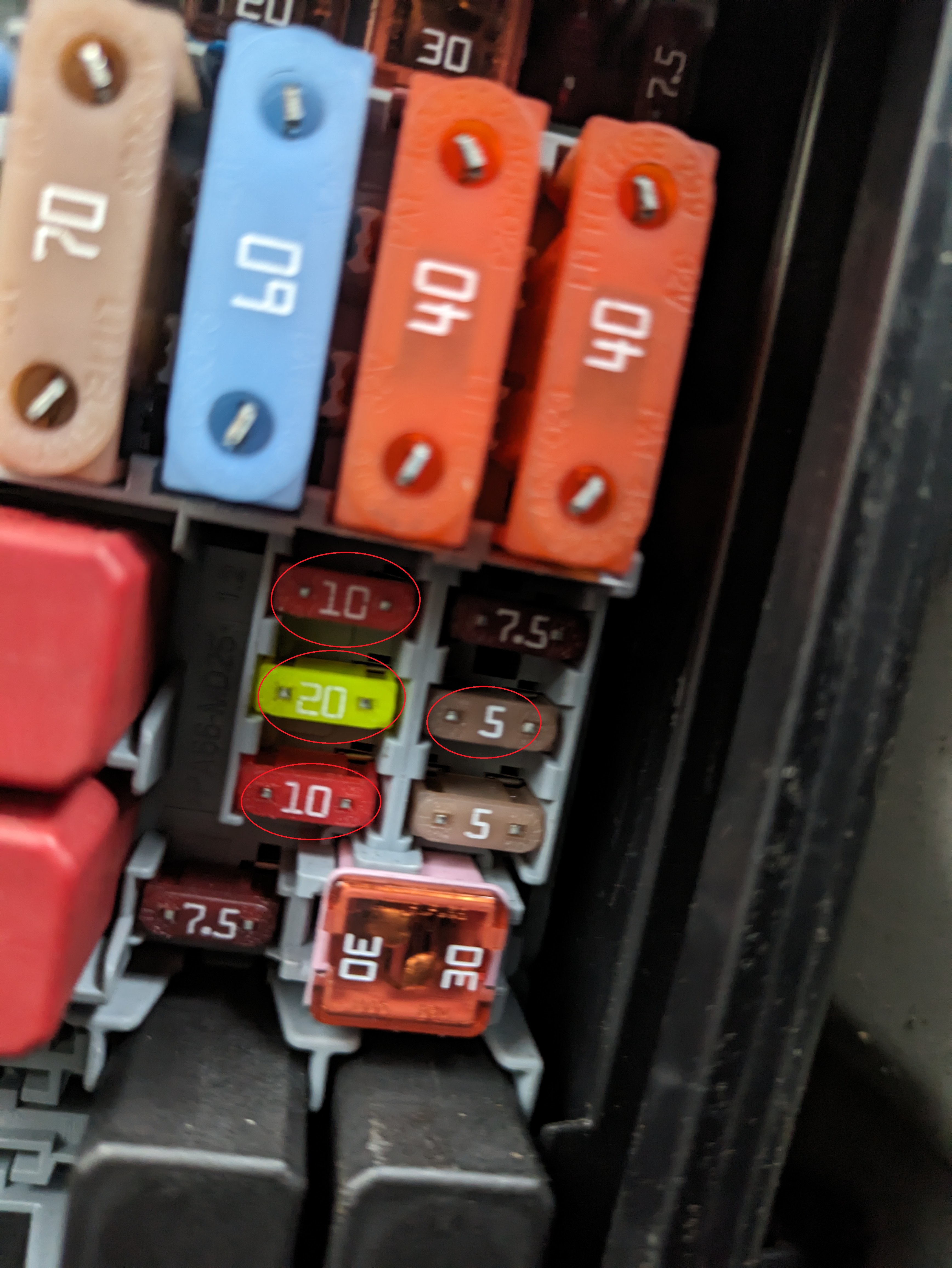

So I started going through the fuses looking for power at each one. This is where I found something strange. Most the fuses have a 12v supply with the battery connected except 4 of them. I have attached an image of the 4 that don't show any voltage. The odd thing is that if i remove the main negative terminal those fuses then show 12v? Maybe this is normal behaviour? I cant find any information online to say whether it is or not.

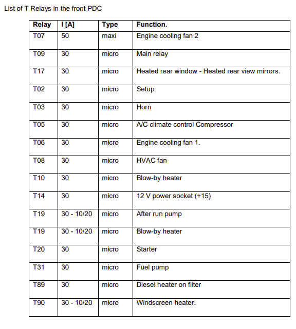

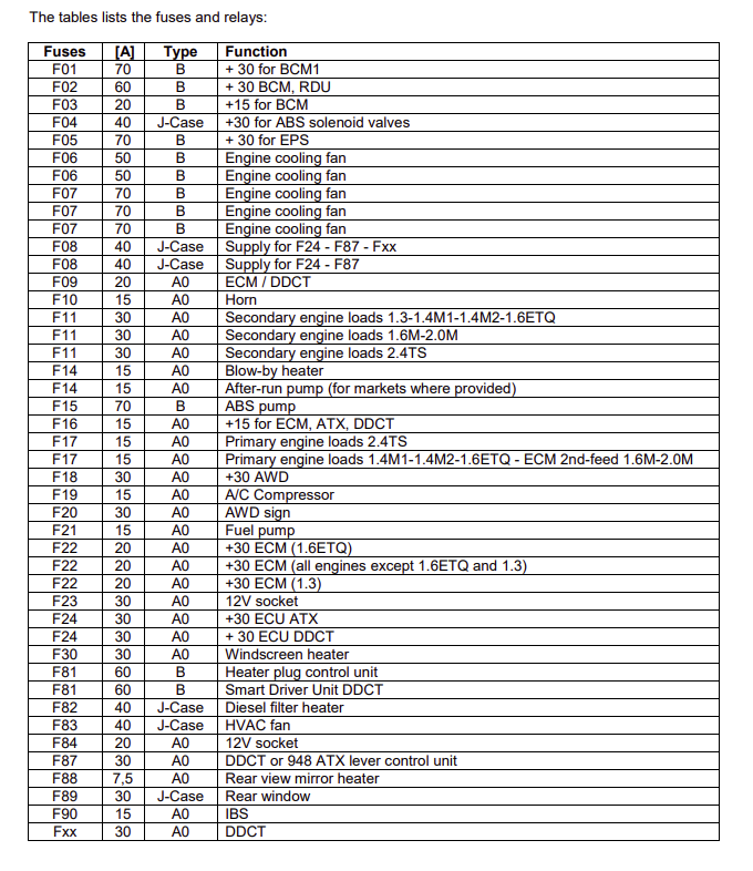

@s130 will be familiar with the kit on a 500x
You have covered the obvious certainly
The forums excellent Search found this :

Have a read through,
The excellent info from @s130
Just one thing to add: some of the fuses have permanent +12V, others have +12V only when ignition is on. On the diagram posted by s130 I can only see the F11 and F17 numbers, and both are described as engine loads, so that could be the case.
It's strange that the voltage appeared when the negative cable was disconnected. However it could be some parasitic voltage from the capacitors in the ECU module.
