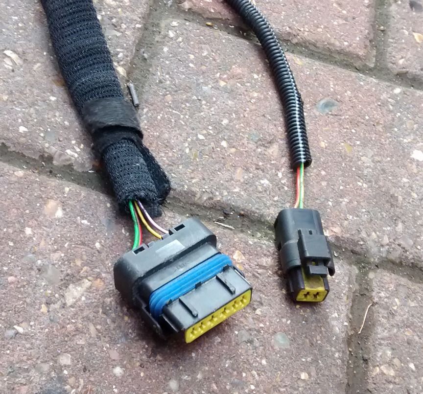

Can anyone identify these connectors and where/what they connect to?
They are part of the engine bay loom.
I'm searching through eLearn but i can't find them.
Thanks in anticipation.
Where do they branch off the loom? Pic.
Hello again
Just before the blue multipoint connector that sits in the main fuse box under the fuse / relay board. The loom after the blue clamped connector heads off to the ECU. By the length of the wires they might have been connected to something towards the driver side of the vehicle.
Couldn't get a photo the showed anything useful.
Hmm not sure, the only two pin of that style I can think of is reverse switch? Does it have flame plug in the intake or heat flange, has it got egr?
Yes, has flame plug connected.
Can't find an EGR. it's been removed or maybe there wasn't one on this model?
Reverse switch is connected.
Looked through eLearn and can't find a two pin connector with GR and GV wires.
Theres an intermediate connector on the reverse switch too up under the fuel filter area suppose to be red/white and blue wire though. The only 6 pin I can think of is the lift pump/sender. Thats wired 1234.
Yes, the reverse switch wires are red/white and blue.
I thought the 6 pin was the lift pump/sender until i checked the wire colours.
OK, well, thanks for your help. I'll tuck them out of the way and see what happens.
