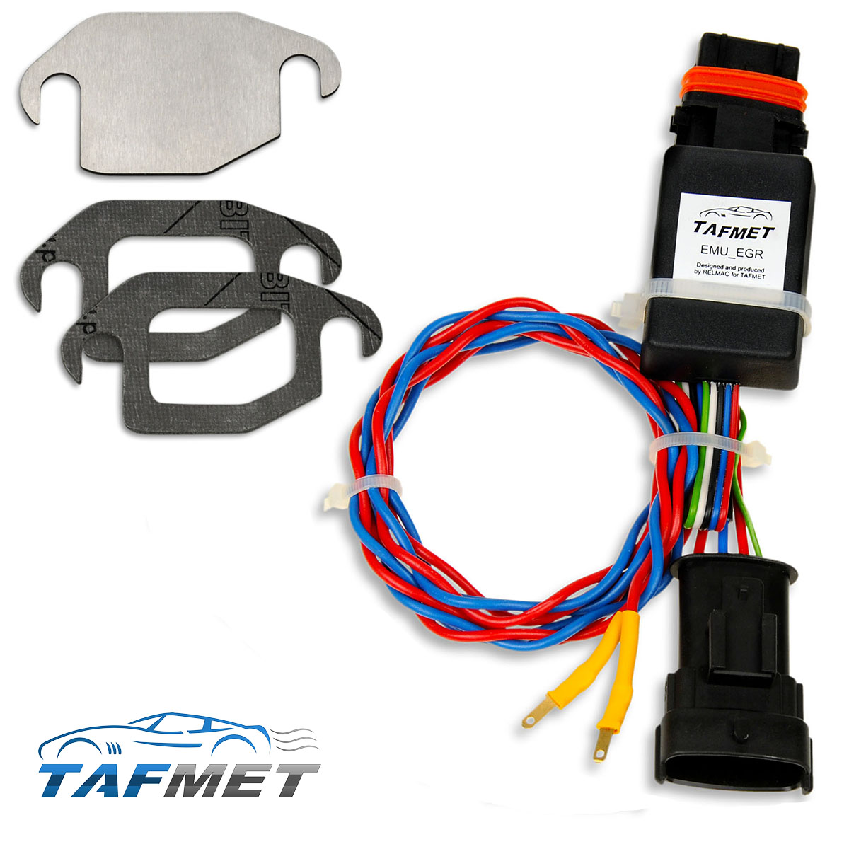

had the egr blanked off on my qubo for a bit now the eml was on most of the time then some days I would go off for a week then come back on so today I fitted this kit no more eml and the car goes like a train and picks up better in 5th gear to so well worth the money
