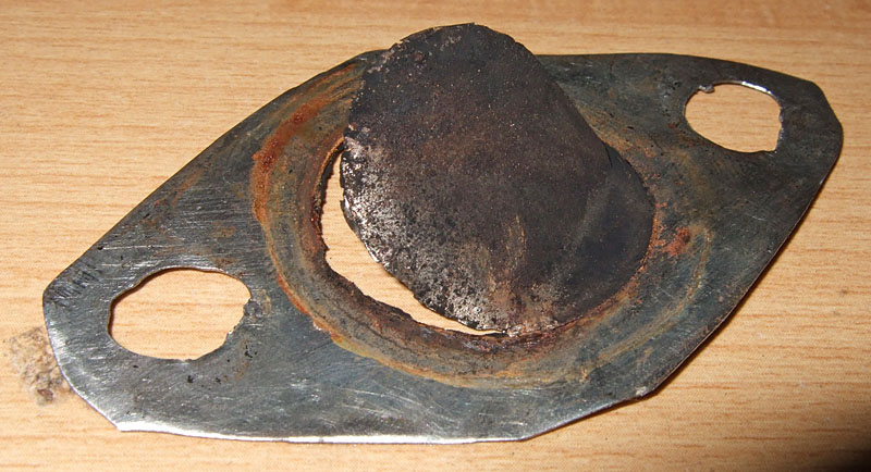

i did mine the other week and its loads better now i used a beer can
beware, check it again!
see attached image, what happened to my tea can (the same as a beer can) blanking in a month
luckily it did not fall into the manifold and to the valves - but that could have happened easily, yikes... :bang:
so thin material like this (which you can cut with scissors) is safe only for a temporary test, otherwise it should be at least about a 1 mm thick

I wonder if the temp of the combustion was enough to melt the thin bits of coke can that entered the engine reducing the damage?
Add hot exhaust gases to two different metals and there will be some sort of corrosive reaction.
Thats why I previously posted this:
Metals like steel and tin react so its best to use atleast 1mm aluminium if you plan to blank the EGR permanently.
Using the same metals reduces the risk of a reaction.
