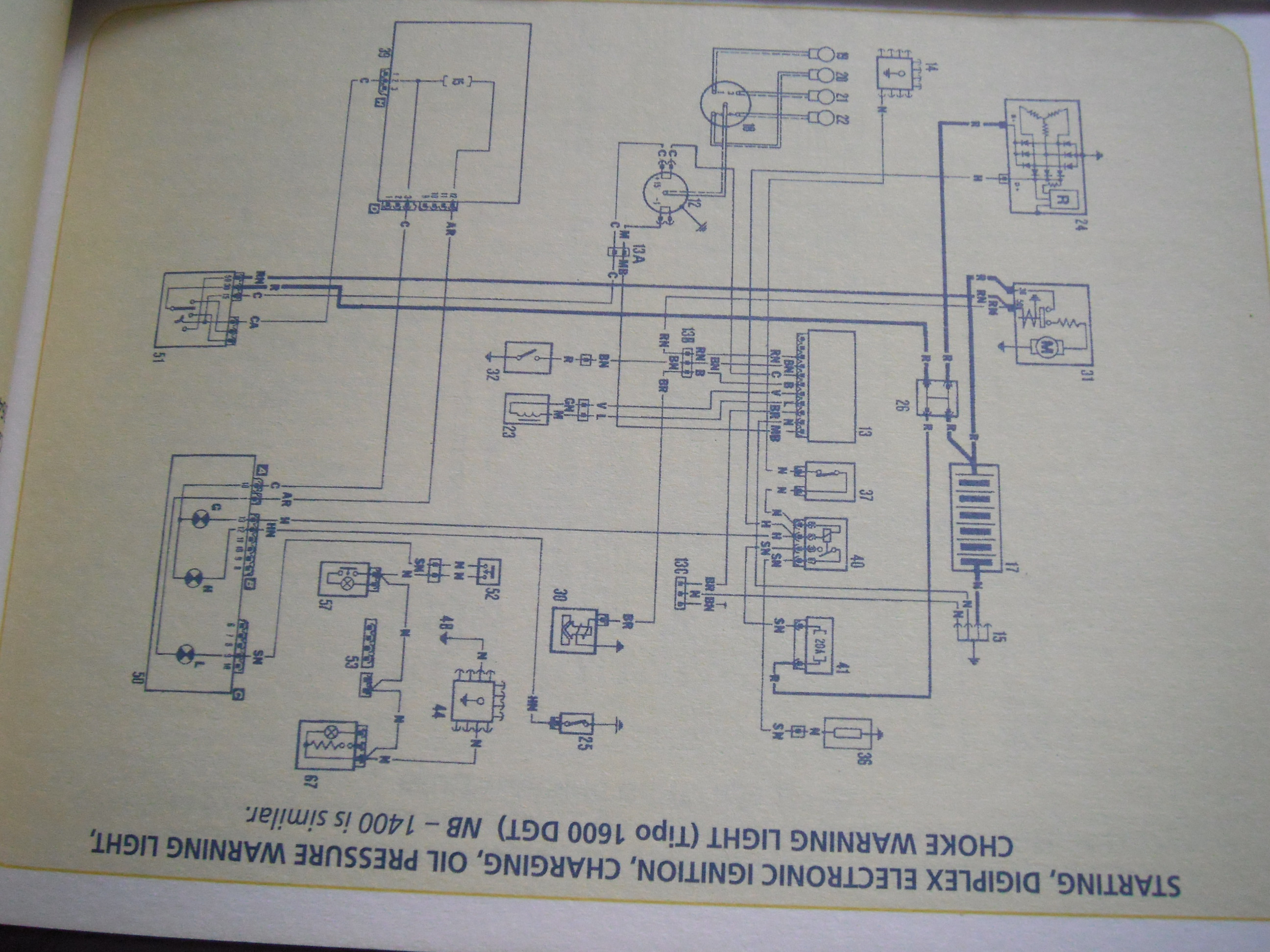

Hi all
Has anyone a engine harness / ECU connector diagram for a 1.6 SPI Tempra / Tipo?
Hoping to fit the engine to my X1/9 shortly...

OK,
the LP manual has this ;
Tipo 1600 DGT Digiplex electronic ignition,
small single diagram covering =
control unit, lead connection ( H.T.?),Diagnostic socket.
let me know if this is what you want,
I hate electrics.. so this doesn't mean MUCH to me.. however ,
here are a pic or 2 !! ;)
a SCAN could take more time / effort.. = let me know if this needs scanning,
pics look o.k.to me ( upside down..:D)

Thanks for those Varesecrazy
I 'Think' i need page 160? With the ECU on it, 35 wires or something coming from it. I have the pdf but cant make out all the info.
I am bidding on a Lindsay Porter Manual on ebay currently so fingers crossed.
Iv got all the bits in a box minus the lambda sensor, which I will order when i know exactly what type of plug it needs and how many wires it has... apart from that it'll hopefully be an easy swap. fingers crossed. I'm no experts with electrics either but i'm learning a huge amount from the X1/9.

no problem.(y)
I've got a 4 wire Lambda from my 2.0 tempra sat here ;)
the wiring diagram that APPEARS to have an ECU plan ,
is Bosch Monomotronic SPI = tipo 1372s = 1.4 engine
let me know if you want pics of that schematic..!!
charlie

Yes its been very useful. Almost got the engine fitted and running over a weekend - 27hrs working on the X1/9! Painted some areas of the engine bay and also had to modify the X1/9 engine mount slightly. I have yet to finish the electrics though.
The original Porter manual circuit diagrams do have poor print quality so no wonder the wiring colours are illegible on the pdf... It is readable in the book though.
It was definitely page 160 i need.
