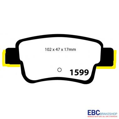

where yellow is

I've just put copperslip on the edge bits like you said Dave, about to go and give it a try now
