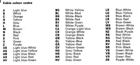

Dont know where to put this so here i thought i would try,
Where on elearn for fiat stilos do i find the wiring colours code.
Need to find out what wires go where between 2 different looms.
Any ideas would be great.
Thanks.
I take it the DVD arrived then?
Don't think it's shown in eLEARN. This is the list I have from a hardcopy Fiat Manual.

Thanks for wiring colours.
