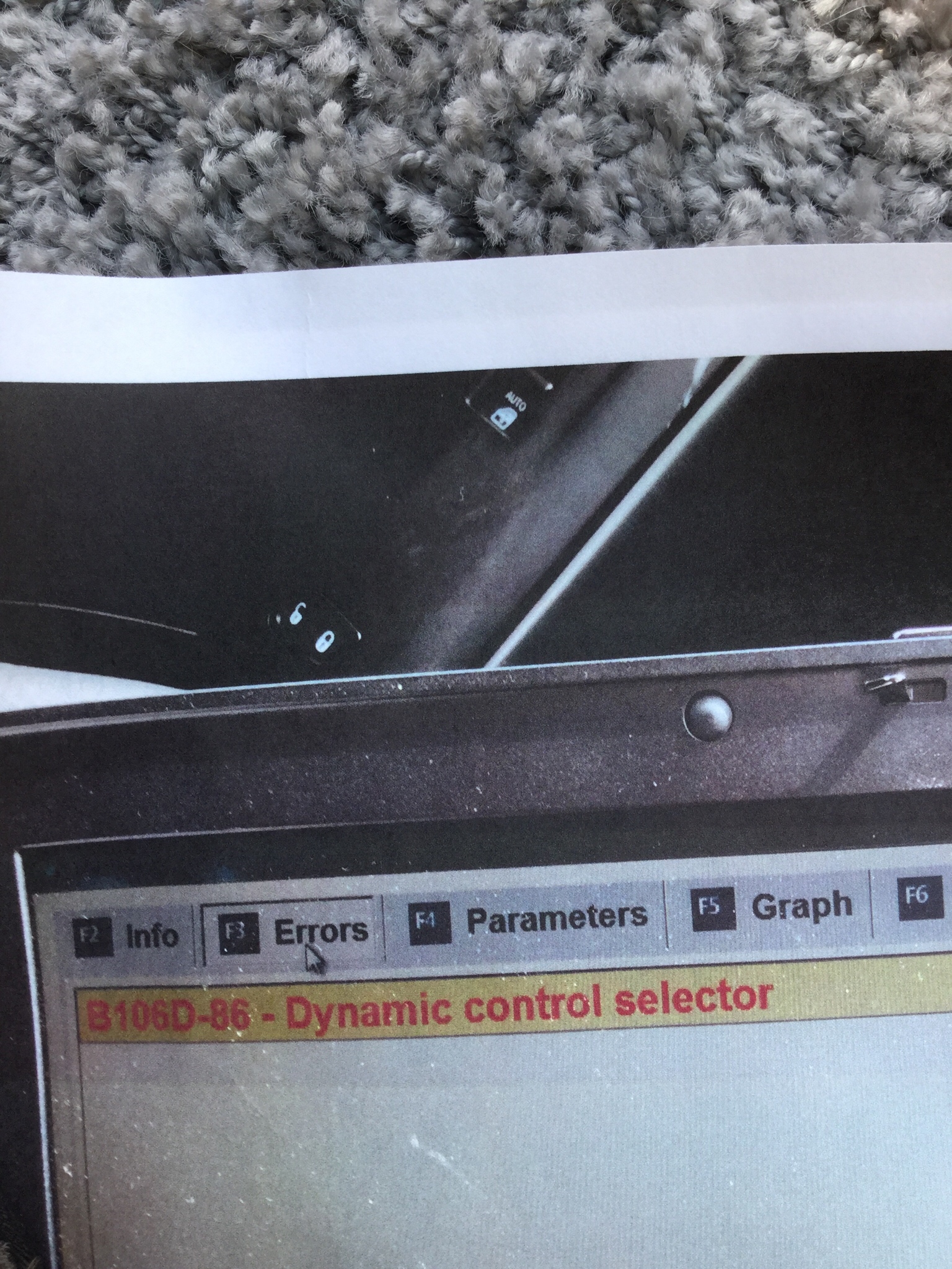

One of the problems I’ve got with my new Cat S 500S is the dynamic control selector not working. MES gives an error of B106D-86. This is presumably nothing to do with the EPB, ABS problem.
This was all related to the ABS module and speed sensors/ABS sensors that were damaged in the accident. The sensors were changed and as long as auto EPB is set to off, it now works. Still haven’t had new ABS module fitted yet as there’s an issue with coding it to the car as if it’s just fitted the EPB will lock on.
