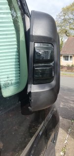

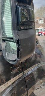

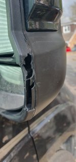

Hi there,
Sadly our driver's side wing mirror was hit whilst we were stationary. Although the glass is still intact, the plastic surround has a chunk missing from the thin trim section that surrounds the mirror unit.
Is it possible to just replace this bit of trim rather than the whole mirror?
Thanks in advance!

As far as I know you can't get just that bit. I have similar damage - (caused by councils not doing their job we pay them for cutting back the trees growing out into the public roads they are supposed to maintain) My mirrors get bashed so frequently in this way I fix them up with good quality black gaffa tape - sticks really well to plastic and can last many years.
Thanks. We have the details of the van driver, so can go through an insurance claim - but as the little rim bit looks like it would lift off I just wondered if maybe I could get hold of a replacement- I might try a few breakers yards ... you never know!
As the mirror is most probably electically operated, check that the adjusting mechanism is still fully functional before spending time on a search. The adjusting mechanism uses tiny nylon gears, and racks. The impact may have stripped the teeth from these.
Difficult area to repair on that edge. I suspect it will be a whole mirror housing if you can find one and swap the internals over, otherwise a new mirror.
