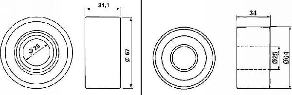

Just wondering what exactly happened to the engine when the Belt snapped how many Ks did it have on it? I have researched sourcing the rollers from bearing suppliers but when you give them a Fiat Ducato - Nil so I tried under the Iveco Turbo Daily 2.8 & have had some success with the larger of the two - the 67mm dia one, have yet to try direct from an Iveco dealer as they should in theory be the same as it is basically the same engine
Re above
Gates has a Timing tensioner kit available which has the belt & the two rollers & maybe extras under Part number K015334XS
O.E BRAND GATES POWER GRIP
THE BELT KIT IS SUITABLE FOR:
FIAT DUCATO 2.8TD ALL MODELS 2001>
Eng Code/Series: 814043S
KIT CONTENTS
TIMING BELT(S)
TIMING BELT TENSIONER(S)
TIMING BELT IDLER(S)/ROLLER(S)
BOLT(S)
PLEASE NOTE. ALL KITS HAVE DIFFERENT CONTENTS DEPENDING ON MAKE/MODEL OF THE VEHICLE
The Gates Belt Part number used in europe is 5334XS which is a different Number used in Australia - T1555
Attached is a pic of the specs for the two rollers
