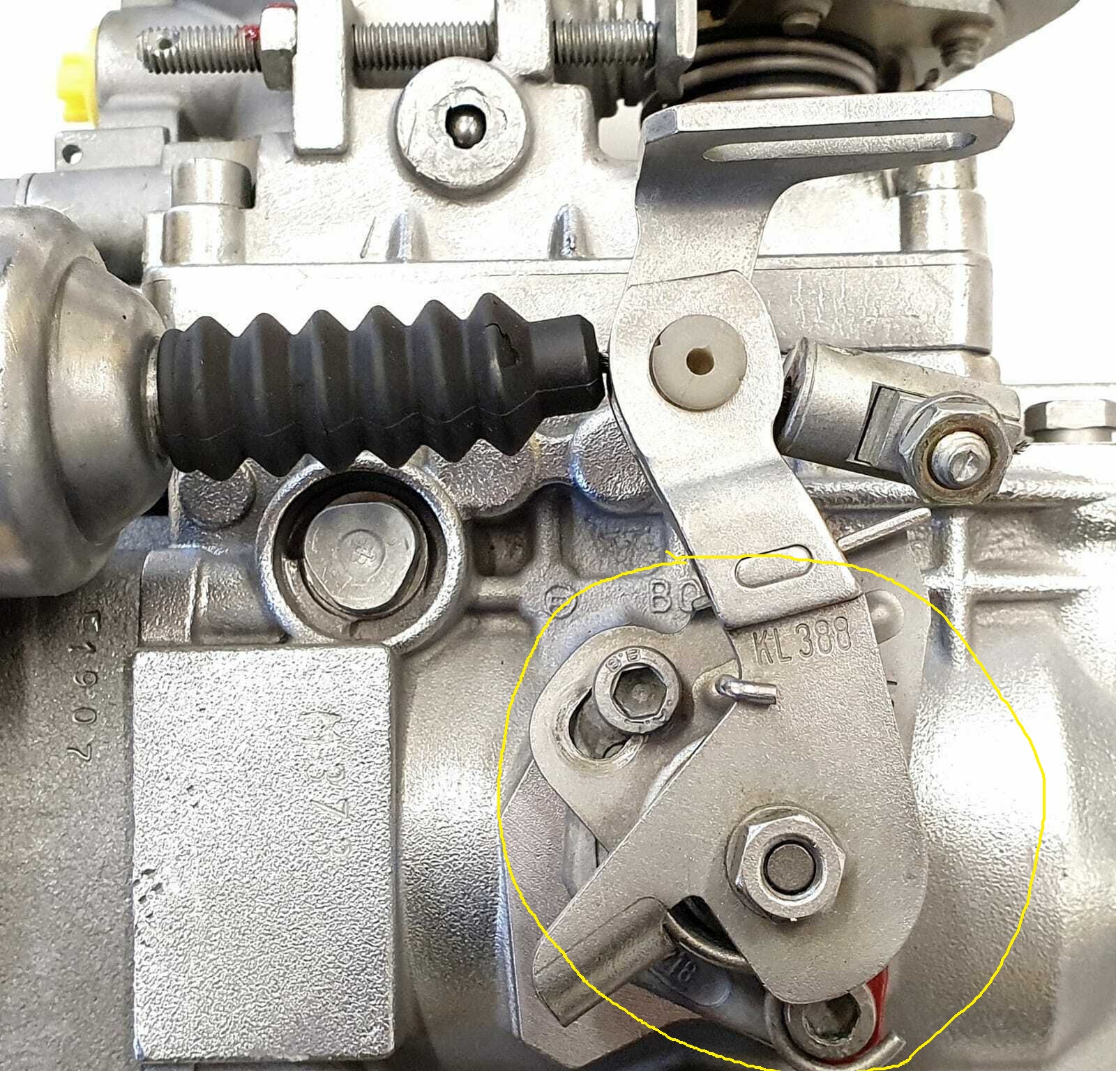

can i fix the fuel leak coming from under the throttle lever/return spring on the fuel pump on my ducato 2.5 1997 diesel van,if so is it EASY,ta to anybody who can help..
I have sorted the fuel leak by taking off the actuating lever and putting a couple of o rings on the shaft,replacing the lever this pressed down the orings therefore sealing the leaking fuel.:)

i have a fuel pump leaking behind this is this the same place as yours gearjamma
