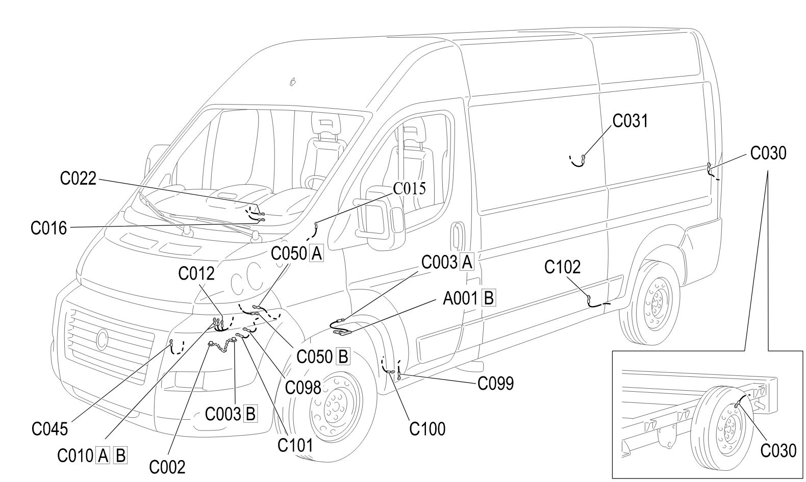

The earth points, especially those behind the headlight tend to rust. The earth cables rot in the inside.
All of the above mentionned cause strange electrical issues.
Here's a list and location of the earth points to check:
