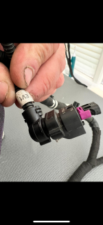

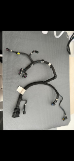

He started the van moved this harness it selected gear
Which then told us this was shorting

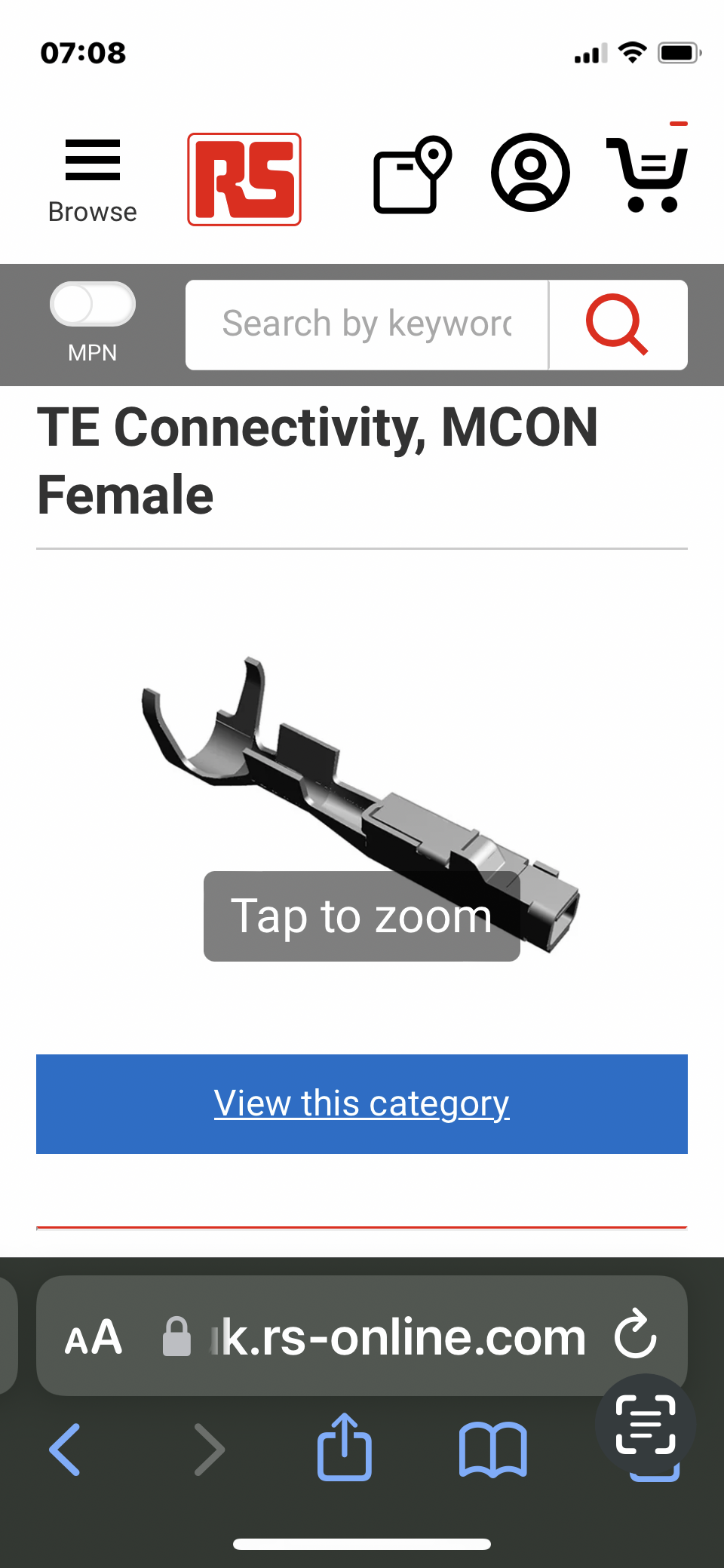

He tie rapped it in place it got me home I repaired after much research on which contact to buy
If yours is the same I can give item number etc what to buy

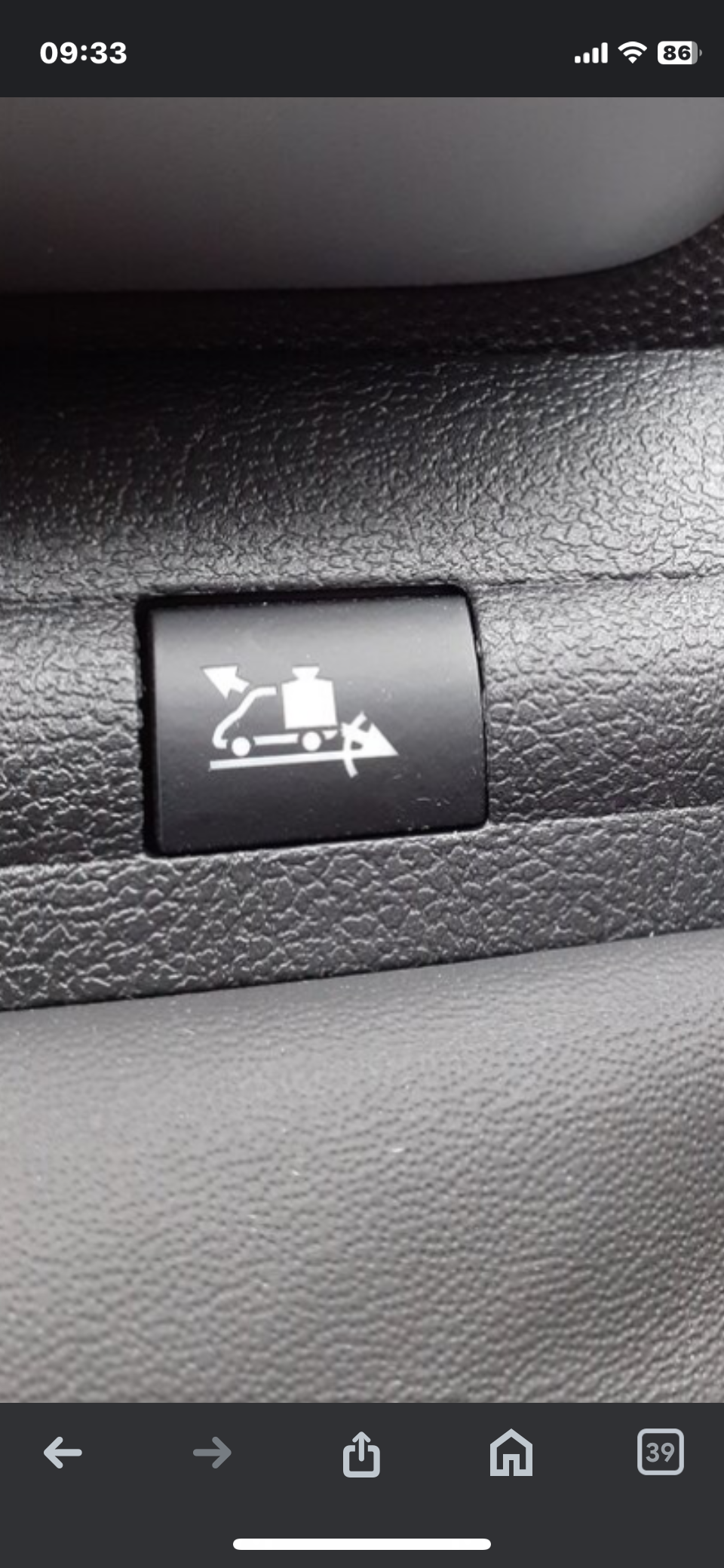

I also noticed having the hill climb button on all the time really helped with faster gear changes too
A motorhome is always loaded and that’s what this button is for
Once pressed you get a E near the auto on the dash

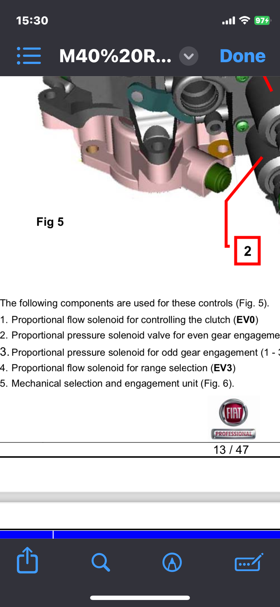

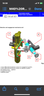

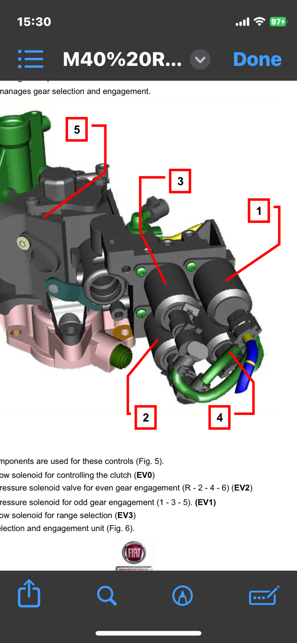

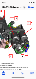

This image here which I posted the download

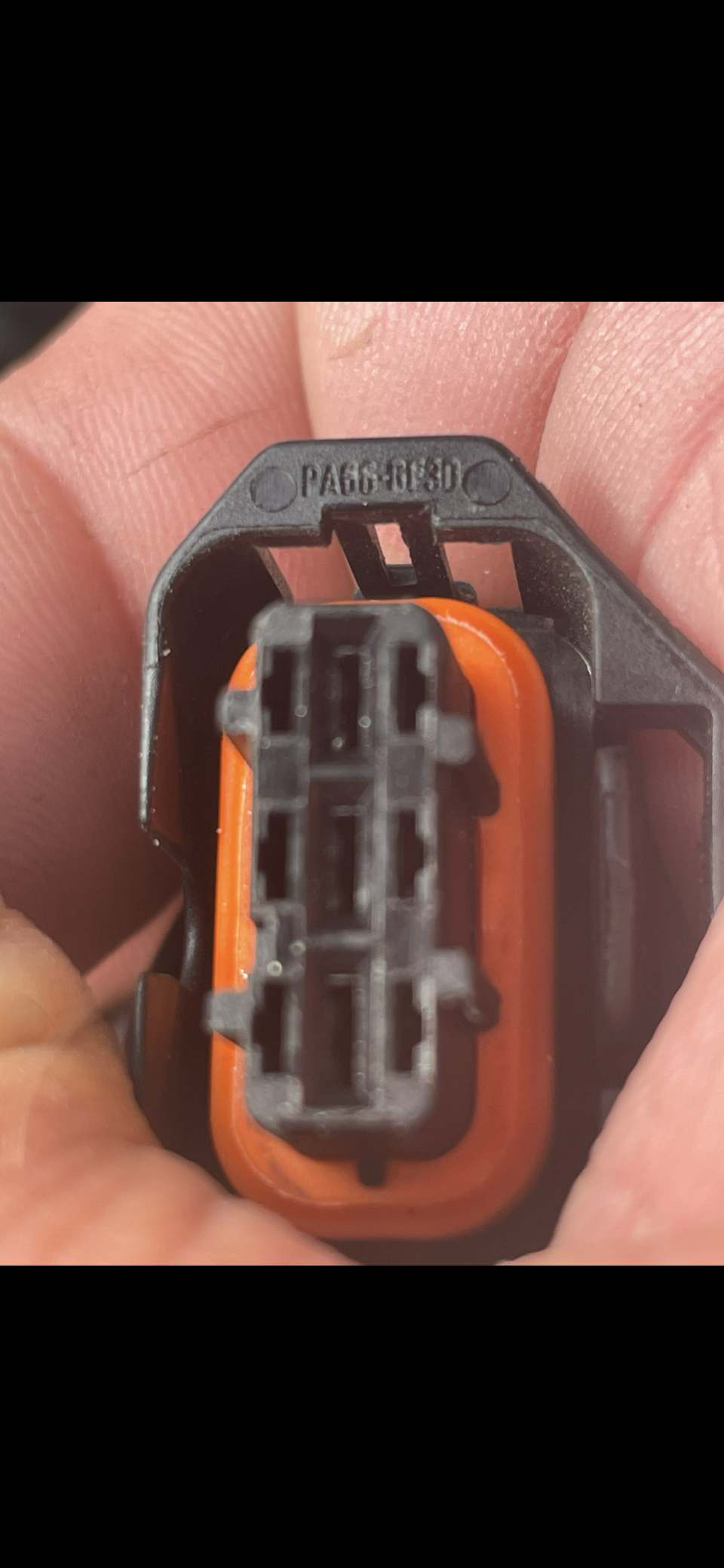

I had issues with number 3 which is evo 1 solenoid for odd gear engagement
And number 1 which is evo 0 solenoid for controlling the clutch
Which think about it guys 🤷‍♂️ these will throw out the no transmission fault gears available these are the most 2 important solenoid out the bunch
I’m actually starting to think possibly every post made about no transmission these are the culprit
The scuttle tray leak needs sorting 100%
But fiat made this hard work pre facelift
Even the back of the air box drain empty on the rear gear box 🤷‍♂️
Corroded contacts
Harness not clipped enough will move and vibrate
Eventually the contacts snap with so weak
They short out kicking the no transmission
Leave this button on also just try it let me know 👍 so in the manual it’s basically for a loaded van
Which in a motorhome you are always loaded so this helps massively
I noticed a smoother gear box change
At first setting off in auto in first it took for ages to change to second
When your waiting for the change and can hear the engine thinking omg change already what you playing at 😂 Igot this all the time
So made calls thinking maybe the clutch was to blame for my issues with the no transmission etc
Anyway fiat told me this helped with hill climb and loaded vans like a sport mode more torch even helps the steering
But my gears change faster it’s more responsive honestly try it yourself
in normal vans they pressed this going up steep hills if holding lots of weight
well in a motorhome coach built it’s a fiat cab basically with a caravan on the chassis so yea it’s loaded
now when I set off I don’t get the long gears on the straight only on climbing hills it holds gears longer but the manual explanation is better then mine
But lots of benefits to this button if in auto mode obviously 👍 now I leave this on all the time
