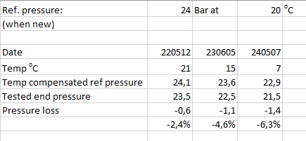

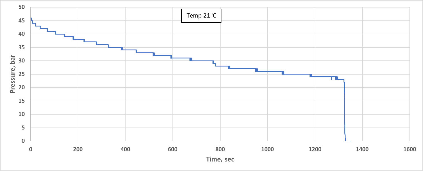

The pressure accumulator is filled with nitrogen (24 bar @20 Deg C when new) which is kept separated from the hydraulic oil by a membrane. If the membrane breaks, there will be immediate problems i.e. the pump will start running most of the time which kills the pump motor pretty soon. So it's good to replace the accumulator before this happens. I have seen 10 years recommended as maximum exchange interval (also seen shorter). There is also a slow deterioration of the accumulator performance due to nitrogen leakage through the membrane and/or the housing. This leads to more frequent pump starts and eventually the same problem. One can check the remaining fill pressure by direct or indirect methods. A direct method is to switch ignition on and let the system power up, then remove the pump fuse or relay and monitor the pressure via MES. It may take a while so a battery charger probably needs to be connected during the test. When the nitrogen has pressed all the oil out of the accumulator there is a sudden drop in system pressure, and the point where this happens equals the current fill pressure in the accu.
Example:
I have done this test a couple of times on my Ducato and got these results:
I.e. in May this year it had lost 6,3% of its nominal capacity.
Example:

Once you pull the fuse you look in parameters and check the pressure after depressurisation which in return lets you know if them accumulator is good
You start with the system pressurized, pull the fuse or relay and then record the pressure (select pressure in Parameters, then start graph) and monitor until it drops suddenly to zero. Observe the last pressures before this drop in the graph, or save the data to file and check there.
There will be alarm(s) when the pressure has fallen below the pump start threshold and the pump doesn’t start but that has not created any problems in my tests.
You can also accelerate the process a little by doing some gear changes it the beginning.
Example:
Brilliant @MSjoberg Obvious and simple, but you have to think about it first - and you did that! Thank you so much for sharing.

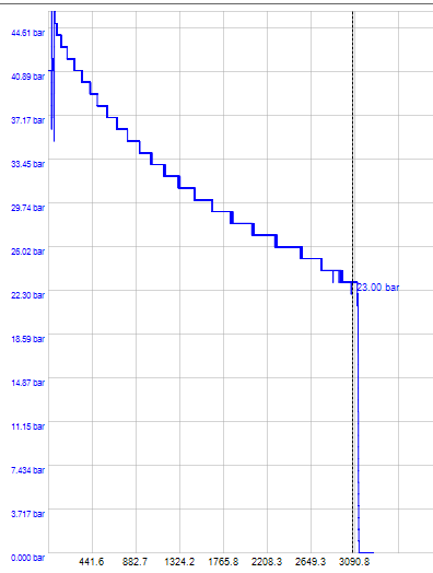

Hi @MSjoberg , you have inspired me to check mine. The following graph straight from MES, Temp 22C. It would seem the bleed down time is over twice as long.
Yes the time can vary a lot from one pump to another. If the pump is very ”tight” the test duration might be unreasonably long. I would like my pump to be a little bit tighter, that would reduce the number of pump starts needed just to compensate for the leakage.
The pump may have a bit of leakage (I assume it has a one way valve incorporated), but I would think the main leakage would be of the piston seals of the control solenoids.

Hi @Seanwinder22 The method is to first begin recording in MES the hydraulic pressure. Then simply pull the pump fuse. Depending on leak rate it will take some time to bleed down fully - in my case it was 3,090 seconds or approx. 52 minutes. The pressure will be at normal operating pressure to begin with as the ignition will be on. Pulling the fuse stops the pump from restarting. Be aware that a fault code will be triggered during the test when the pump command comes on. That is no problem and can be cleared later after completion of the test. To record the graph, you need to select the hydraulic pressure in "parameters", and then select "graph", the select "Start". This will begin the recording of live data in graphical form. Then just sit and observe. It will take considerable time to bleed down. When it drops to zero, you then select "Stop". The data will be saved in MES files. This is how you use MES for recording/capturing and live data. Then, just replace the fuse and clear the fault that was triggered during the test. Hope this helps. Cheers and Merry Christmas!

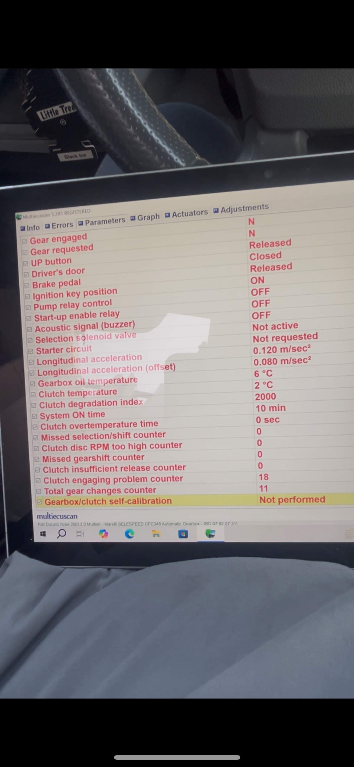

Hi again this would really help if you can show me just one thing in parameters that concerns me
Gearbox/clutch self-calibration
What does it say in yours please ?
Mine says correct but only after doing calibration or end of line
If I connect now and go check in parameters it says not performed just wondering if this is normal until you carry out a calibration every time
I was under the impression this should correct itself has a self calibration every time you turn the ignition on
But in my parameters has mentioned this will change from not performed to correct after I do the calibration myself
Very strange
So if that’s the case something if wrong

Delete statistical data and Production/Service final calibration which did the trick but noticed clutch degradation didn’t change neither did some parameters
So I was told to carry out not just the clutch reset known has kiss point but also gear box reset or tcu reset Which was Clutch replacement/ Electropump replacement/ Actuator base adjustment/ which in turn reset parameters to 0 and adjusts engaged positions
Here’s a screenshot of my parameters now which have changed especially clutch degradation index from 4025 to 2000
The only thing that has not reset is the clutch engaging problem counter 18 which I’m thinking to reset every parameter in gear box you need to execute the Reset self-learned functions
I’m guessing delete statistical data is gearbox parameter counts and Reset self-learned functions is clutch counting

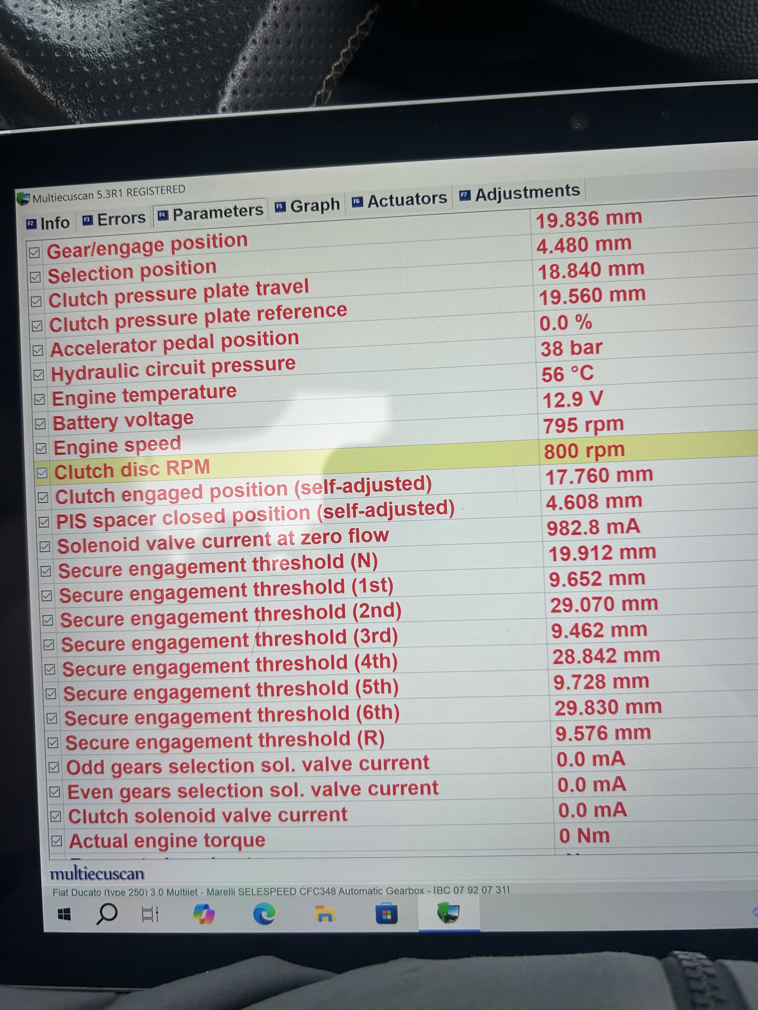

BUT….. when home parked up checking data in parameters my heart sunk because now I can see a new clutch kit will definitely be needed
What I think the issue is here is the slave
Can anyone see from this screenshot while sat in neutral engine started what issues I’m seeing that should be on 0
It’s intermittent it’s not all that time
I tried replicating it but only did it twice
