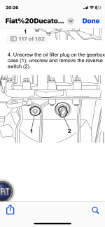

I also have the diagram on the fist download service user manual but it’s no use for me
So would rather talk to someone who’s carried out the job on this gearbox
On the diagram it shows a lot of things that I don’t have 😂 like engine bay fuse box it doesn’t show the seperate on for the hydraulic pump fuse etc
The refill plug says is next to the reverse switch

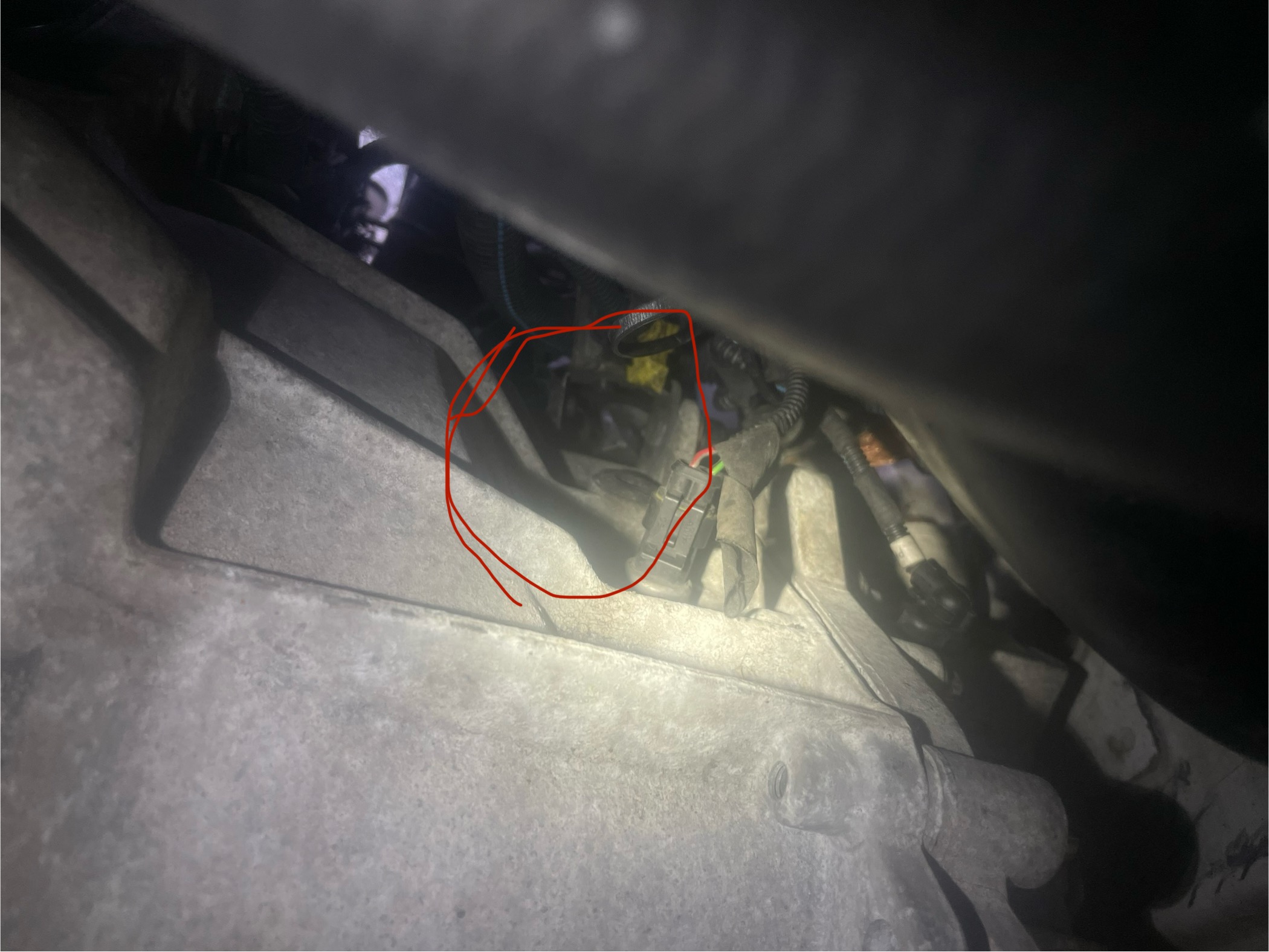

Here’s pic I have got or taken today

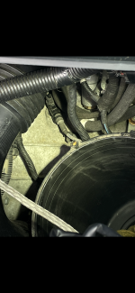

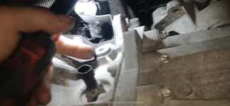

I will say I have found a rubber cap of some sort bang behind the rectangle reservoir for the transmission fluid which would be more accessible from the battery box I think
First 2 images are the rubber cap behind transmission fluid tank
3rd image is the location others have said they did the refill but this is my clutch bleed valve

The illustrations you have posted are "wonky" because they are taken from manual with gearbox mounted on a service stand.
The reverse switch and fill point are in the front face Of the gearbox. It is a fill point NOT Fill/level point. Trans fluid change is drain completely then refill with correct amount of correct fluid.

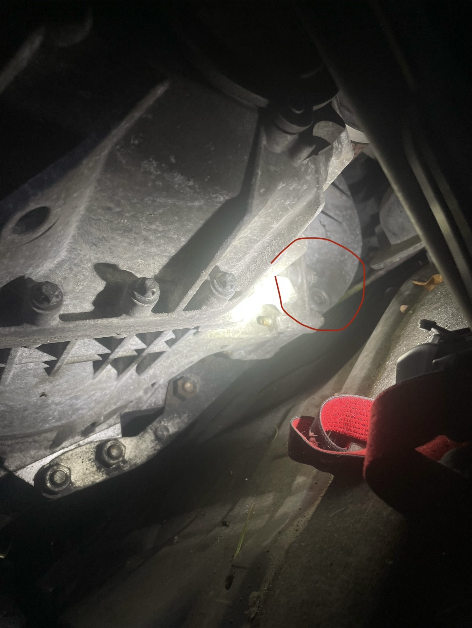

I found the drain hole bottom gear box right hand side
But!!! Just been back under behind radiator front face gear box is another plug 8mm Alan

That's correct " on the Front face of gearbox "
I was then sent this for the drain plug under the gear box
But again I don’t have the drain under or around the diff
It’s on the bottom side wall

Almost certainly yes but Post a better photo after you remove the under tray.
Plus measure how much fluid drains out for interest.

Here’s a better image
Tomorrow I will get it on jacks so I can have more room to do the oil change anyway from the sump plug
I’ve had enough room today however to get around looking

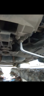

I also tried the filler plug with this 8mm square drain key it’s way to big
The filler plug near the reverse switch or what ever I’m looking at is small I’d say 5mm
Use the correct size and shape key it is far more likely on a fiat to be hexagon shape.
Once you get the useless undertray out of the way and vehicle lifted a decent amount on good ramps a mirror may help you get a decent view .
Once you get the useless undertray out of the way and vehicle lifted a bit (decent ramps) a mirror may help you get a decent view .
I can’t find any information that the refil plug is smaller then 8mm tho mate is my worry
12mm for drain plug
8mm refill plug

You will know far more when you get it properly up in the air and have a proper look yourself .there is often a limit to what is worth trying to find on www before looking with your own eyes.
Plus stuff on www is often not 100% for instance you have already had someone send you a picture of the drain plug which is clearly incorrect.

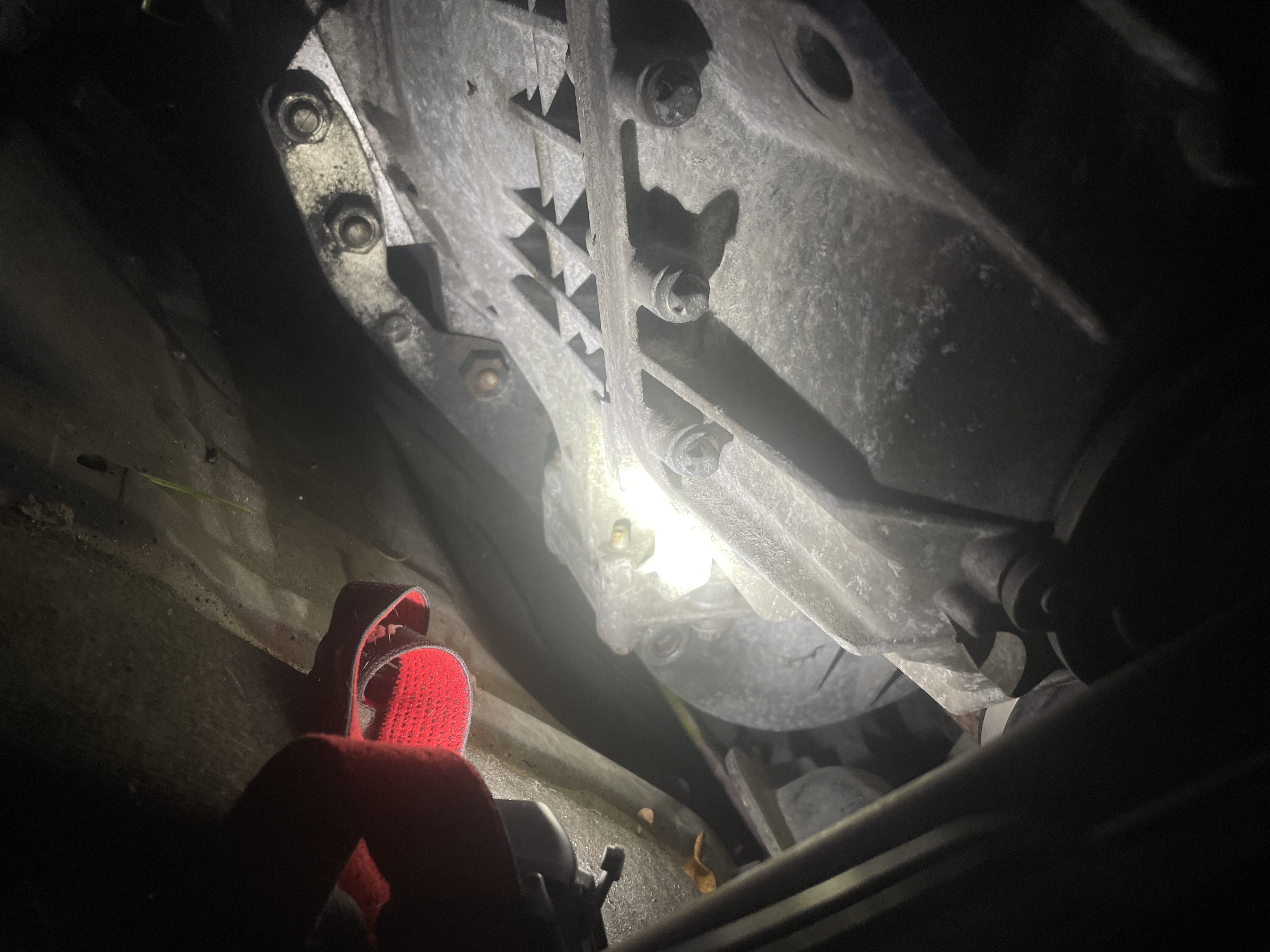

Ducato 3.0 maxi 160 multijet 2009 comfortmatic m40 box the lower gearbox drain plug location and only drain
2nd image is the filler plug next to reverse switch front face
These are the only plugs on this box
