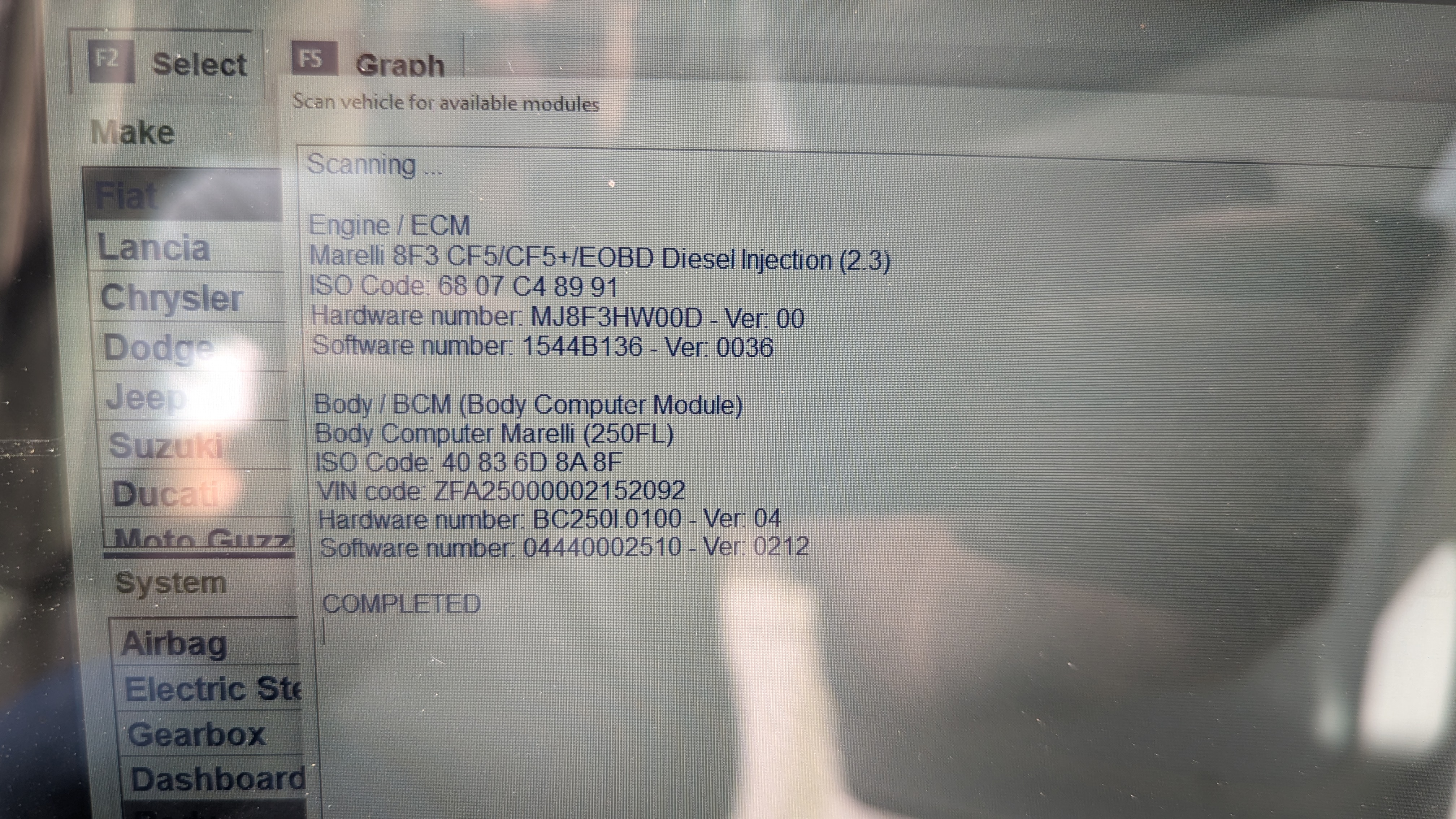

When I scan with MES it only finds 2 modules

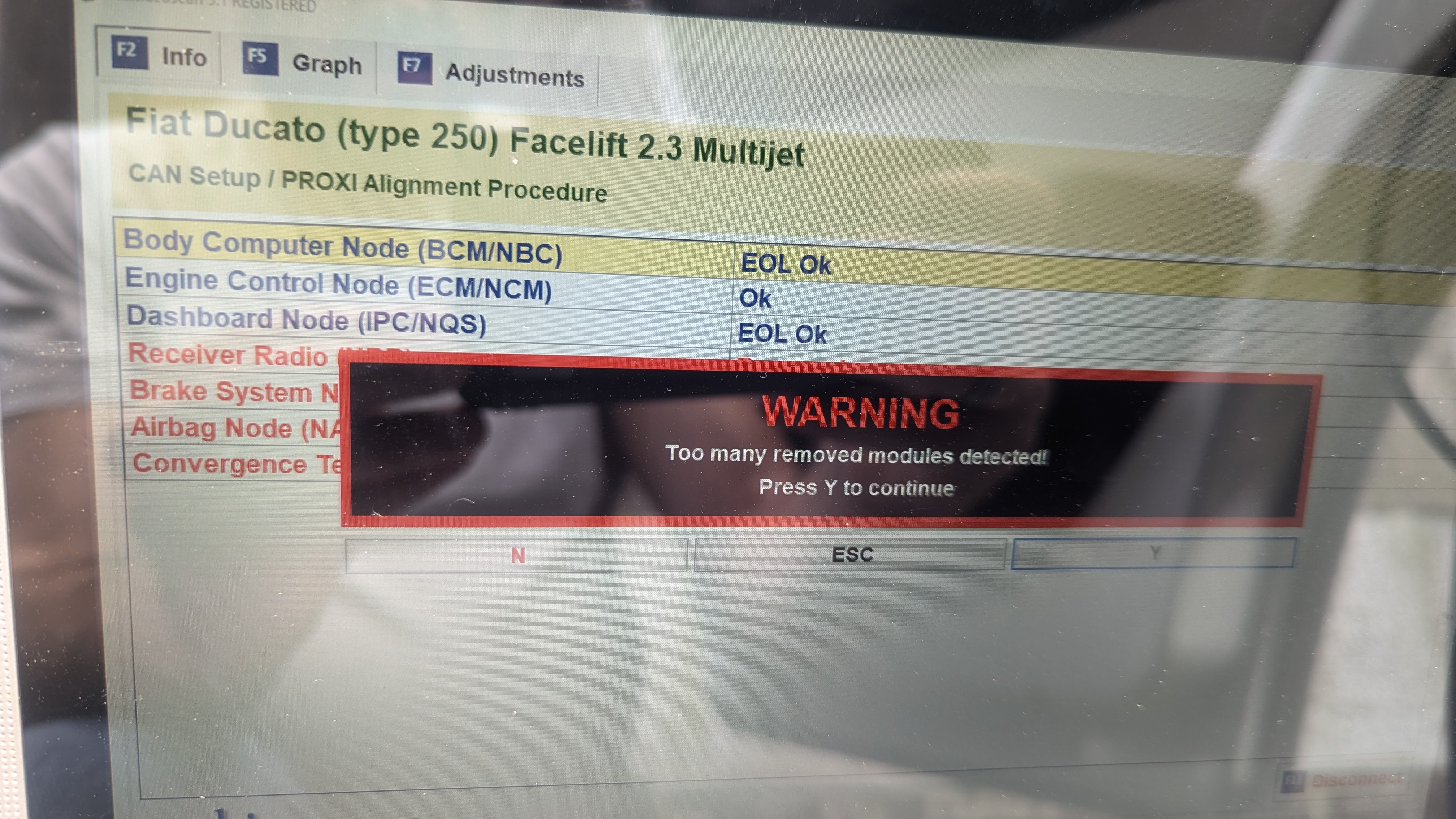

When I check in the proxi alignmet it says this

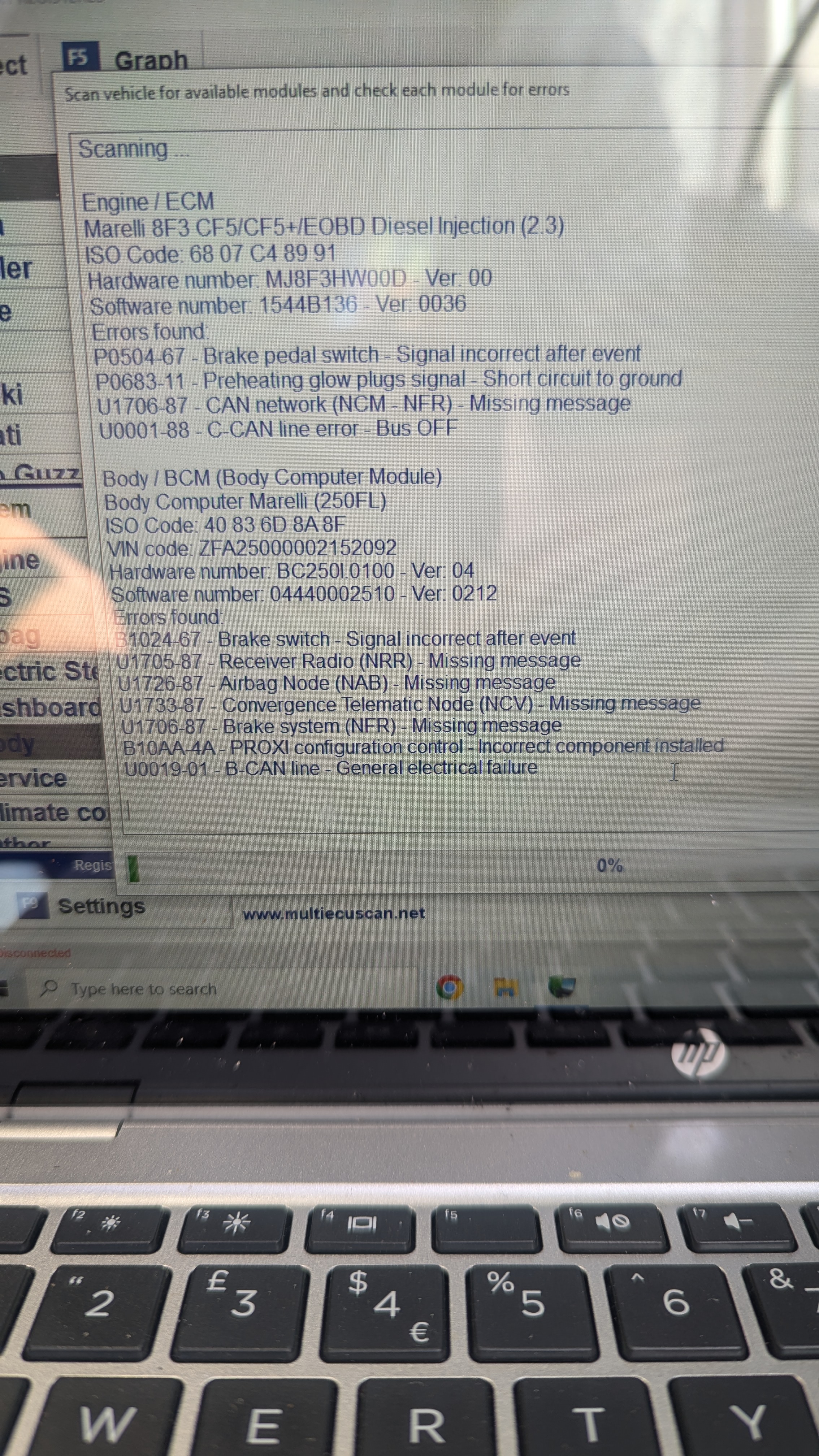

If I scan for dtcs I get the following
I am stuck at this point as unsure where the other modules and earth connections are that I could check.
I know there's much more to canbus errors than earthing but it's where I have started with my limited knowledge.
Any suggestions where I could go next please.

How healthy is the battery? There are so many faults there that it’s possible during start up it dropped the voltage across the electrics and cause all those errors. I’d make sure the battery is well charged and healthy, get a drop test done or just replace it, clear all the faults and see if anything comes back. Especially as it’s a car that is sitting for long periods
I've never has any issues starting the van up but the battery went on an overnight charge anyway just in case but nothing has changed since that
It will clear some of the faults but they return as soon as the van is started up again

I am going by the air bag node missing message and the PROXI configuration control - incorrect component installed messages makes me suspicious.
As though someone had tried to repair after an accident and maybe fitted odd parts that didn't match etc.?

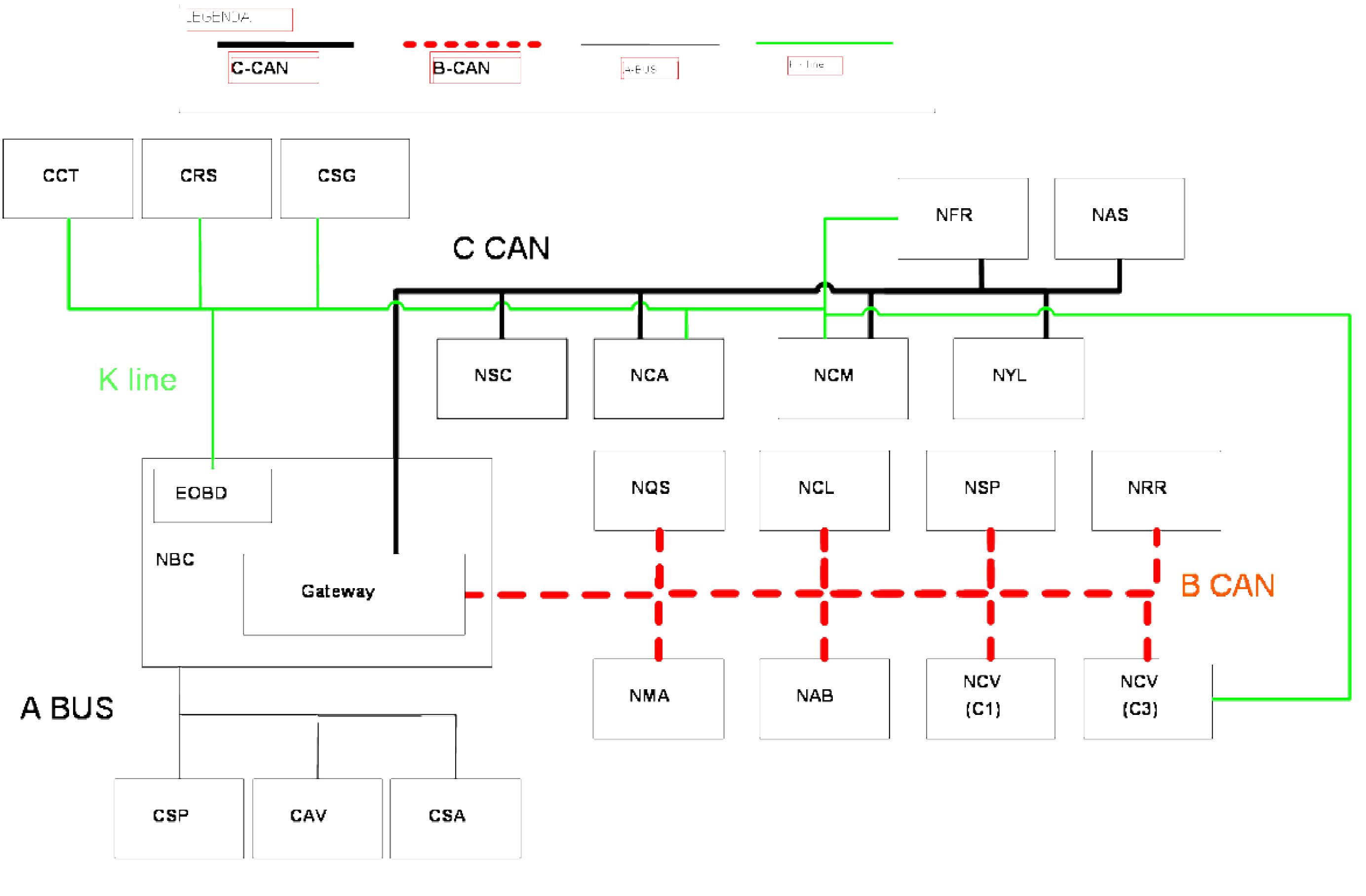

The worrying errors to me are the CCan and BCAN line errors although I'm far from expert

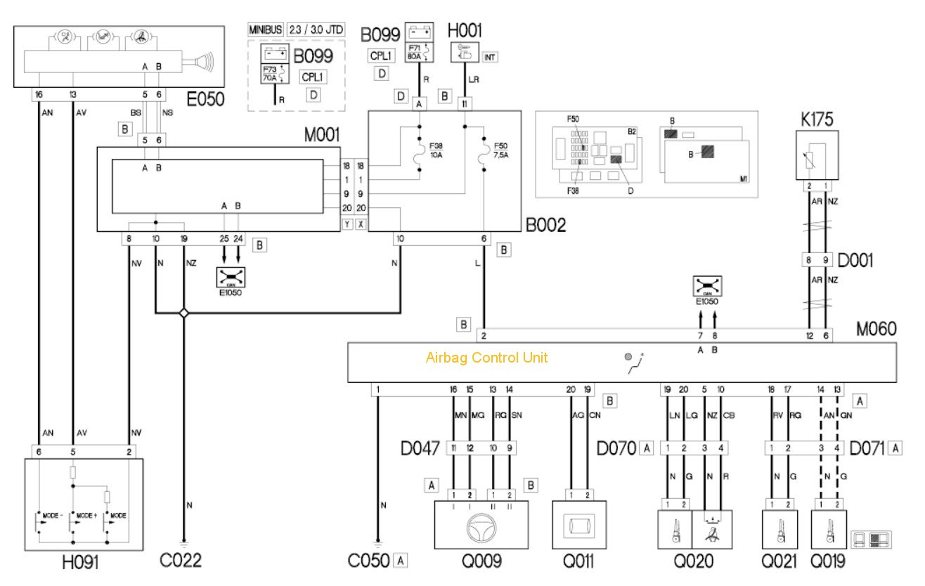

Hi
Here are some wiring extracts from eLearn
The brake light switch has two separate halves. Two connections "make" and operate the brake lights. The other two connections "break" and are fed to the ECU.
