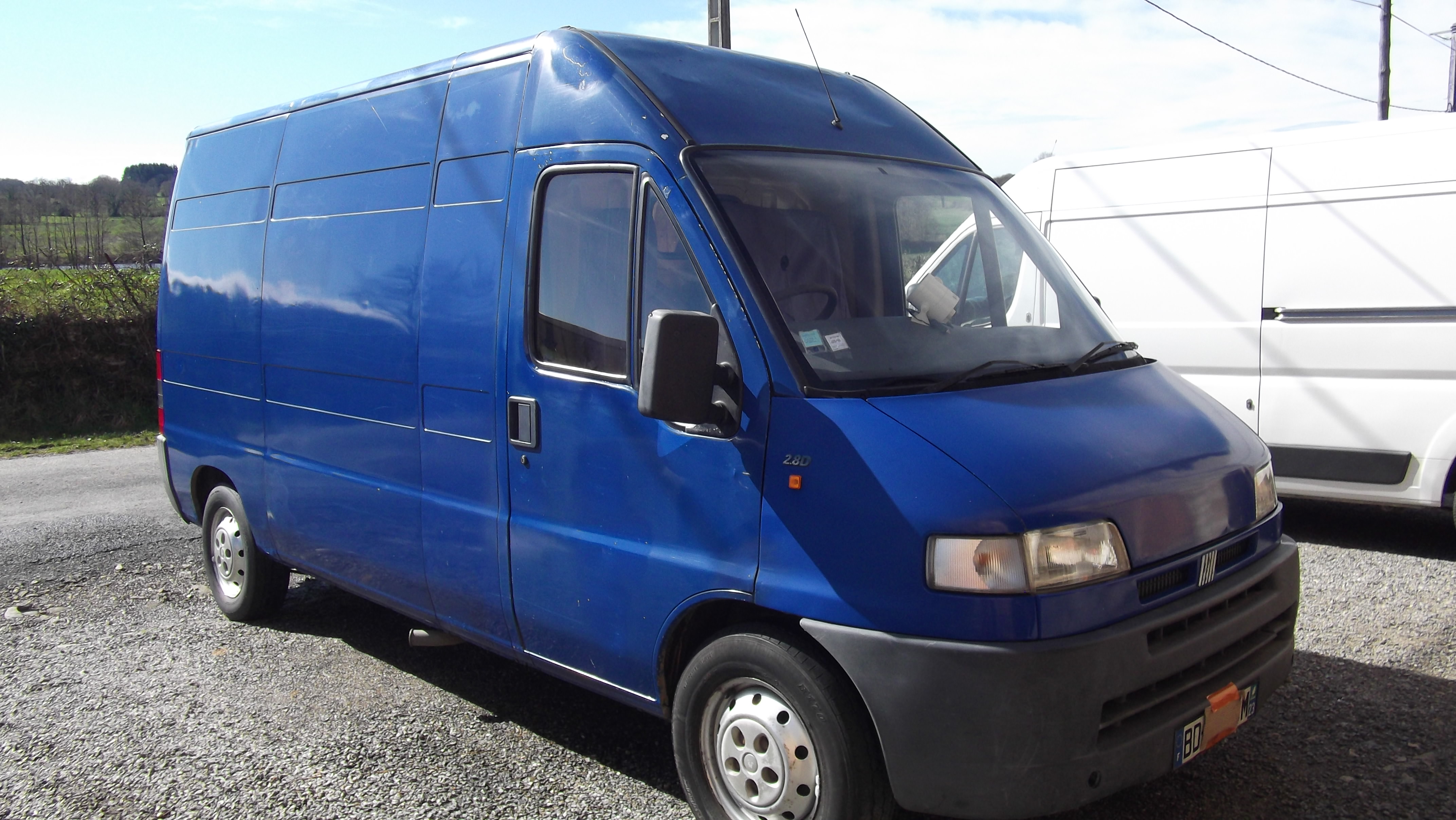

I have just become the proud owner of this rolling bucket of junk. It looks better the further away you get from it. :D
There are a couple of issues that I could do with a little bit of help on please and thank you.
The speedo needle flickers like mad up until about 90kph then it's nice and steady. New cable or adjustment perhaps?
The rev counter is firmly stuck at zero. Could this be a an electrical fault or is it related to the speedo issue?
I am considering swapping out the instrument panel anyway as it's a RHD in MPH and I am in France and would rather a unit displaying in KPH. Is it possible to adjust the new unit to match the true milage/kilometrage of the vehicle? Is there anything I should be careful of while doing this?
As I'm getting older I'm finding it harder to hear the indicator clicking, are there louder relays or repeaters of some kind available?
I would love to replace a few of the niggly little broken items such as interior light lens etc. Is there a site that specialises in that sort of bits and pieces. I find eBay to be very tedious when looking for stuff like that.
I think I win today's prize for the most questions in one post. :D
