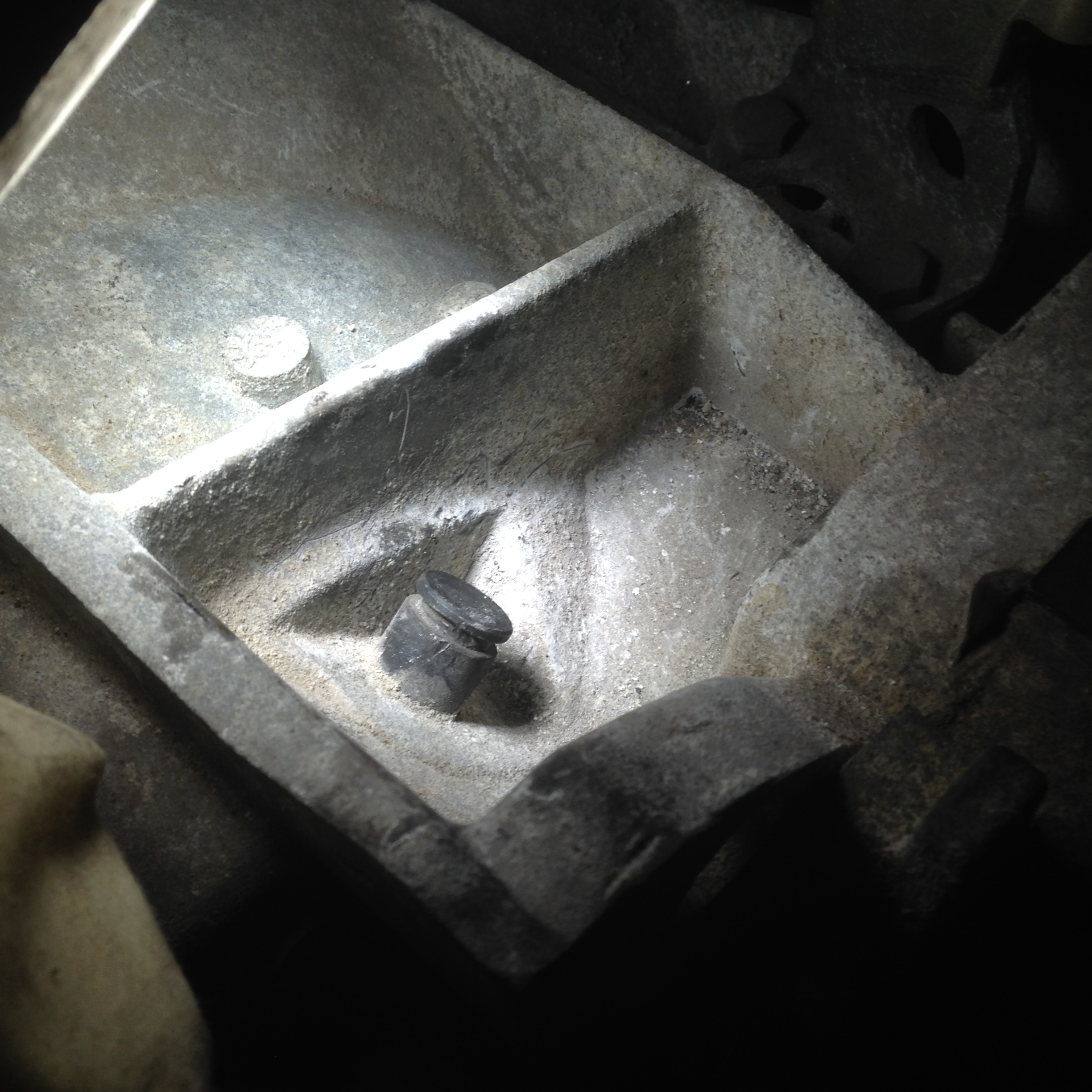

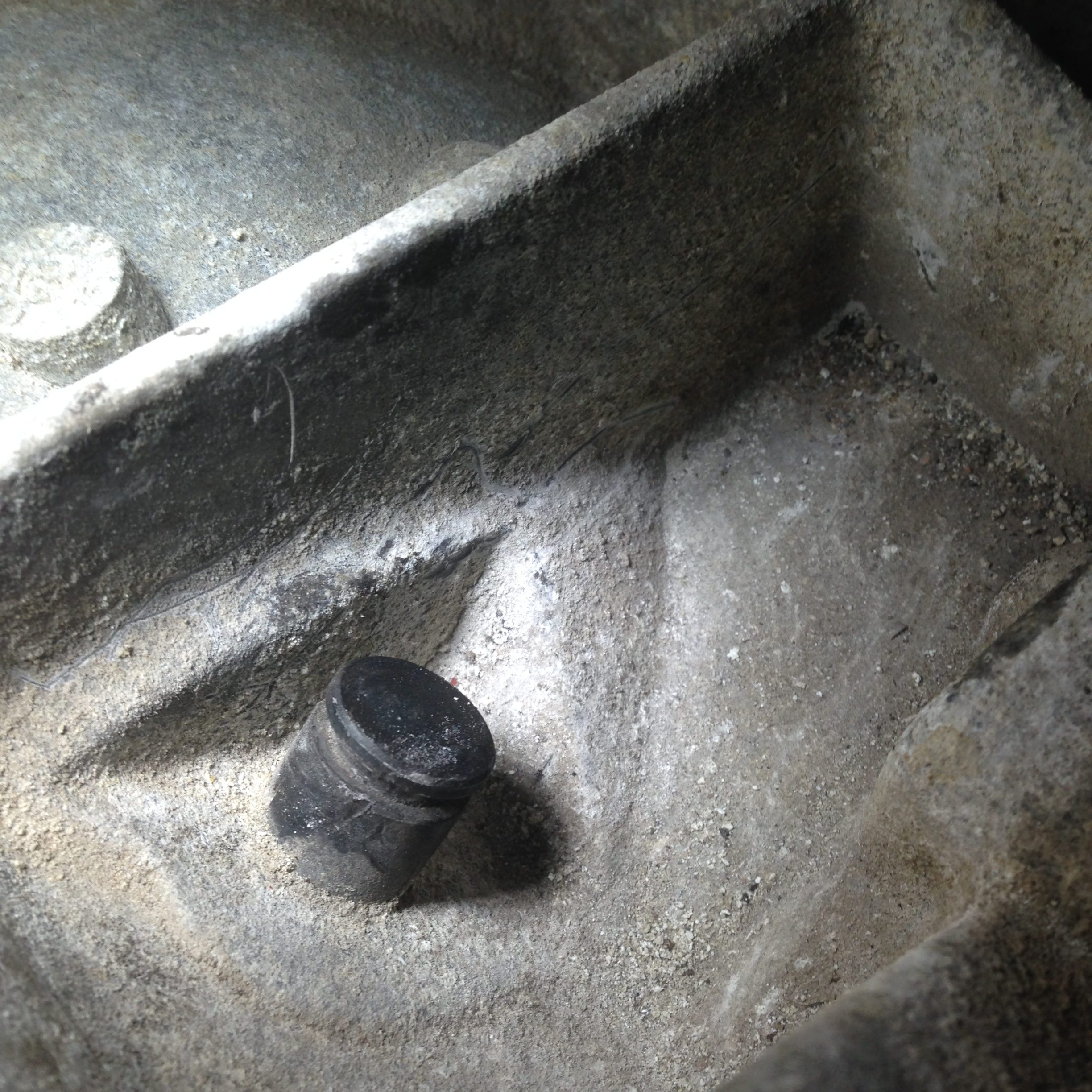

I have made a tool to pull the pivot pin, but when I look at my 'box, the (what I think is the) location for the pin , the pin seems to stand proud already and there is no (M6) thread in it to screw the 55mm bolt into??

OK, got the box out in the end.....
I went down the route of one of the other guys that have posted on here and undid the x6 allen bolts that hold the clutch cover to the flywheel, through the square inspection hole on the underside of the bell housing.
This meant that the 'box and clutch assembly came out together.
I had to cut a small part off the 6mm allen key that I used to enable access.
x2 of the bolts rounded internally and I ended up starting them by knocking them round with a chisel.

Late Update, lol. After finding some pictures on my mobile reminded me to come back and report back.
There was some gear oil residue in the bell housing so I took it to a gearbox specialist to take a look at it.
While it was there they drilled the casing to the pivot pin can be drifted out in the future should the need arise (fingers crossed not) .
Pictures available
It says give the clutch arm a firm smack to get the release bearing to engage.
Me and a mate had to get half a trolley jack handle behind it to get it engage, there just isn't the room to swing a good sized hammer around.
After much swearing there was a small click and it was in.
