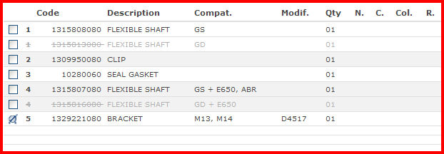

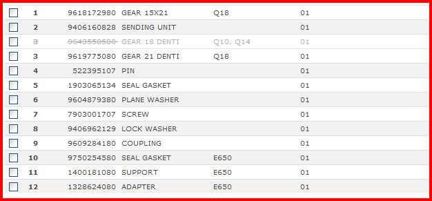

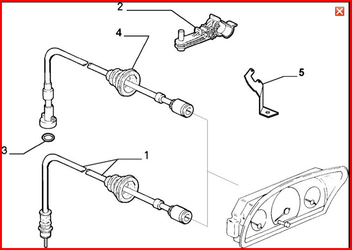

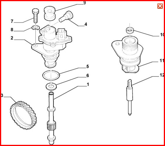

Think I may have found some of the parts required. (See below) or maybe above
Using your VIN In Eper Rel 68
PE - DUCATO'94 DIESEL (1994-2002)
232.656.1.0 - FURGONE G.V.2800 JTD 18Q FIANC.ALTA PASS LUNGO
Engine: 3546919 Vehicle: 00000000 Prod. date: 5/1/2002
Using your VIN zfa23000006226407 this is the info that my ePer supplied regarding your speedo related parts.
Our X244 we had was made in late 2002 & had the electronic speedo & the Transducer on the gearbox didn't look like the one in the diagram, it was smaller than that, & could be purchased on eBay. If you remove the transducer be careful of the small washer (6) on the gear shaft & the shaft itself doesn't drop into the Diff :eek: :cry:.
Hope that helps - PM me if need more.
Cheers

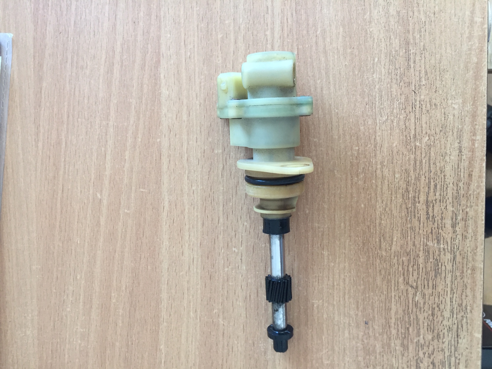

I have the same 2002 vehicle and think that I am looking for the same mechanical speedo transducer! Photo attached of P/N 9406160828.
I can’t find one anywhere! It was only used in 2002 with the 1st hydraulic operated MLGU Clutch before changing to electronic speedo and transducer in 2003.

From the diagrams that you were providing with it looks like the metal pin and cog could be stripped out and maybe fit a different transducer part?
