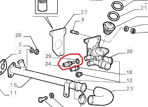

I've looked on eper, and can see what looks like 2 holes in the side of the thermostat for 2 separate sensors, however mine only has one of the holes populated with a sensor, which i think is something like https://coastalmotorhomes.co.uk/fia...lay-coolant-temp-sender-sensor-504127558.html.
The one circled in this picture isn't there, but I also cant see a cable anywhere that would connect to it so could be a red herring

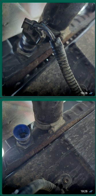

Is that this little thing?

I struggled there , till i realised it was upside down . Yes mate that's the thing and as you can see , it's blue . Your first picture also shows the three wires , they run up to a little black box , on the right hand fan shroud . That's where your relays are .

Are these the switches i need?
Yeah that the one , first one , even has the temps listed for ya . See what i mean , at that price they simply ent worth the hassle .
