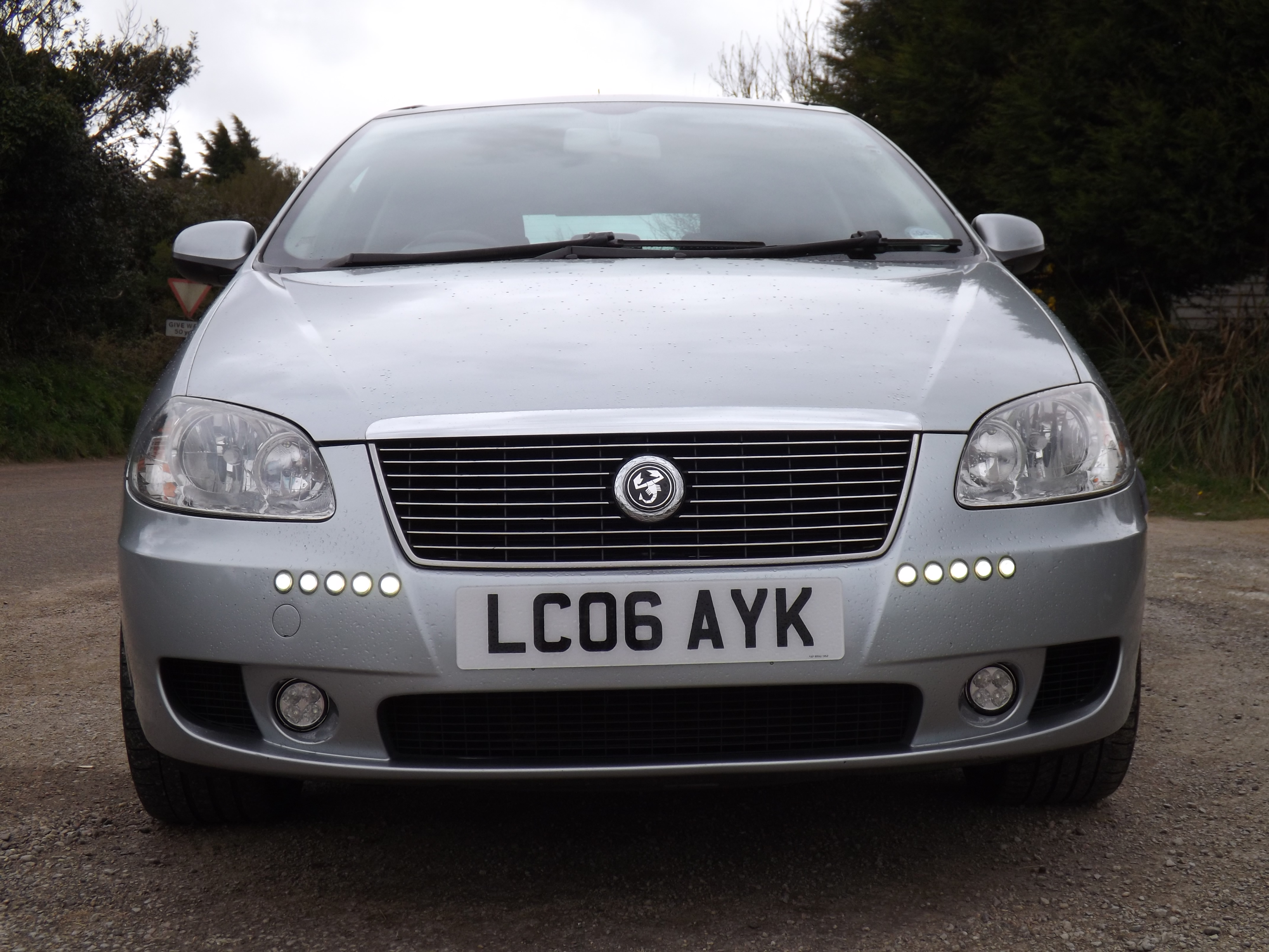

Hello there, was looking at fitting Daytime running lights to my 2006 Croma, was wondering if anyone else had done this, I have the round fog lights on mine so was thinking the DRL's would go above/below these. Anyway any ideas or if you have fitted these please let me know, or upload photo's Thanks.
Hi, I fitted a more permanent set up, because I wanted an OEM look. It involved drilling the bumper, but I think it was worth it. (y)

Hi halison,
That looks like quite a neat job!
Did you fit an additional switch anywhere?

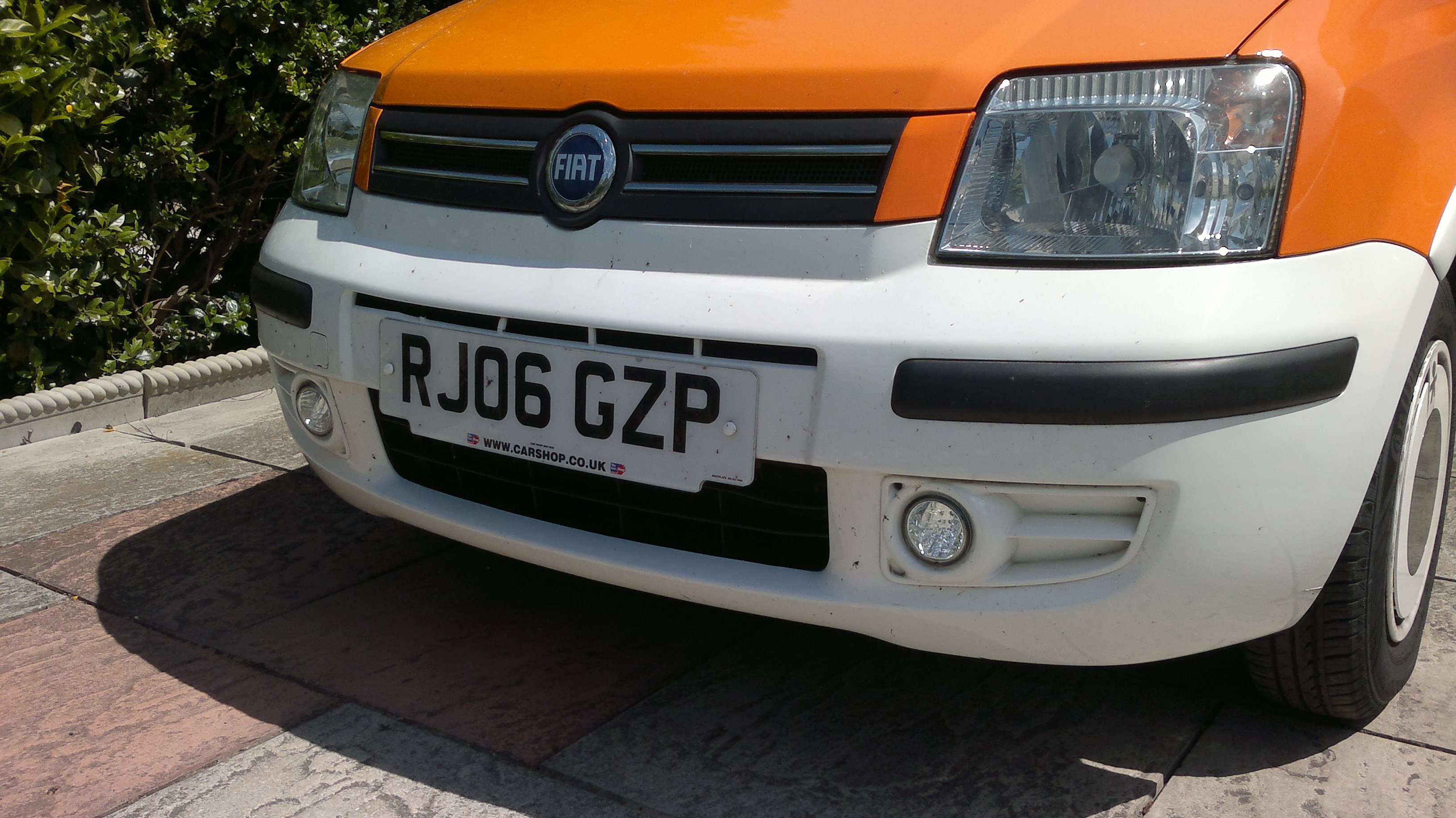

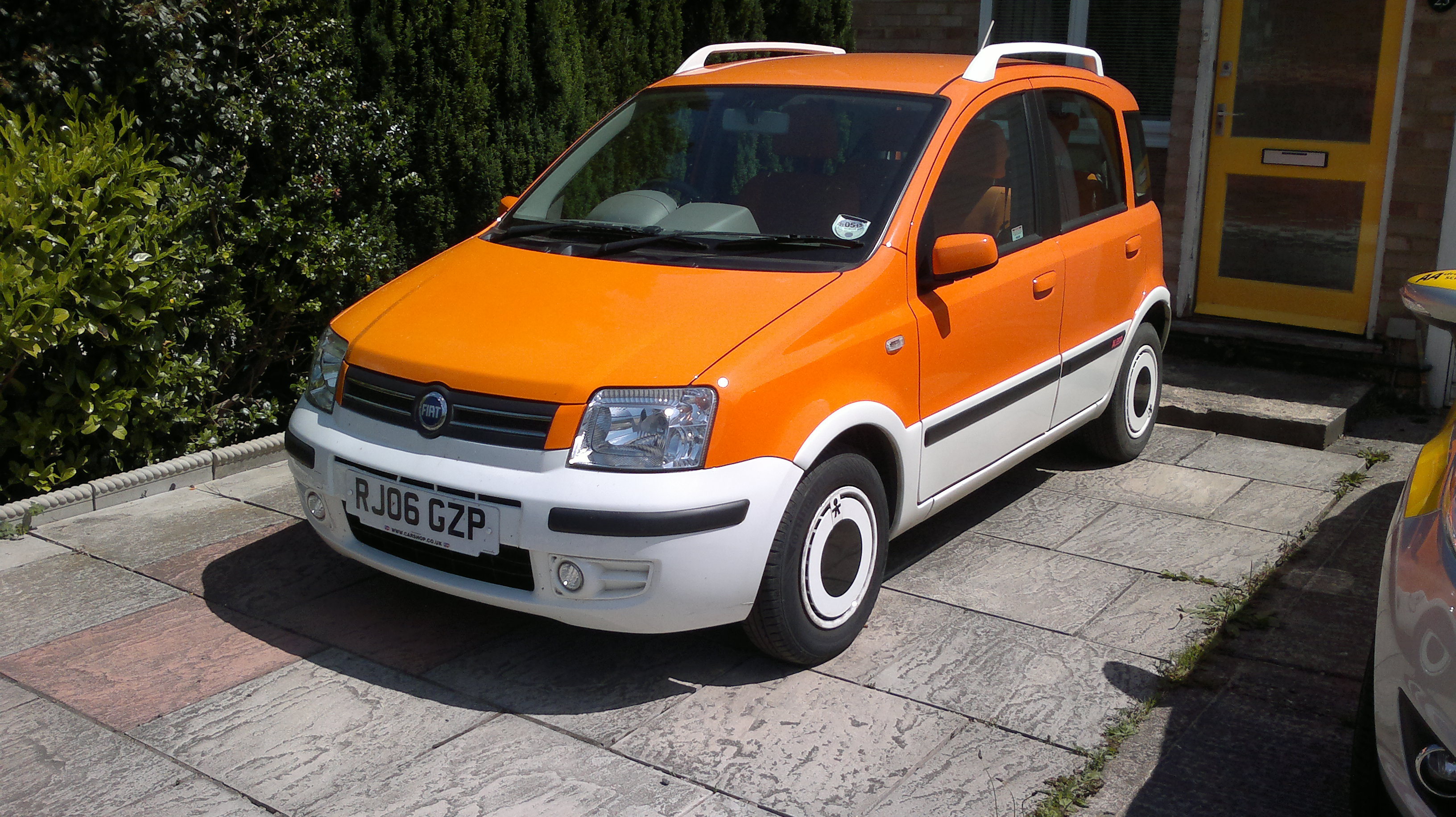

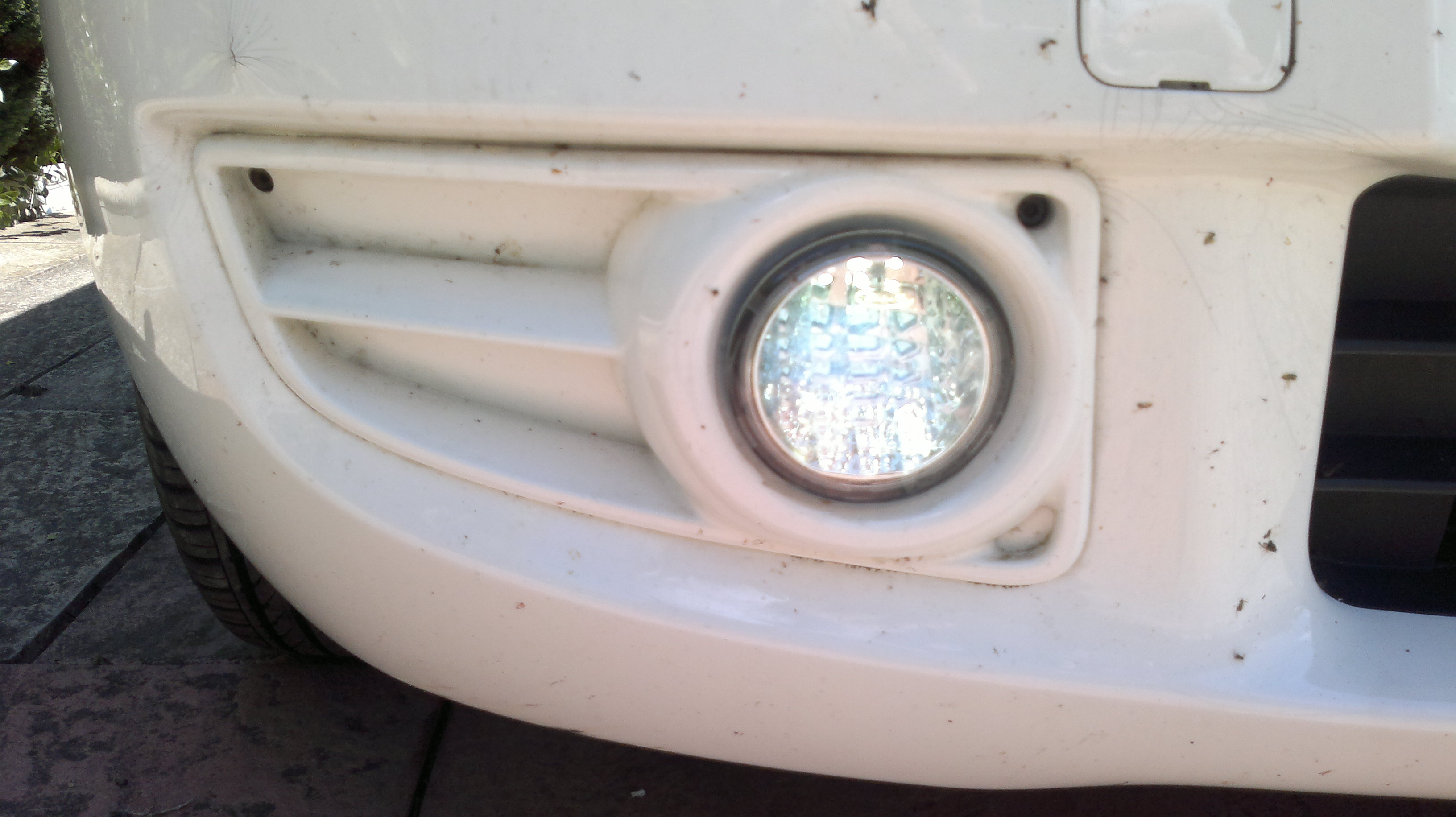

I've never found fog lights to be useful, so have fitted round DRLs in place of the foglights on my 06 Panda. These are Ring BRL0402. Very few people will realise they are not original.
They are about 75mm diameter, so fit with a tiny gap around them in the Panda fogholes. The Panda mountings in the bumper have a flat surface below the lamp. I cut a piece of 12mm thick plywood to fit onto this and the DRLs mounted onto this.
These cost about £70, but an be found a bit cheaper if you search the web. I think I got mine from Amazon. Beware non E marked lamps.
Got a rock through one foglight. Never found foglights much use, but didn't wish to run around with a broken one.
As I was planning and fitting them, I intended to take pics and write it up to load on here. Then time pressed and weather deteriorated so I just fitted them. I do feel guilty, so may one day remove one to write the guide as I should have done.
The wiring is fairly simple, one earth, one permanent live direct from battery and a signal from the sidelight. They appear to have some electronics inside that measures battery voltage, so they know when the engine is running. Then when sidelights are illuminated, they dim. I wanted to be able to have them on with side and tail lights, so attached the signal wire to the dipped beam. As the Panda has a single bulb, they dim on dipped beam and go bright again on main beam, Quite comical, but should not be an issue.
Some pics attached. Camera on phone, attached to rubbish photographer!
Gap around lamp sealed with clear building sealant, keeps the muck out from inside the bumper.

Thanks Brian. They are fully automatic (and 'E' approved MEP)
They came with a relay that turns them on with the ignition and switches them off when the side lights are turned on. I've been running them for about a year now and I am very happy with them. I have also replaced my fog lights with LED ones when one of mine cracked and started to go rusty.
