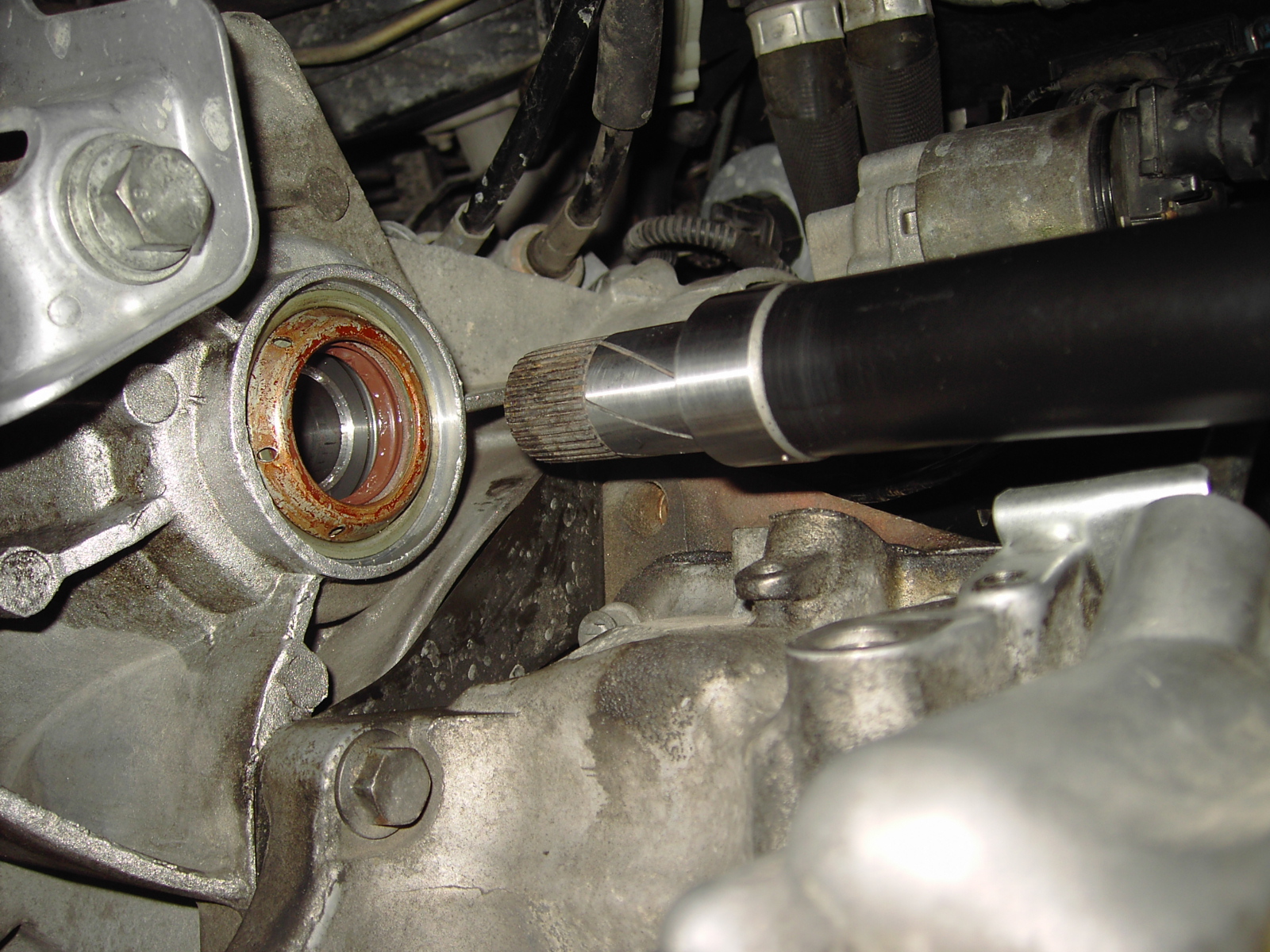

Replaced both of mine when I took the gear box out a few years ago to fit a new clutch and DMF.

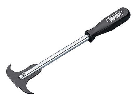

There's no circlip holding the driveshaft in, so it just pulls out. The rubber/plastic seal is bonded to the metal face part and can be levered out with a large flat tipped screw driver or an oil seal removal tool. Be careful not to scratch the oil seal housing in the gearbox. Picture below shows the oil seal fitted.
