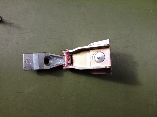

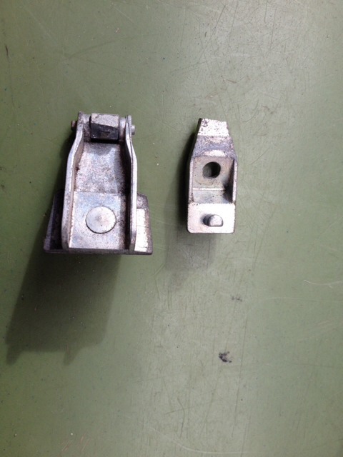

It's not your strength that caused it, it's the fact the hinge pin in the front of the handle seized up and caused the hinge to break. You don't need a new handle, just the repair kit - which is a LOT cheaper.

Many thanks to Marco Venturi for his guide, I've just had to replace the hinge on my passenger door handle.
I'd recommend a few things as well:
Grease the new hinge before you put it in.ImageUploadedByFIAT Forum1379771572.116113.jpg

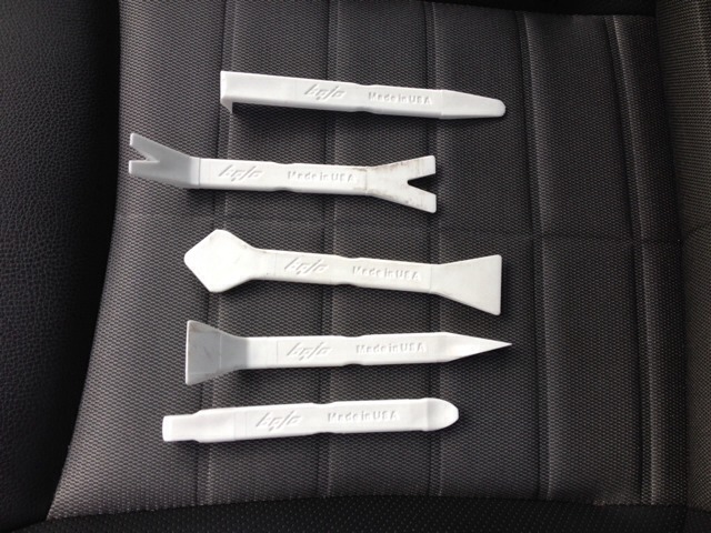

And use proper tools to remove the door trim, this is the first time I've used them and the first time I haven't broken a trim clip!

Great guide, used it today. One thing might be easier, unscrew the door handle from inside the door card, 3 little screws, saves you having to pop the pull mechanism apart. Part from dealer was £9 ish inclusive of VAT.
PS, that little screw that holds the door clip on that you're replacing is a bit of a bugger as it's at an angle, bit of perseverance required there :)
