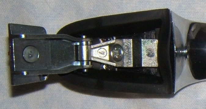

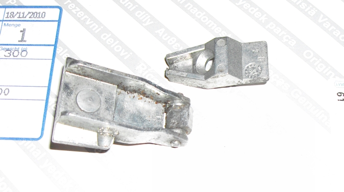

first two attached pictures (taken from Adrian Bravo 's Guide "How to fit Fiat 500 door handles to a Bravo) show "the way it should be" , 3rd what - in my case - causes the "malfunction" :rolleyes:
Mine have not snapped off so far. Though I can see some differences in the broken casting and the ones on my handle, perhaps they where revised.
My hinge moved really freely there did not seem to be any chance of it binding up, and the pin was such a loose fit it would drop out if the hinge was removed from the handle itself.
