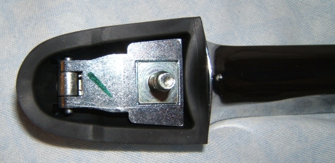

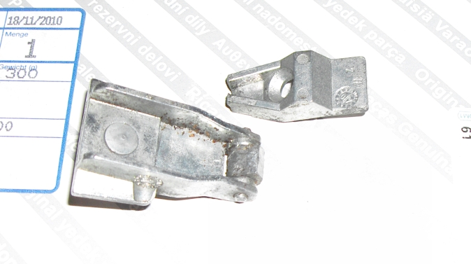

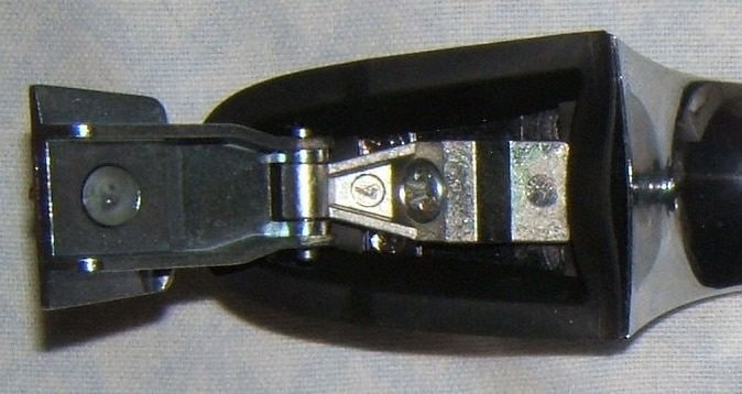

first two attached pictures (taken from Adrian Bravo 's Guide "How to fit Fiat 500 door handles to a Bravo) show "the way it should be" , 3rd what - in my case - causes the "malfunction" :rolleyes:
Looks to me as though some preventative maintenance in the form of a spot of lubricant on the pin might extend the life of these hinges.
I am not even a pimple on the elephant's backside of your meachanical knowledge, but does it look like that? The picture seems (to me) to show that the metal hinge itself has failed rather than the pin being worn.
I'm not sure I see that lubricating the pin would make any difference?
Depends if the pin was seized which then caused the hinge to break.
From my position of ignorant stupidity I wouldn't think that a seized pin would cause the much bigger piece of metal to break - rather the narrow pin.
Like if I glue an egg bewteen two bricks and then pull, the egg will break before the one of the bricks will. But here, it is one of the bricks that has broken.
Yes, it's the hinge which has actually failed. But if the pin isn't lubricated, the extra friction puts additional stress on the hinge, which eventually fractures due to metal fatigue. If the two parts of the hinge are perfectly free to turn on the pin, then there shouldn't be any stress on the part of the hinge that's failed.
Think of it like a door that's stiff to open & close, which becomes much freer once you've put a dab of oil on the hinges.
