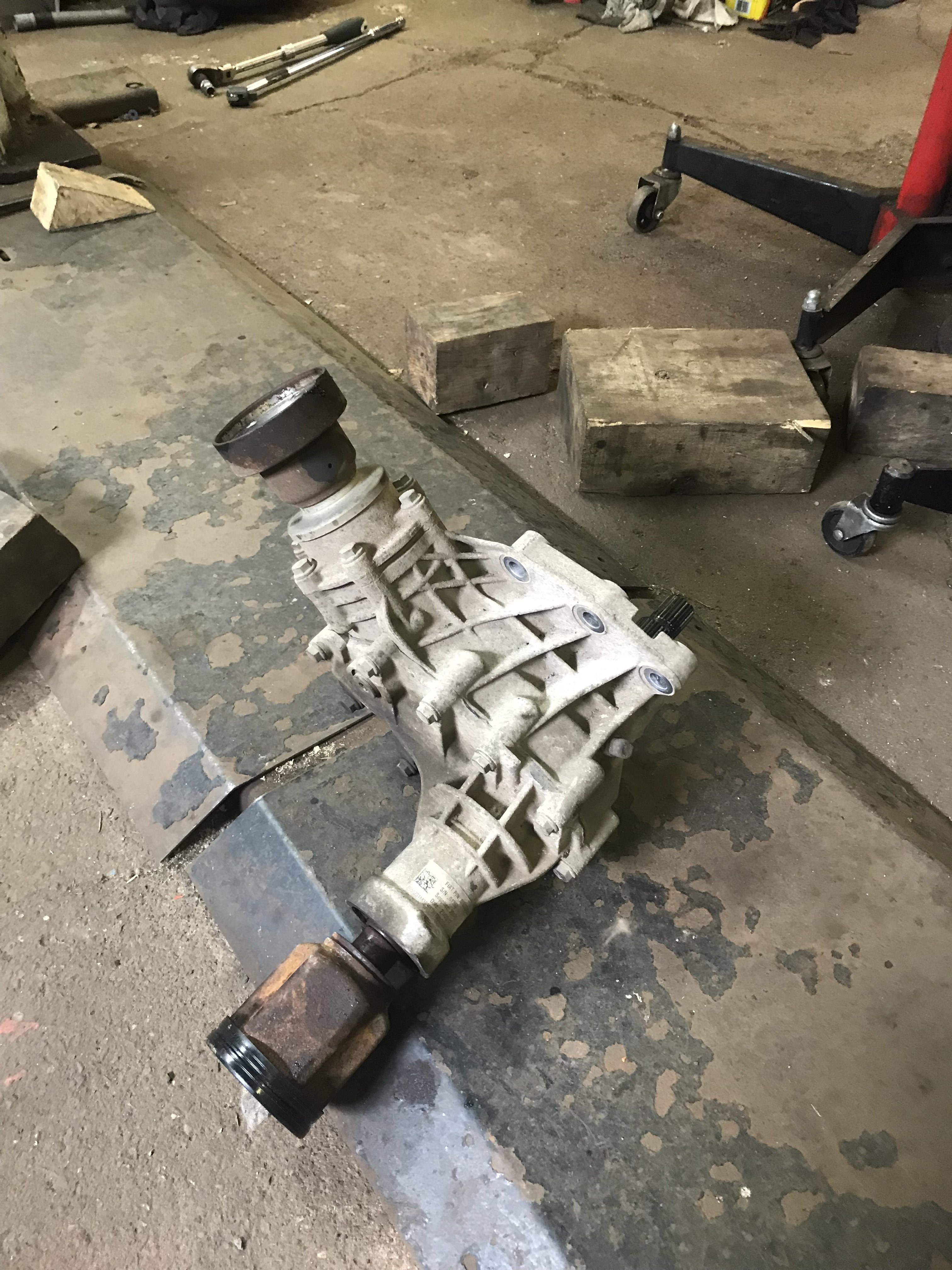

W WitleyPanda Member Joined Nov 1, 2016 Messages 322 Points 138 Tuesday at 12:38 PM #1 So the one drive shaft did not come out of the transfer box. We split the inner joint. Now need to repack with grease. Owner manual states Tutela star 700, which is a NGLI 0-1 grease. Not found any in the UK? Any suggestions? Model 4x4 Year 2012 Mileage 120000 Attachments IMG_5707.jpeg 1.7 MB · Views: 6
