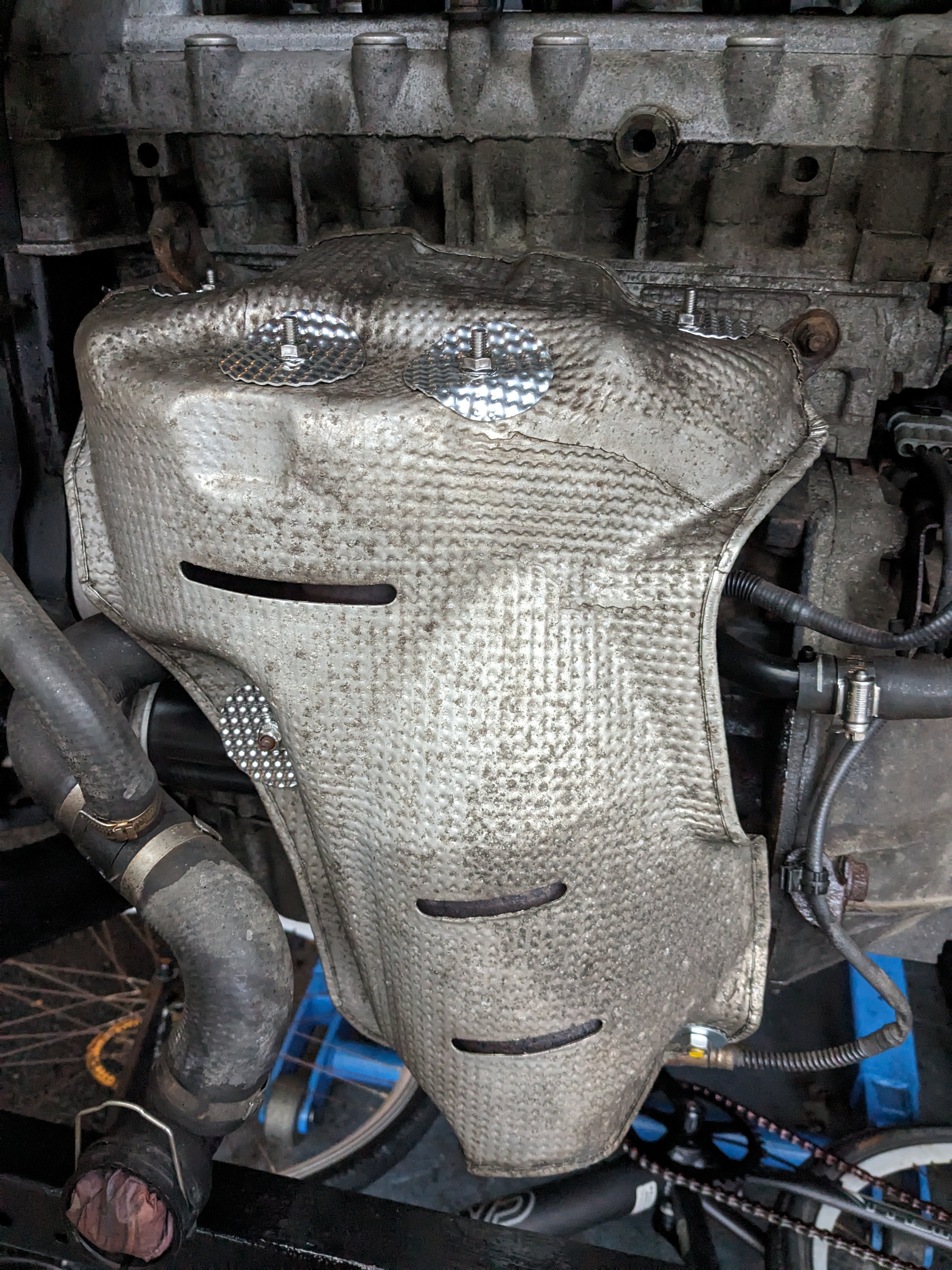

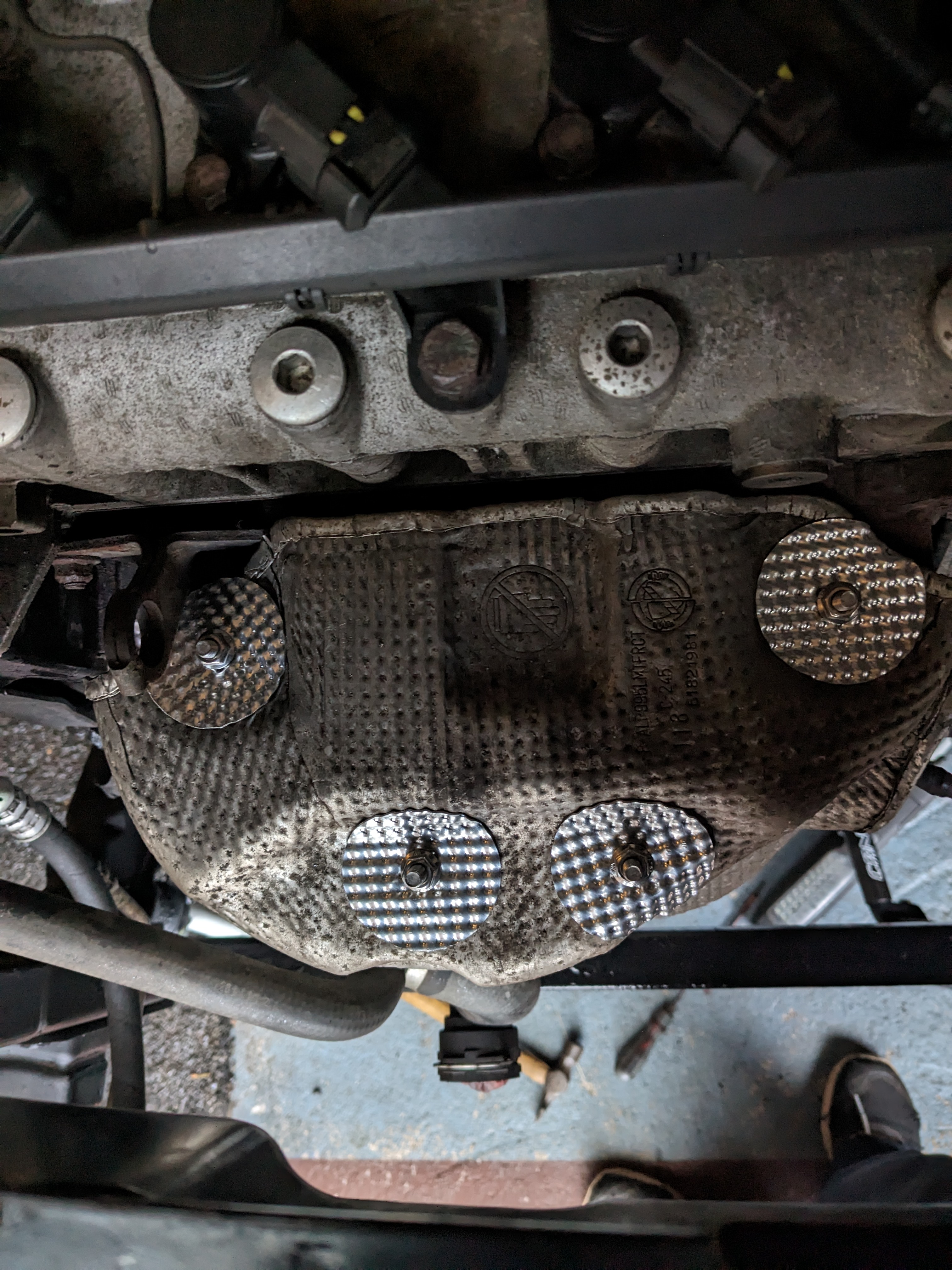

Found a new shield cost about £80 plus delivery 😭. So ordered the repair kit and got some exhaust repair tape in my garage. Thanks Terry for the idea.
"Cat cover" and "cat protection" are sometimes used in description instead of heat shield if anyone's interested 😉.
