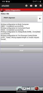

In AlfaOBD I then edited car configuration by only adding TPMS module there.
At proxy alignment I've got an error on TPMS module "Writing configuration to Tire Pressure Control Node (CPP)...Failed. Wrong request length or Invalid request format."
After proxy I've got TPMS warning icon (constantly flashing) on the instrument cluster and an extra page where tire info is supposed to be except it was all empty.

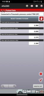

At the same time I can see correct(-ish) pressures in either monitoring or Read System Status info when reading TPMS module.

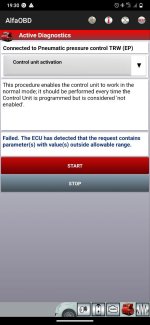

Using "Control unit activation" in active diagnostics section reports an error: "Failed. The ECU has detected that the request contains parameter(s) with value(s) outside allowable range."
