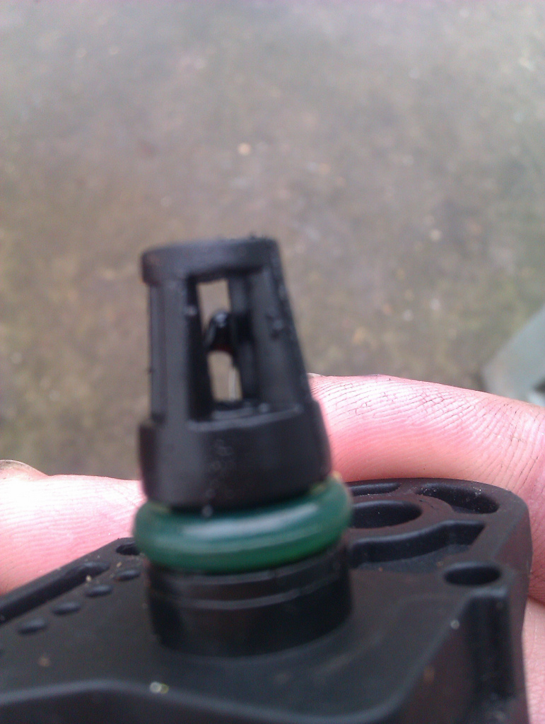

this is the one i got for mine from them a couple of years ago..............
the thermasistor is black

Thats what mine look like?
dont know if its the same as yours (thermistor is black maybe?)
