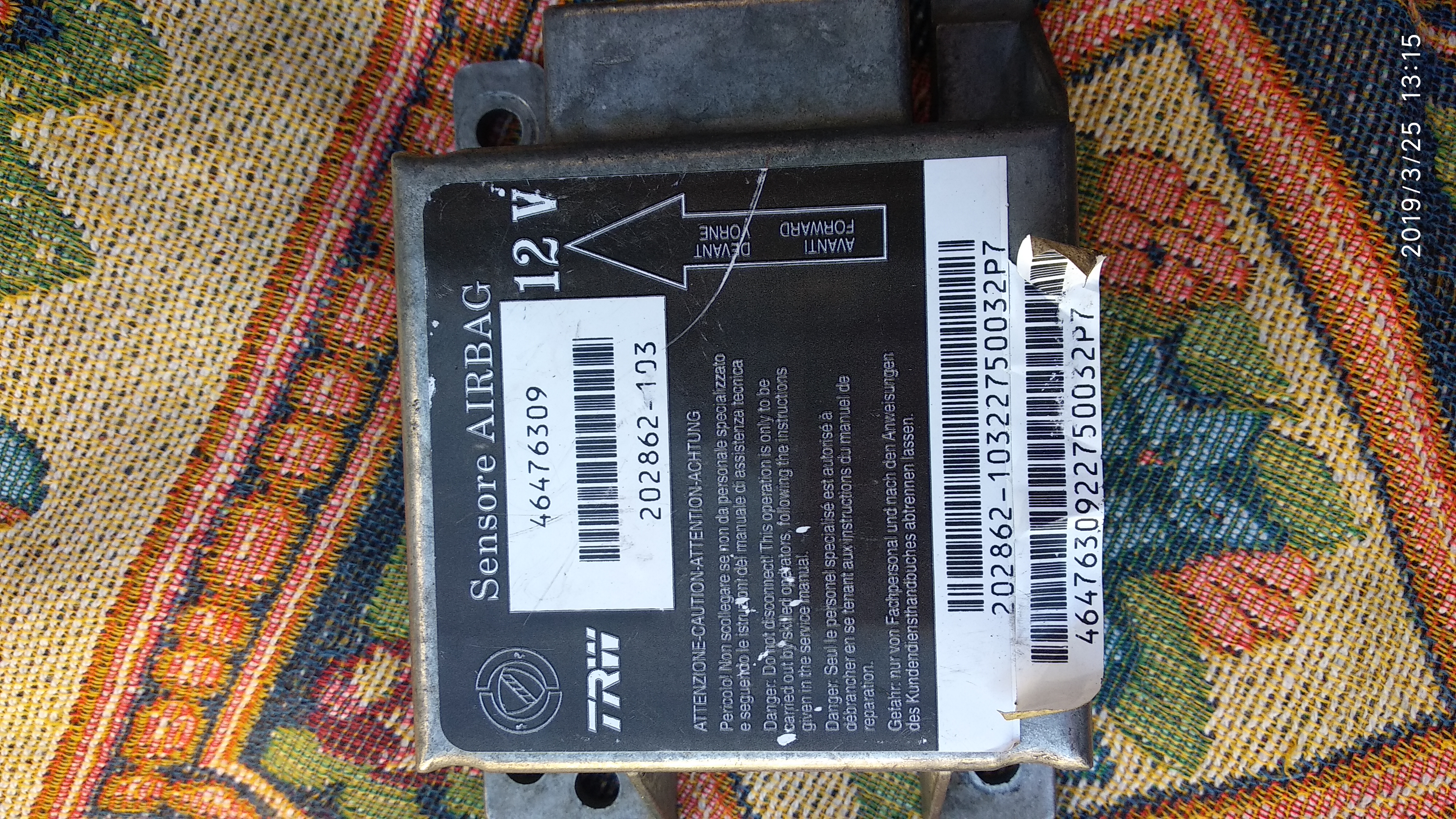

i have a 2001 barchetta !! airbag ecu is trw 46535343
but have you connected with the airbag ecu? What cables do you have exactly? Could you send the link of the cable model that you bought? My B 1995 trw

can someone give me data on voltages and resistances to be able to check the airbag ecu?

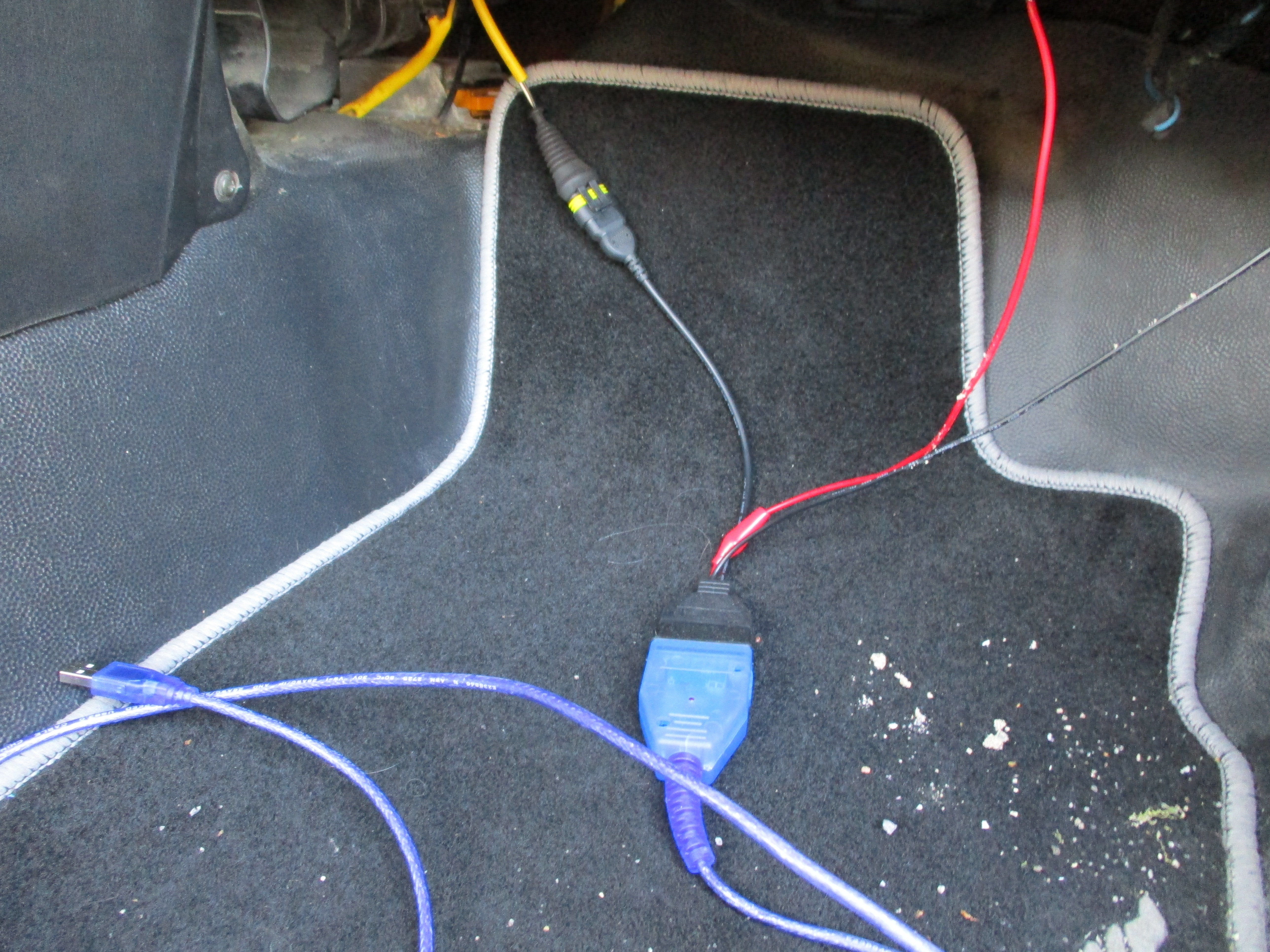

Attached picture of current set-up. A friend did it for me as I am hopeless at anything practical. Does it look o.k.?

There are 3 variants I believe and the 95 probably does not have an OBD connector, there is a connection below the gloce compartment that you can shortcircuit in a specific way to get the error messages removed. I have not tried this and neither has the person who told me about this.
The resistors I believe should be between 2 and 2.2 Ohm (which seems low to me but I fairly recently read this - apparently FIAT used it when a B was prepared for passenger airbag but not fitted with one).
