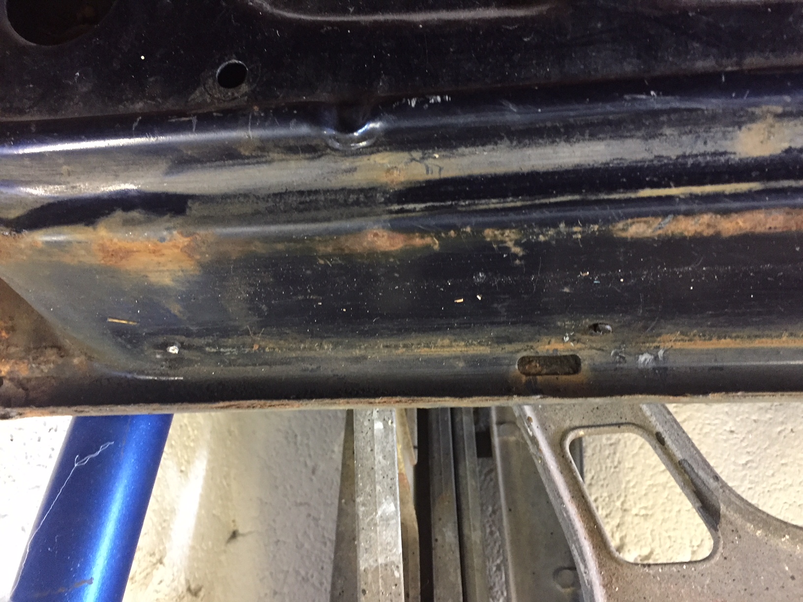

Remembered to look at this earlier. Removed the seal - rivet each end and 5-6 christmas tree fasteners along the length. Removal of the strip reveals that there are 3 oblong drain holes - see photos.
If yours have none, then it could be an earlier model (mine is '89 GF, and this door is also from a GF) and were not there when it left the factory, or the door bottom/skin has been replaced and the holes were either not in the repair section and/or not added by the repairer.

The pictures are a great help. I can locate one drain on the drivers side, having taken the Christmas tree clips out. The passenger side has been pop riveted in place throughout so they will have to come out. Now drilled out and see that there are no drains on the passenger side as you forewarned.
I am contemplating drilling out some more drain holes on the door underside and hidden by the trim; any thoughts on the wisdom or efficacy of this? My worry is that i just let the water sit above the trim and it still does not escape...

On the later cars they came with drain slots in the doors, not sure on the earlier models. Underneath the door card at the back of the door there’s is a dimple and another dimple toward the front of the door. The drain slot towards the rear of the door is directly adjacent to the dimple, it’s hard up against the door skin and behind the bottom water seal and runner.
The front slot is a few inches back from the front dimple. Both doors on my UK ‘88 SE where blocked. I have checked a 1978 car and the dimples are there but no slots so the doors may have been repaired or they where not there from new.
