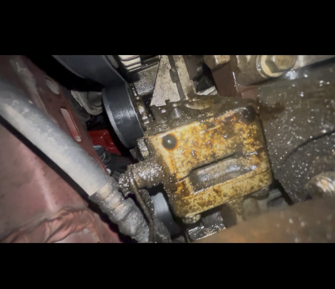

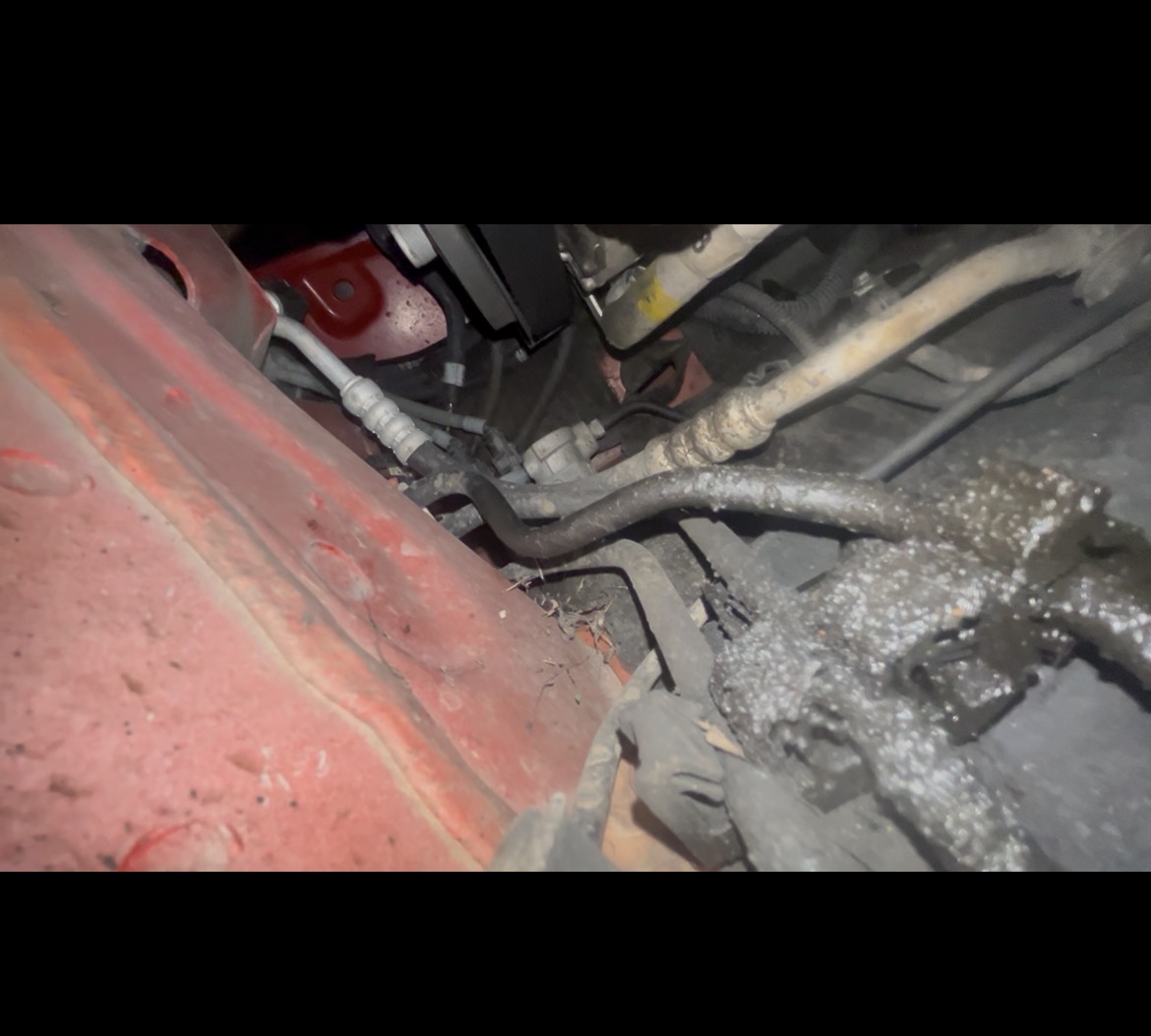

I’ve taken some videos, I’ve been getting oil droplets under motor just spotting thought it was the pcv valve vacuum line to cold air intake, it does have that, but I’m also getting clear fluid spotting aswell

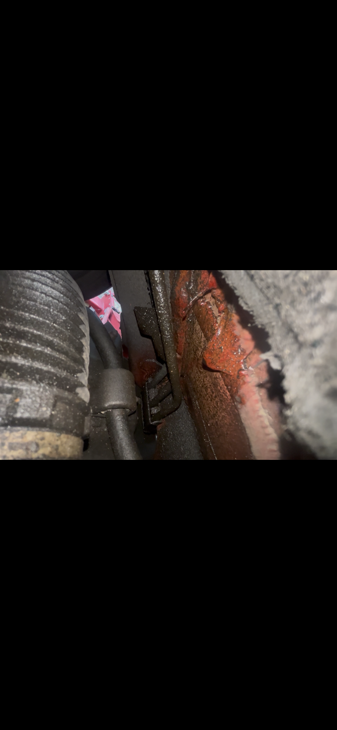

I cannot for the life of me find the condensor drain I’ve check above both side of steering rack boots I’ve looked under the air con pipes going into bulkhead
I’ve got the fluid coming out from under drivers side (rhd) doesn’t seem to be spotting oil today I’ve left a drip tray under the car after a drive (twice today I’ve done this) in the drip tray is just water, I have some screenshots from the video I will upload in not sure where to start if a hose has a leak, will end up dropping her off to a garage if I have to but I would like to complete the work myself any help would be appreciated

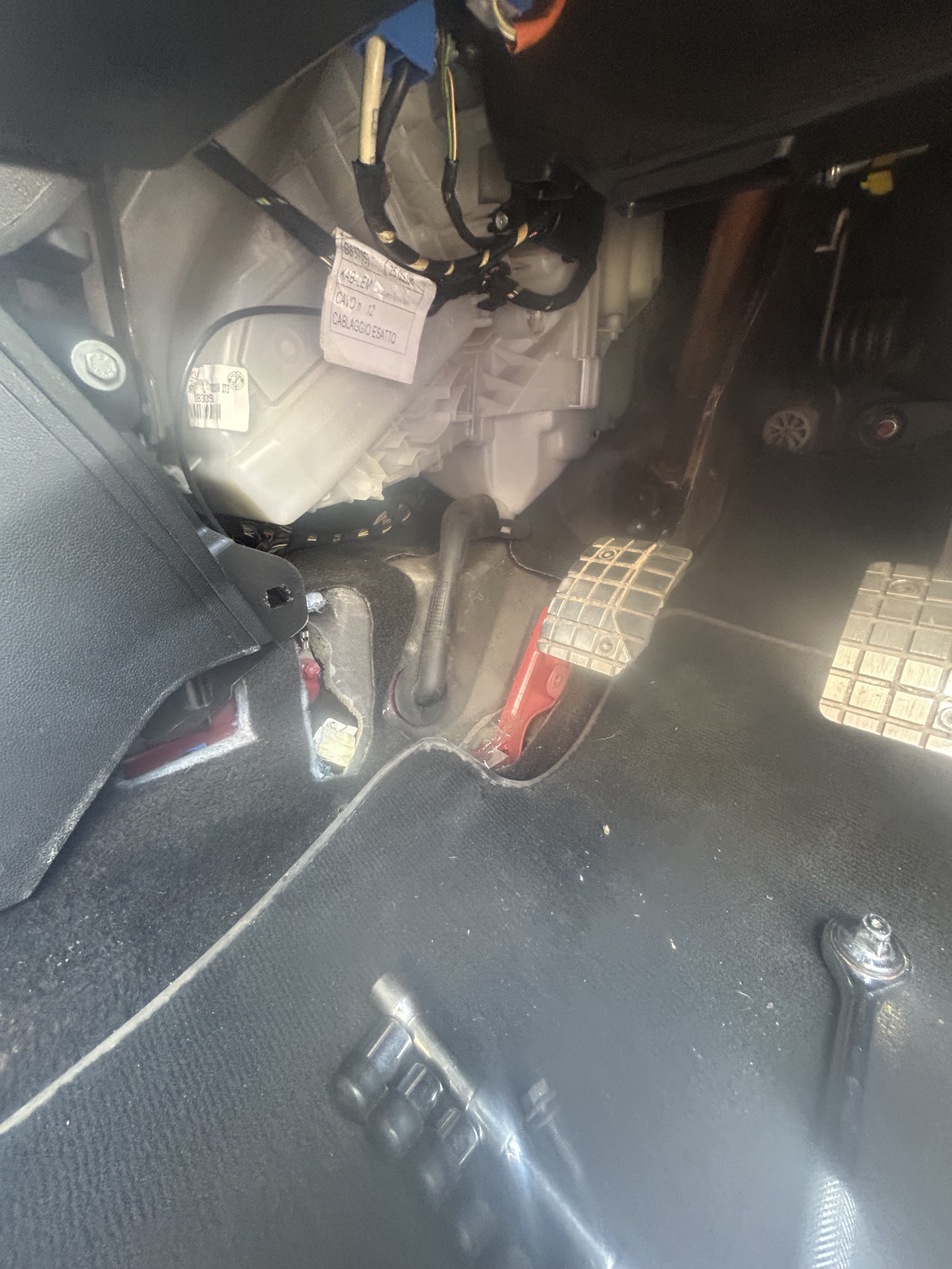

Unsure if it’s the ac lines gone but I can’t find the drain for it and I hear the sloshing inside glove box area so I can assume that’s blocked 55700081 is that part number but can’t seem to find it on my car anywhere

And I’ve found the condenser drain pipe from inside the car
It’s not blocked so I can assume there is a split in a pipe somewhere for this clear liquid to be coming out from under the car
Under the carpets are dry
Still get the water slosh sound from glovebox though
For anyone else struggling it’s a rhd drive model to the left one 10mm bolt

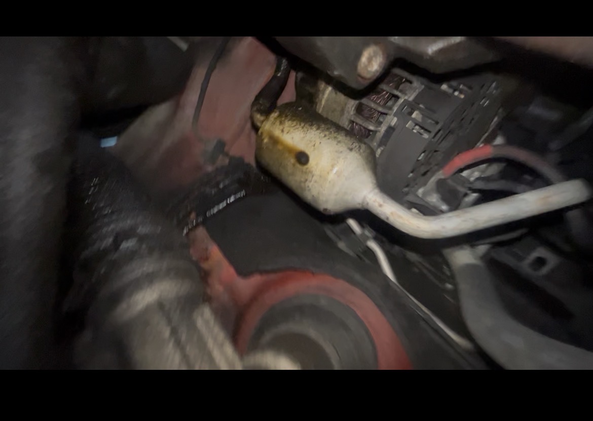

Oil leak is coming from behind the engine mount to the left hand side if facing the engine, more to the back of the engine,
Add a good pic of top of general engine,
Then a more close shot of the leaky area
We are just guessing here.. 🤔
I’ll give it another shot tomorrow I will try and screen shot out of the video I have, I’m going to be looking at the turbo tomorrow anyway fun fun fun 😂

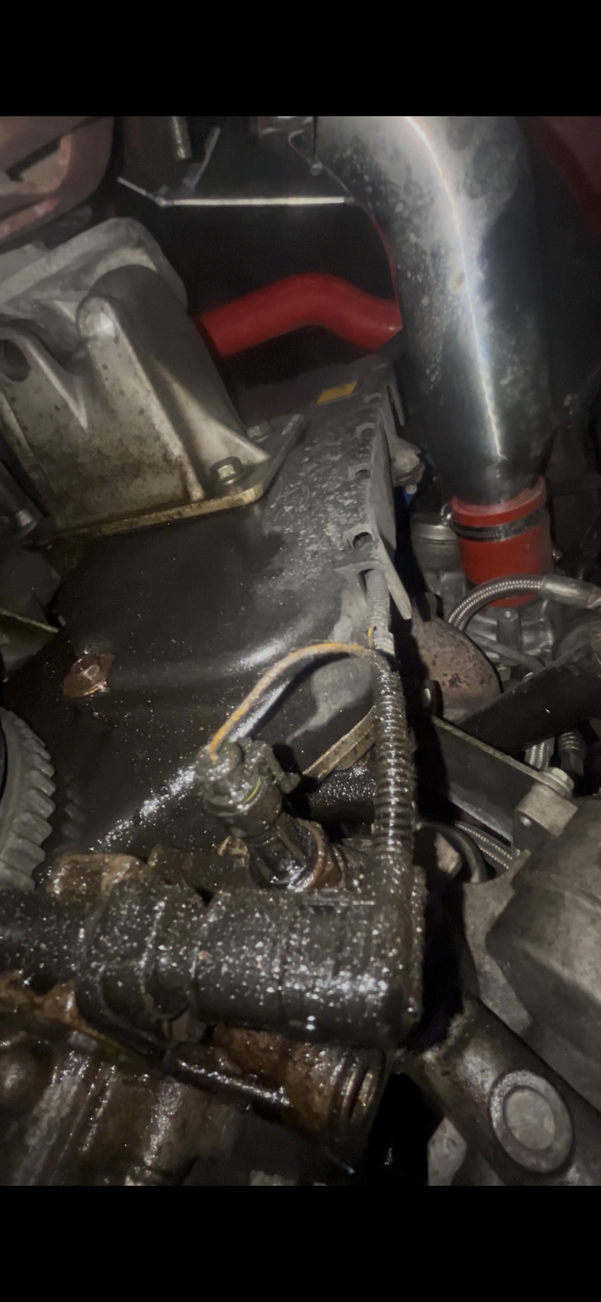

I can’t really get any further having a look I put the best photo I could get on there, everything is dry in the top of the engine it’s around the mount above the alternator, it doesn’t leak from above it. it’s coming from around the firewall side I’ll still try again tomorrow
I’ve had the turbo start leaking oil, brought a replacement and changed it, I thought I would check the oil level and find it hard to get a reading from the stick, unless I’m mistaken it is overfilled and could have caused the oil leak and also the turbo oil leak it recently gained (exhaust side), so I’m just curious if too much oil would get it to leak and maybe out the back of the engine probably rocker gasket area. I’ll be draining the oil and changing it next time I have a chance never was able to get another picture as can’t get near the area.
Pretty sure the leak is coming from the inside of the cambelt cover I took the top half off there’s a thin line all the way round the inside looks like it has been getting flicked around from cambelt, not the camshaft seal with the gear on, spent so many weekends on this, next weekend will be the last then it’s going to a garage and put away. Drives like a dream other than the small spotting on my driveway
