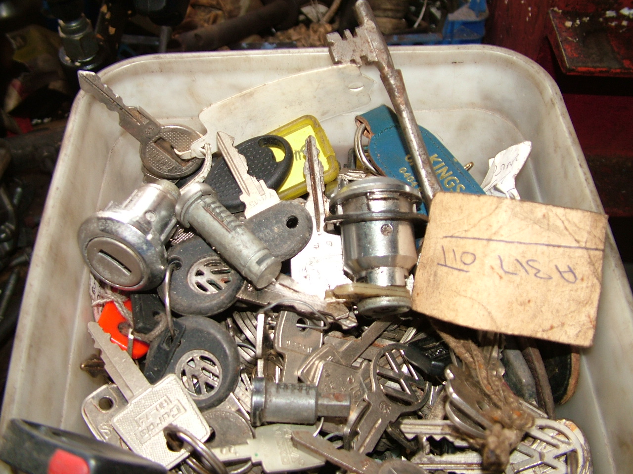

Same here , done that a few times in the past, mostly for door locks. This box has done some work, all legitimate I may add.:)
