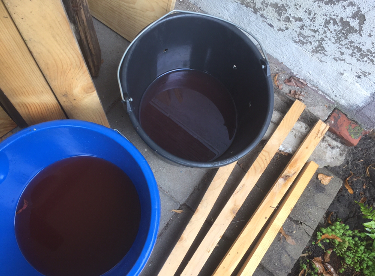

When I drained out the system I filled it up with water and left the cap off and started the car to the point it reached up to 65-70 Celsius (149-158 Fahrenheit), after that I let the engine cool for a small moment to not burning my hands on everything. I repeated this 4 times to get clear water out of the system and then added new (and the right one) coolant. After filling I starter the car and take it up to the point the fan was spinning and carefully after cooling it a bit down let the system escaped the air that was left and filled the last coolant.
Nice satisfying job and low experience needed (just be careful when you take the cap off when the engine is hot while the fan is spinning before, there will be quite some pressure and steam), I would recommend it to every one just to prevent rubbish in the system and protecting the engine. It is extremely low kost and your engine will be thankful afterwards.

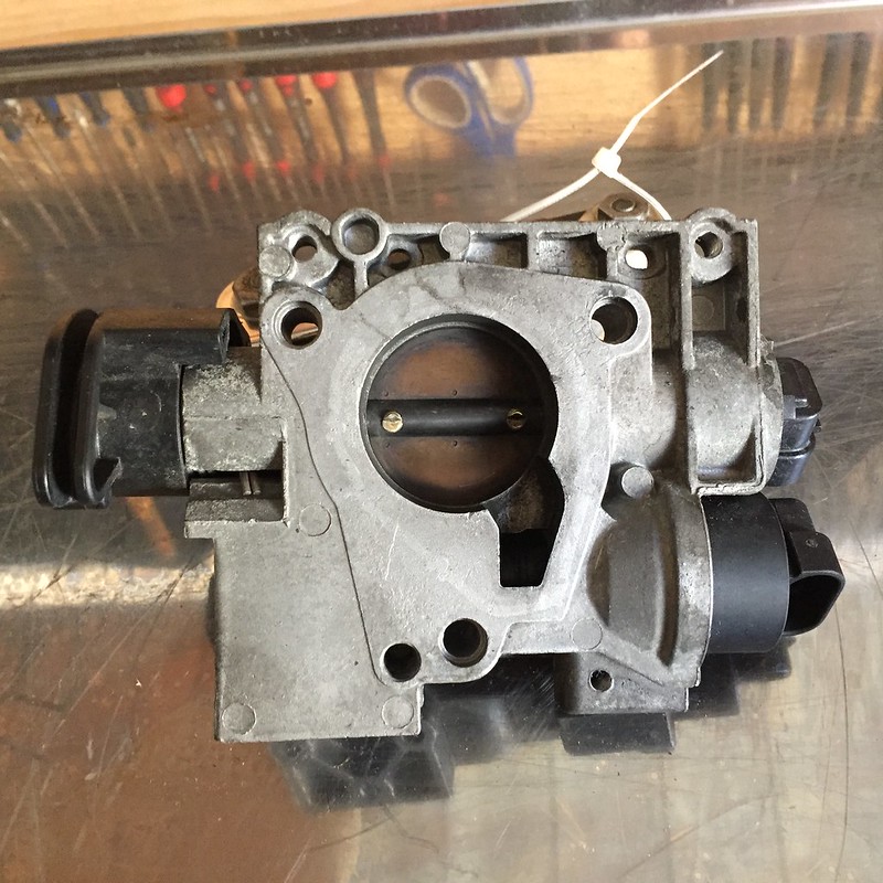

After a few weeks I was experiencing some trotted issues and bad starting, sometimes it was stalling after a ride when the engine was hot and had troubles to restart. After looking on the internet i decided to clean the EGR. The garage was telling me it had to be replaced and it will be a cost of 120 euro's (+/- 100 pound). That was ridicules and I'm testing several garages if I want to do something to see the difference in DIY or garage costs.
I think it is a real easy job: just take the filter of and remove the EGR (always note what you are doing or make pictures). After removal it was just a matter of deep cleaning with break fluid and WD40. After de basic clean I took a toothbrush and air pressure to remove the last dirt. Also, check the connectors (broken cables or something) and clean them when needed. My biggest problem was the side intake (the bending tunnel was almost completely clogged, and with the airgun and a lot of cleaning it was a proper piece of work).
Ones cleaned and replaced the engine was running smooth. So with some home cleaner, break cleaner, WD40 and air pistol the job was done with a cost of almost 0,00 euro/pound. So never trust the garage ;)

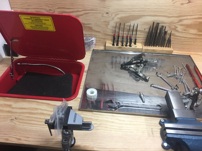

PS: If I don't swap the engine I will trow an other bigger one on it like 46mm for some extra air intake if needed. And also I will be using my cold degreaser in the shed.
