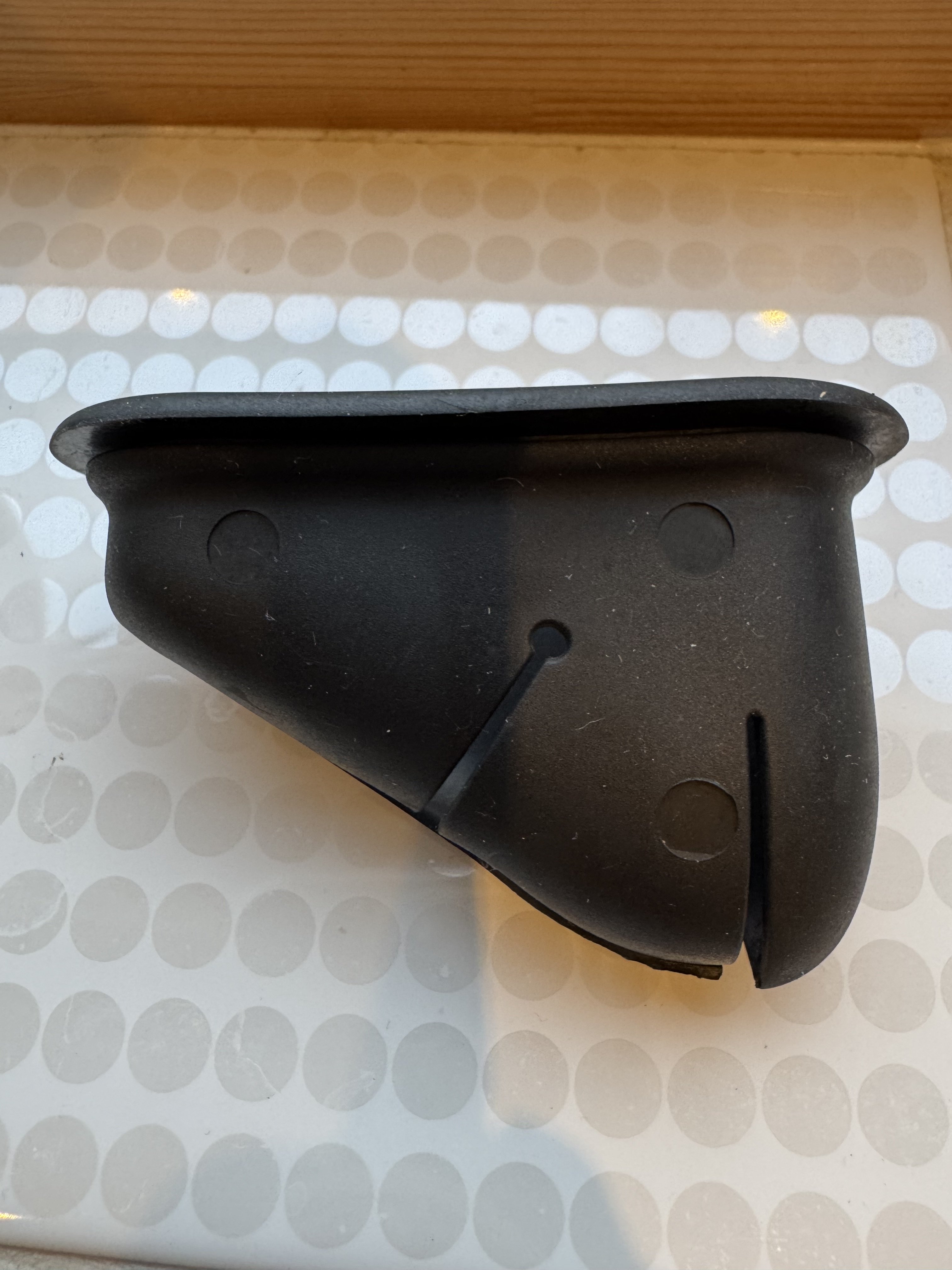

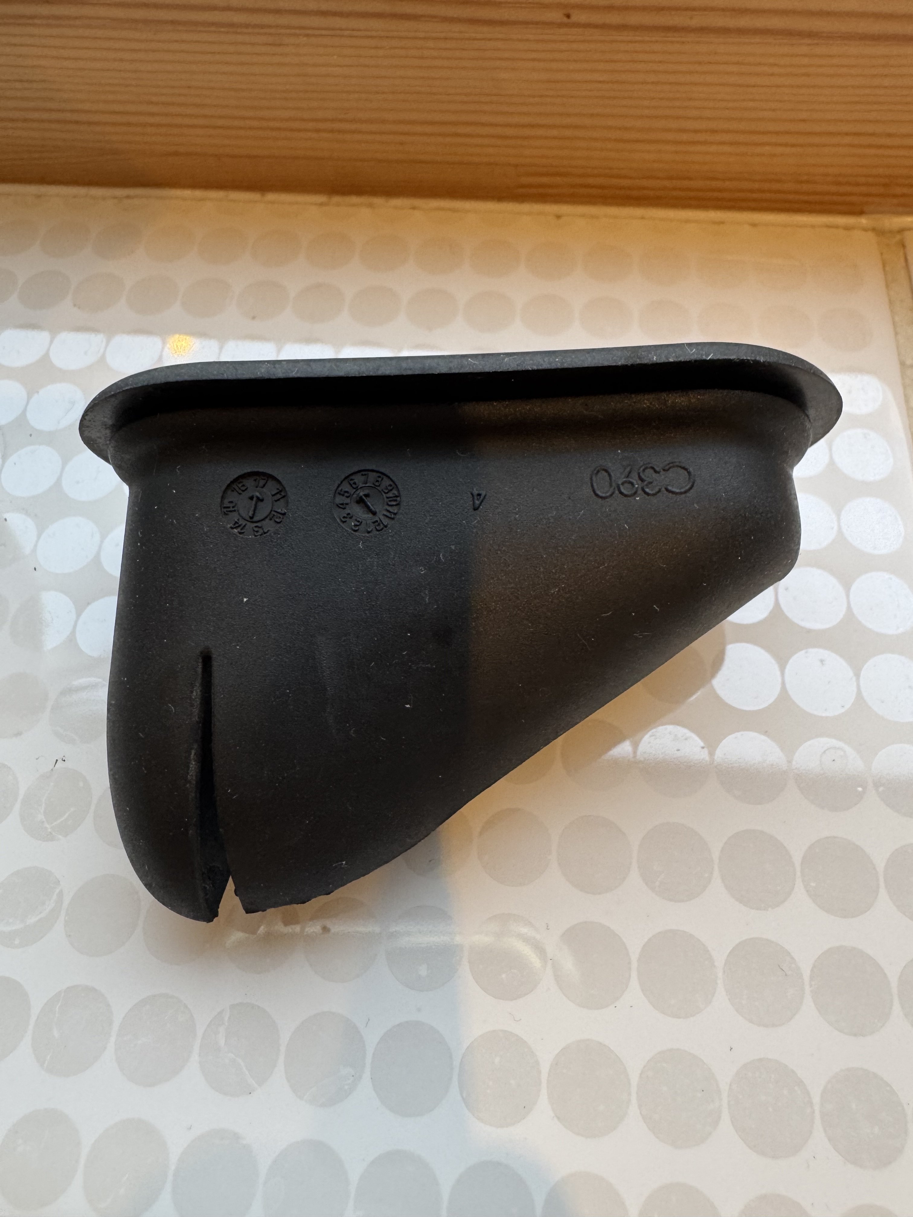

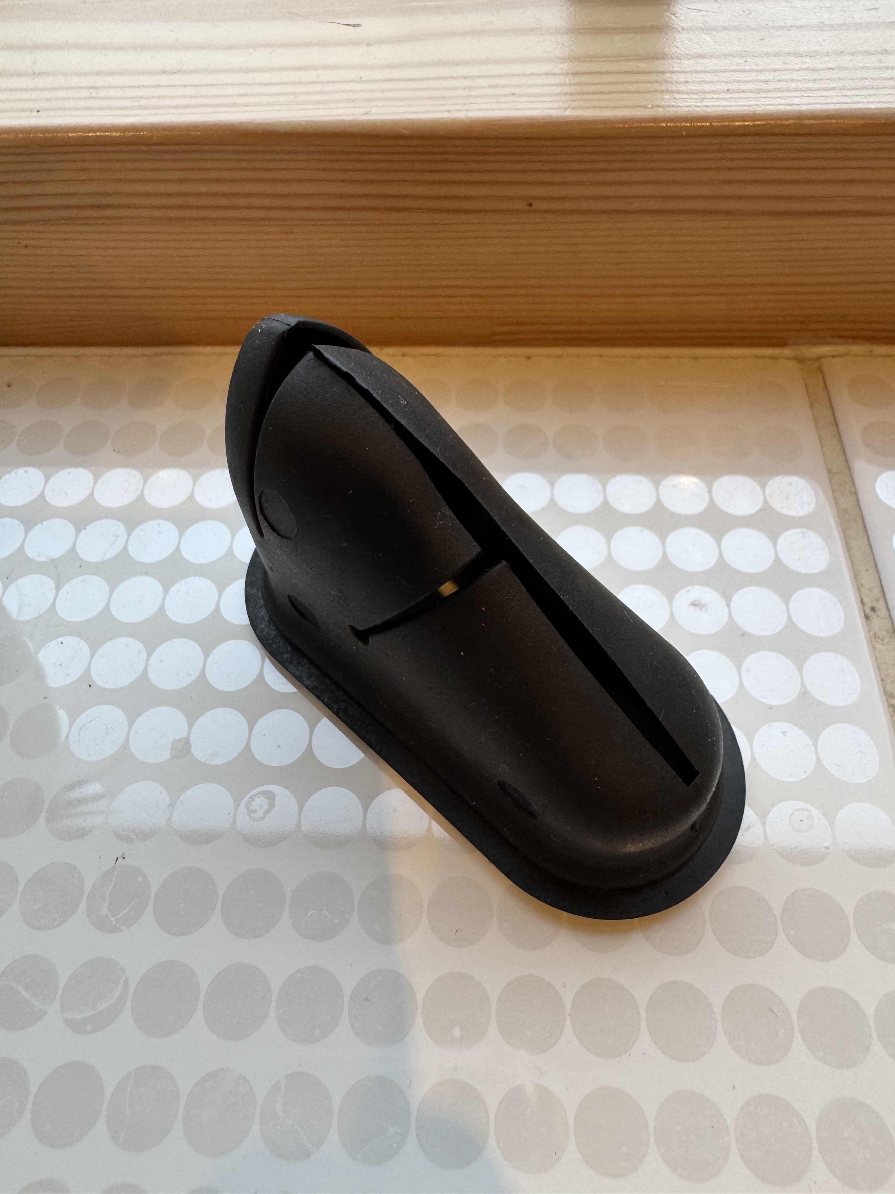

The thing is, they don't seal at all (I have realised, after removing mine in December while cleaning it all out in there). The previous model has a rounded tube with a flattened end, which seals fully if flow goes the wrong way. But on the 319 Panda, they are made with a big slot in them that can never seal up -- see photos of mine. The only function they seem to serve is to guide water that does drain that way so that it doesn't run straight down the bulkhead when stationary. When moving, surely even if the duckbills are there, momentum will push water back to the bulkhead anyway. Most of the leaf material goes in through the vent grille to the bottom left side of the windscreen (right, as you look under the bonnet). With the rubber bits out of the way. I can now flush the scuttle through just by pointing the jet of the hose in through that grille.
That's why I was happy to remove them completely.

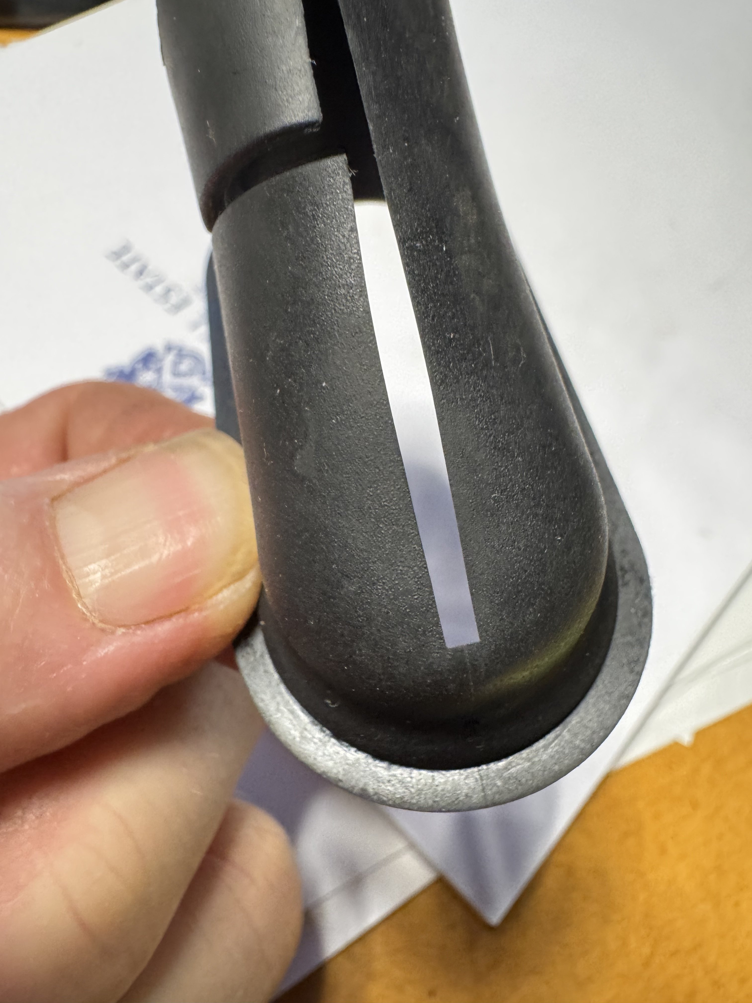

Look at this close-up I’ve just taken. They’re made with a clear 2mm gap up the centre. Yes they could slow airflow- but even without them, there’s a significantly greater free air area provided by the grille below the windscreen so unless that becomes blocked it’s very unlikely that air will be drawn in where the drains are. And anyway, with a car in good nick (no smells under my bonnet) there should be no fumes to come in anyway :)
