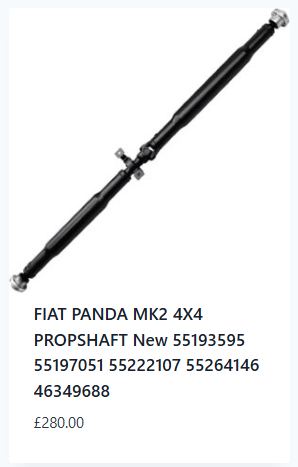

Prop shaft at Des Shelly £280 (I know it says Mk2 but same part numbers) that sounds like an expensive clutch too (I'm guessing, hoping, these are your fitted prices?).
Yes. My centre bearing looks roughish so if the prop is off Ill have it changed now. I must speak to DS on monday. I really want my prop refurbed. Clutch DMF is about 1400 fitted. The Man in Norwich said 6.5hours for straight swap then the other bits on top. Im budgeting £2K to have everyting in sight done at one go. I want full confidence restored. I hope this silences the poorly cow livingin my bell housing.
