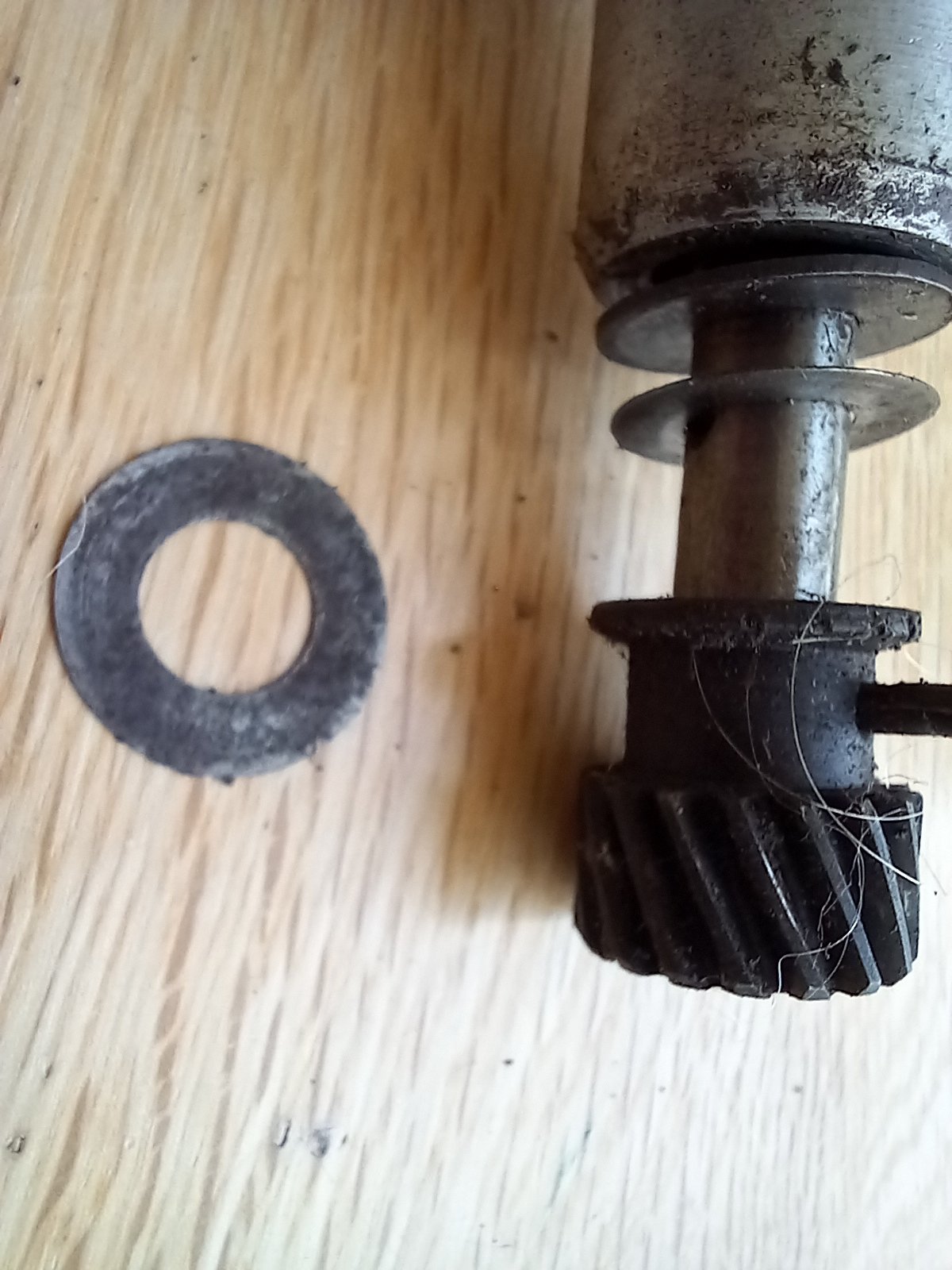

These maybe?
What 'shims' are you needing? As far as I am aware, none of the 500/126 distributors ever required shimming (but I am quite happy to be proved wrong). Is it the 'Nannoplex' ignition system that you have?
Be happy.;)
These maybe?
Thats exactly what I mean
I stand better educated! I have never had to TOTALLY strip a distributor, so have never had to try and find these shims. Why do you require them? You may have to make them yourself out of some very thin steel

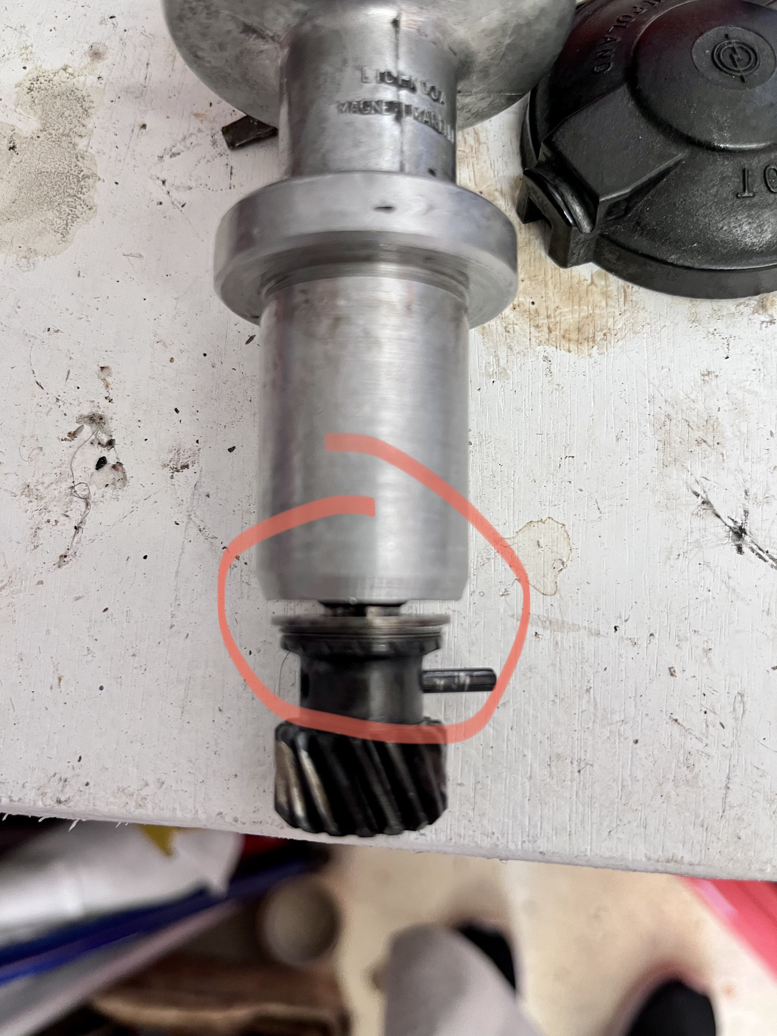

I rebuilt a number of distributors last year just to make sure they were good to go. There is supposed to be a thin thrust type washer inside the distributors against the body which forms a bit of a seal. Of the seven I worked on only one still had a viable thrust washer, most had worn away completely, so I ended up making some from a thin sheet of Tufnol which eliminated the end play.
It’s this end play that concerns me. I have the one inside the body but even with the others circled there is a gap. I’m not sure what gap is acceptable
I can't give you an official measurement, but I would say that something like 0.10mm, or a just discernible amount of play is enough. I had a 123 electronic distributor that was badly assembled sufficient that the rotor arm moved up and down and made contact with the inside of the distributor-cap.
I shimmed it until it was tight and then removed one shim.
