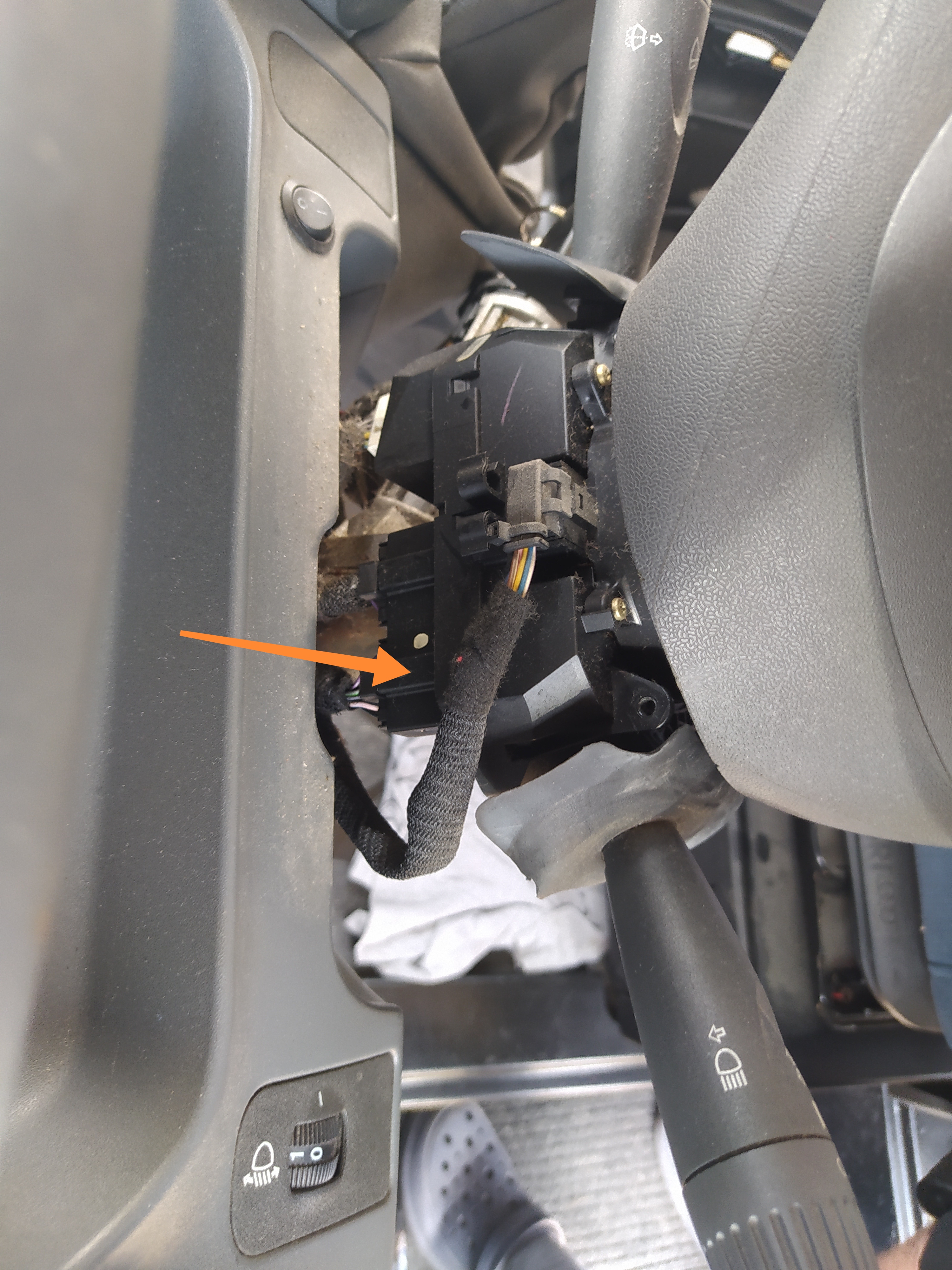

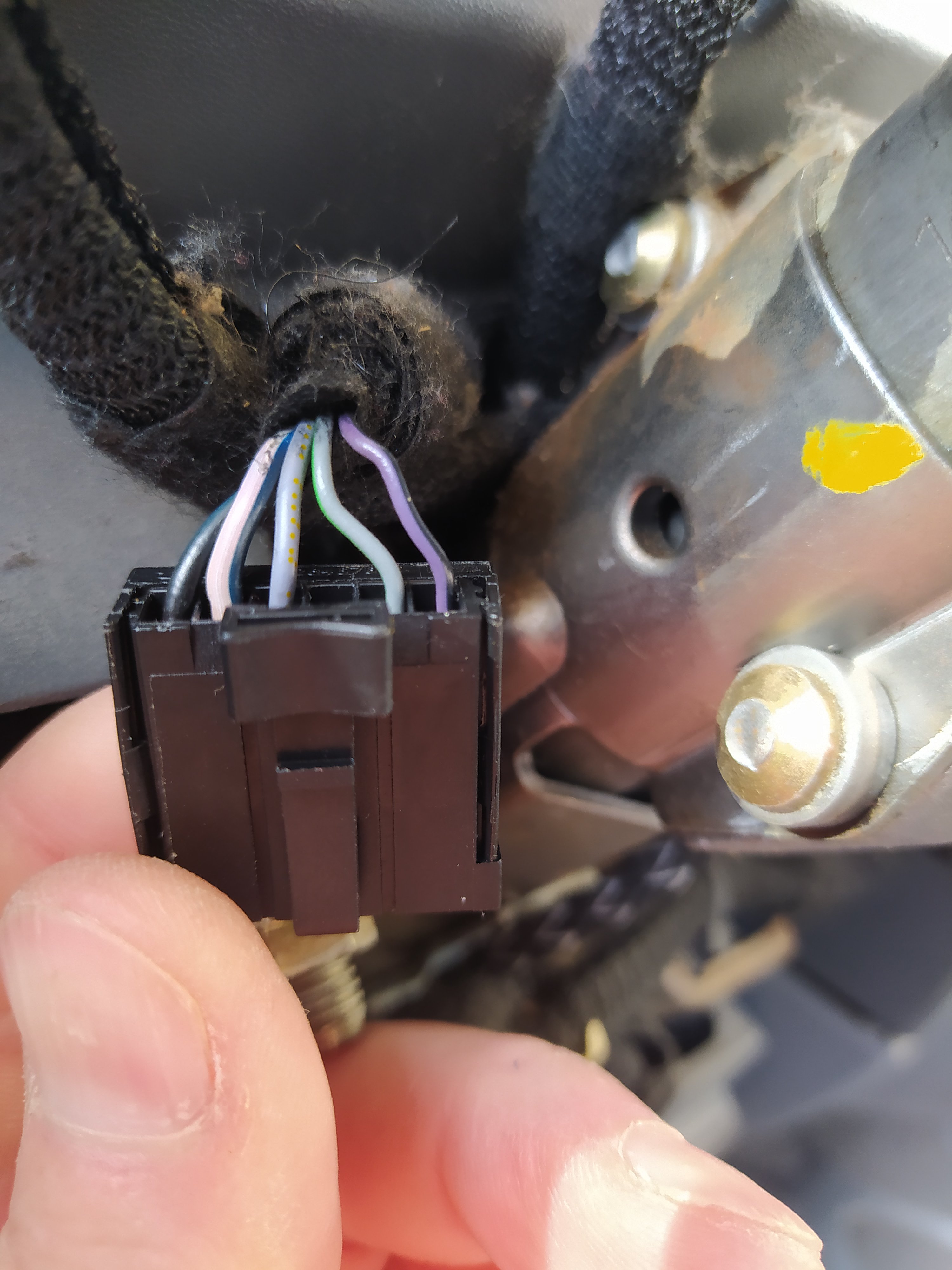

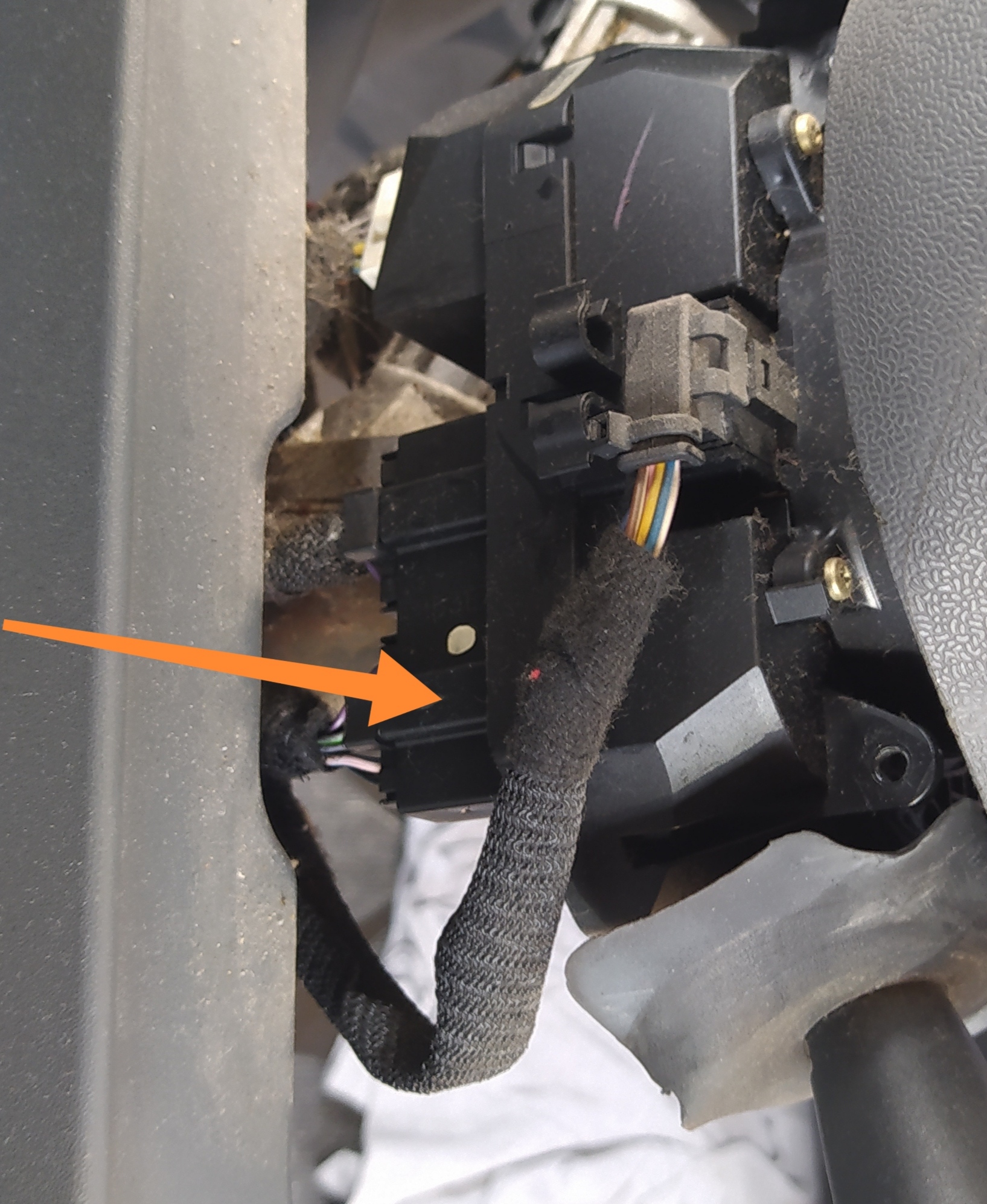

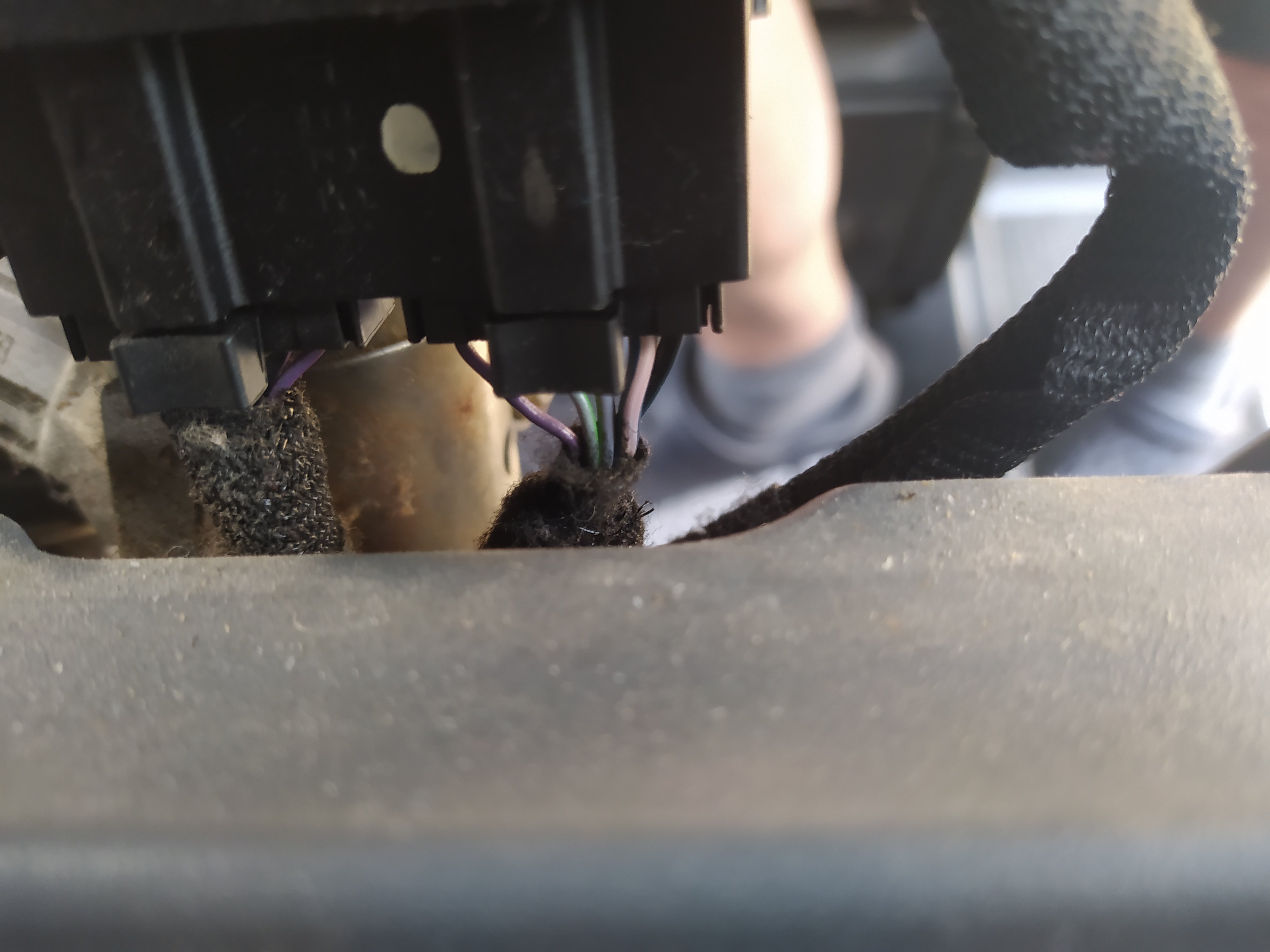

Then I thought it was something to do with the steering wheel stalk. Took the covers off around the steering wheel.
Noticed if I shook or moved the wires on the connection (arrowed in picture) the dipped light would come on.
I did take the connector apart and the black wire connector is discoloured.
So I got them working again and I left the covers off while driving and the connector gets so hot I can barely touch it. The back of the dipped lights/indicator stalk also get extremely hot.
I did a site search but didn't find this exact issue.
Can anybody give me advise to look further into the issue.
Taken with information given above, this suggests either faulty wiring or switch in the sidelight circuit. You mention that the vehicle is a motorhome and also mention side marker lights. If additional side marker lights have been supplied directly from the sidelight circuit and not via a relay, this will exacerbate any high reistance problem.
For explanation, the heating effect of an electric current is proportional to the square of the current. So double the current, and you have 4 times the heat. Think how many additional 5W marker bulbs you have. Including number plate, the original compliment would be 6.
To illuminate the dipped beams, the switch control panel (attached behind the four push buttons in the centre of the dash) needs to receive 12V via the instrument panel illumination fuse, F24, in the LH cab fuse panel. If this supply is not present, no dipped beams.
So it could all be due to a failing, and perhaps overloaded sidelight switch contact, or hopefully connection to the switch.

Just had my mechanic look at it (van happens to be currently in for a different job)and he said the steering wheel switch unit needs replacing.
If the problem was on my vehicle, I would be looking at exonerating the connector before changing the switch assembly. The fact that the dipped beams came on when the wiring was moved suggests a possible problem with connector "B" poles 5&6.
